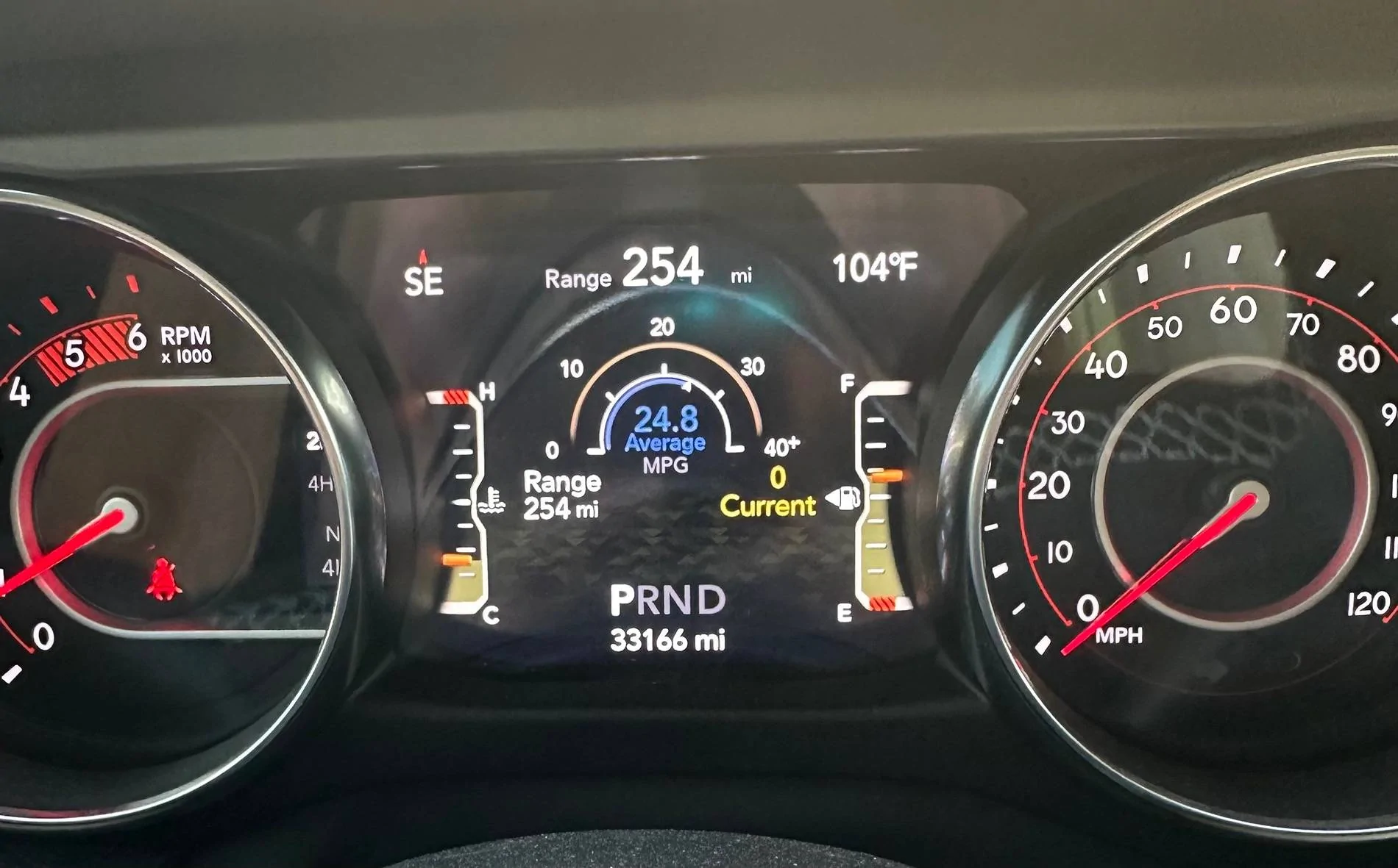

Finally got my recall done at 33,000 miles. So far so good, no drop in MPG noticed. 2022 Rubicon

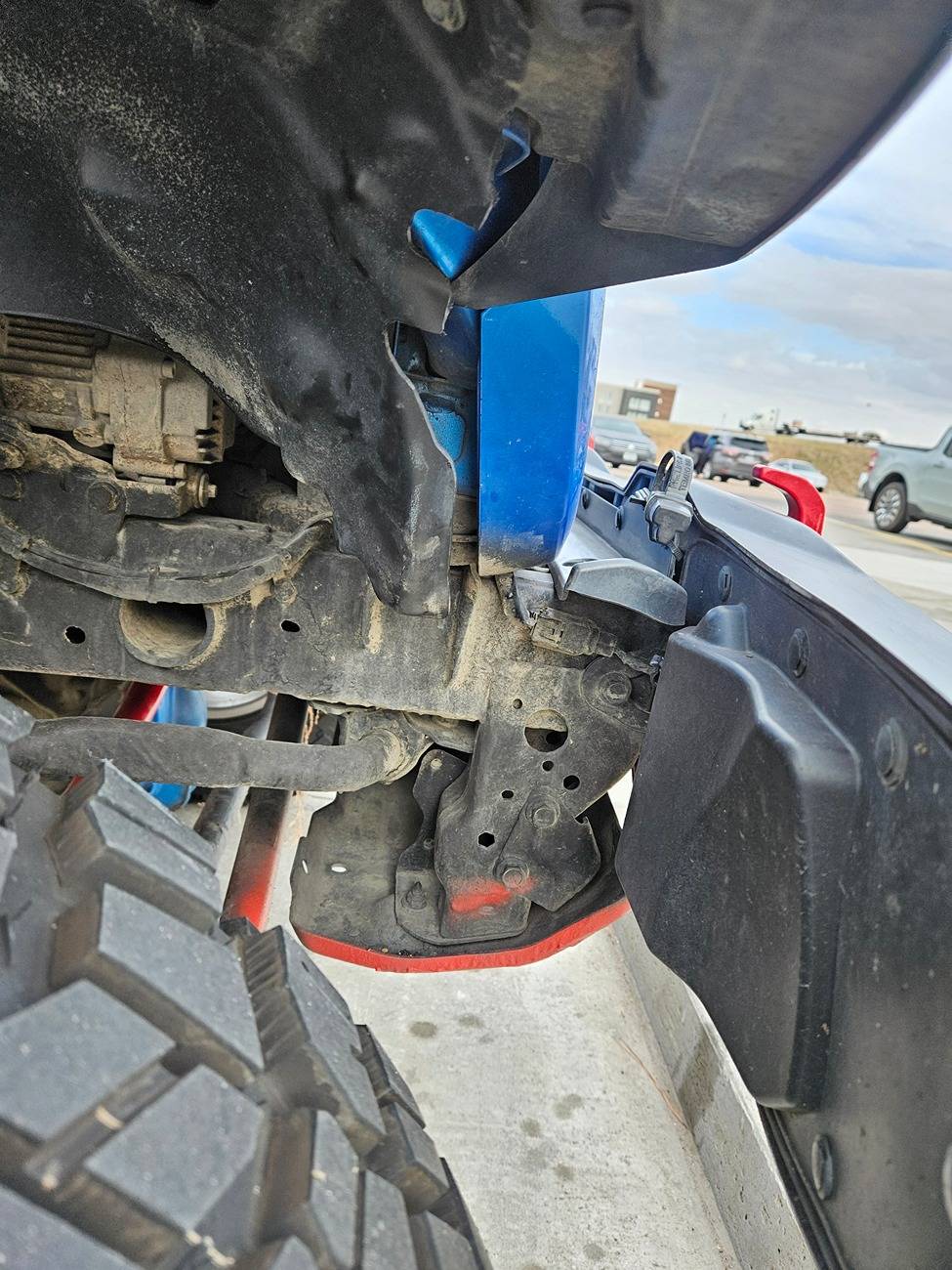

Traveling today. On a trip from south of Pittsburgh to Denver for MIL funeral service. Fuel mileage from home to KC was 24 mpg. 70 mph speed limit. Today from KC to Denver, 14.4 mpg. Speed limit was 75 mph. Had a 50 mph headwind all the way to Limon Co. The trany never seen 8th gear until Limon. The wind was so bad, that going down hill. The trany stayed in 7th trying to maintain 75 mph. The wind even ripped the right front inner fender liner at the front. Had to hold the steering wheel about 30 degrees to the left to go straight. Never figure I would see this kind of fuel mileage.

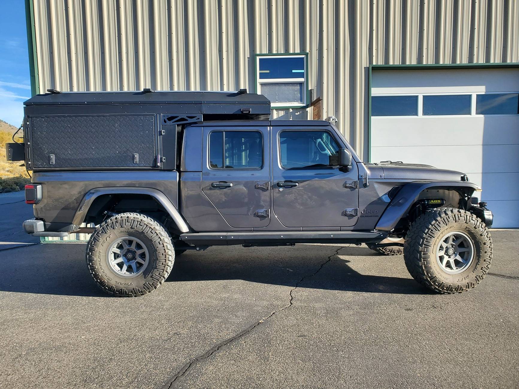

I've ran 2 tanks full of fuel since I did the new pump..no change at all, stock gears, 38's well over 7klbs. Get between 19 and 20 and live at 5k'
