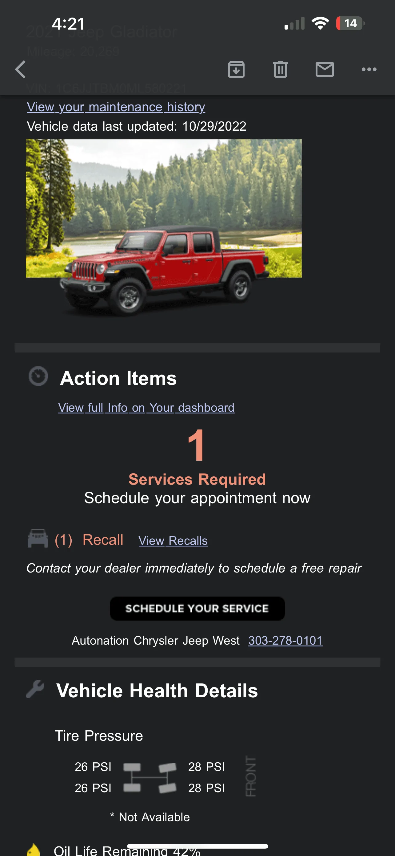

Just got an email from Mopar about my 2021 JTRD 3.0 being recalled for the CP4!!!
Says parts not available and the links in the email don’t work!
pretty sure it’s legit though!!!!!

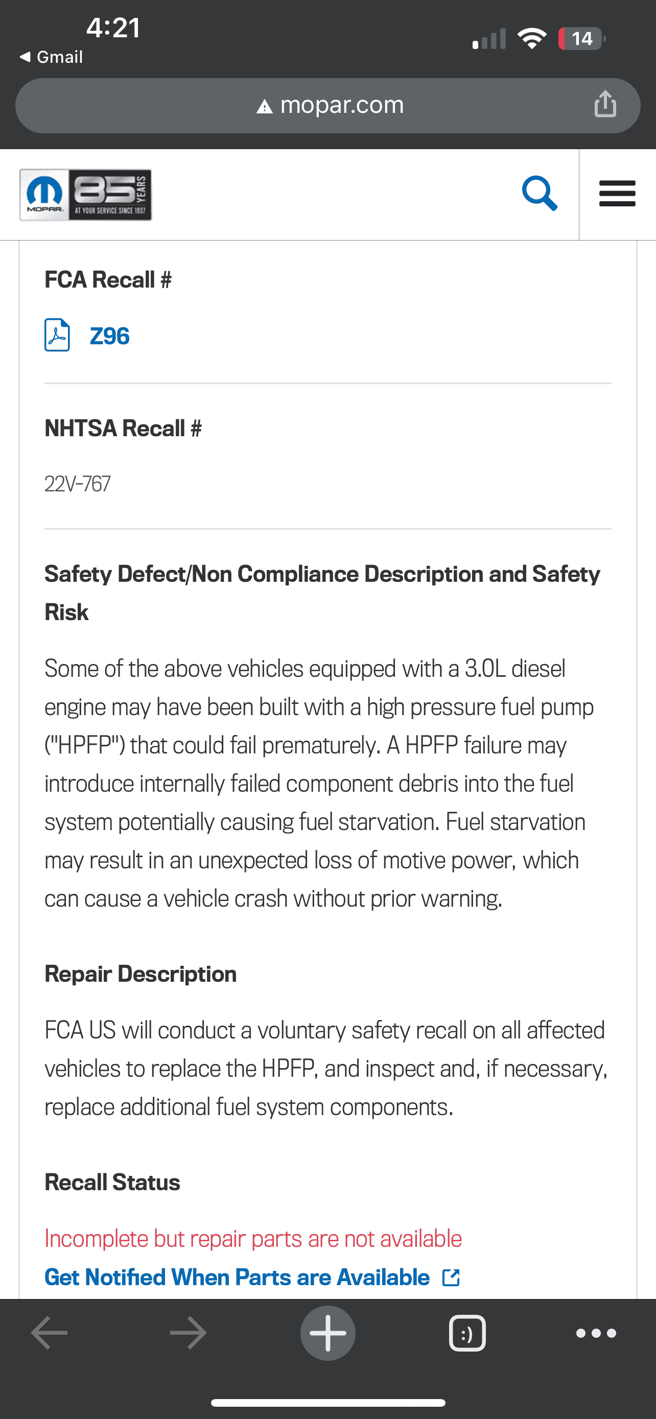

The part I like about this. It puts an end to what to expect. Under Repair Description. It says that FCA US will replace the fuel pump and any other fuel systems components.
