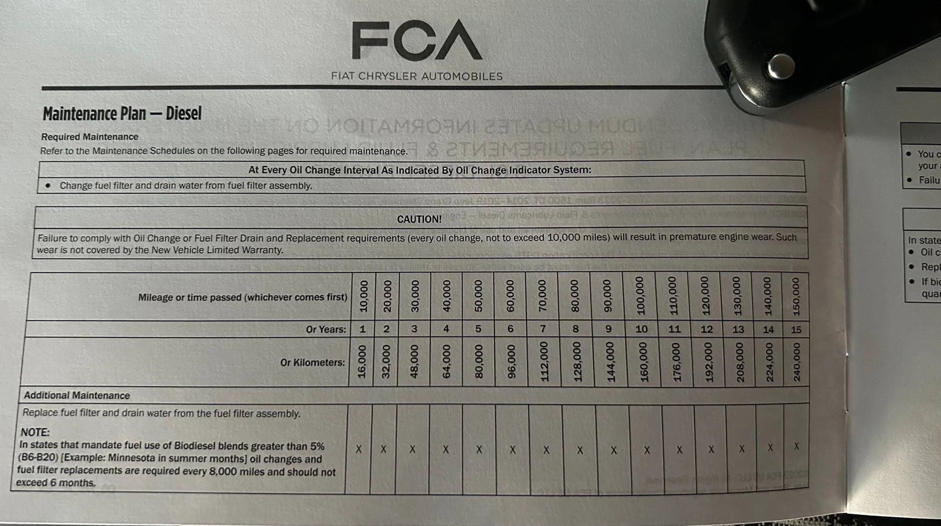

Oddly there was no mention of revised service protocols or a print out of the revised protocols. Some have reported as part of this campaign they now require you to change your fuel filter at every oil change interval and restrict bio fuels.

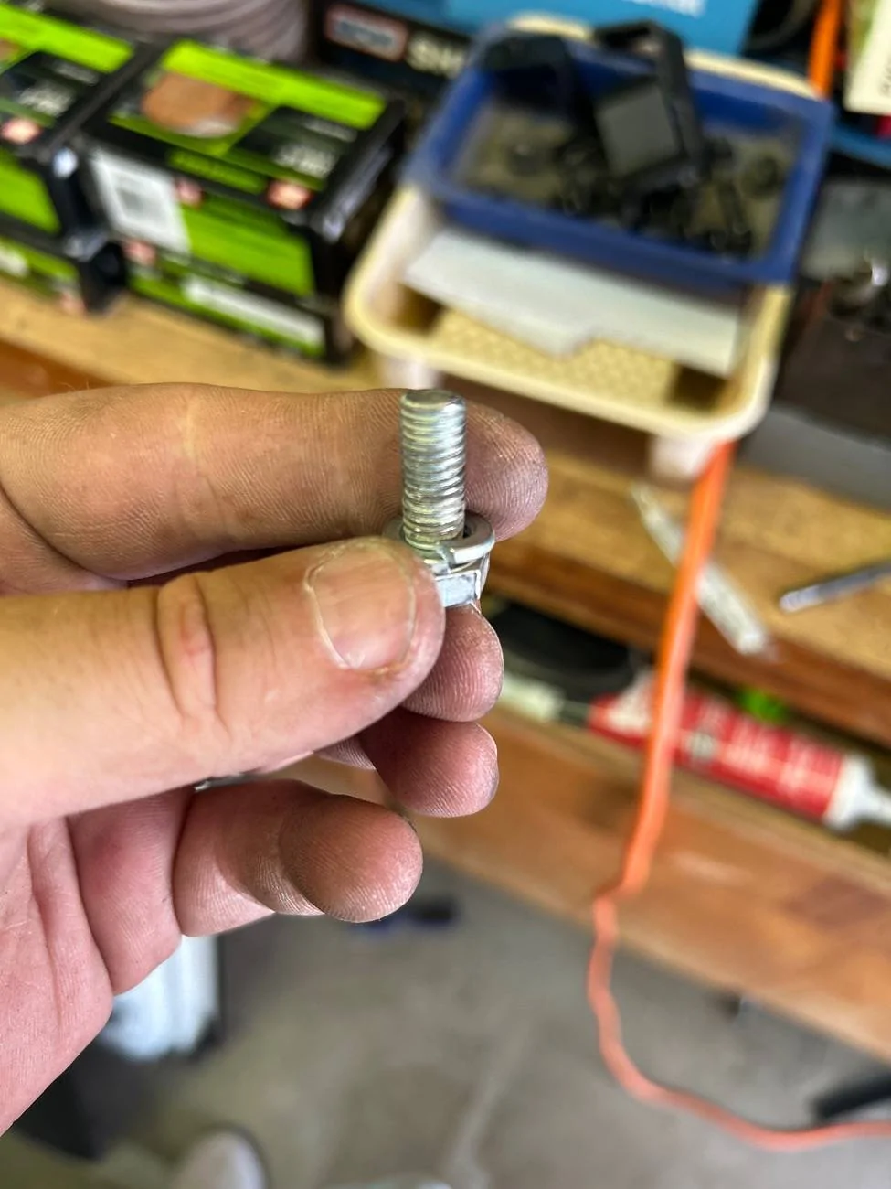

Naturally, my service writer was at lunch when my vehicle came out. Almost like it was planned that way. Paperwork shows nothing about new fuel filter. Again, mine was not mopar branded, so I’ll know for sure next time. In the meantime I’m gonna keep cussing at this bolt I snapped in half trying to put my skid plates back on. The other half is still in the hole 🤬

Here’s the rundown of the modified owner’s manual they left on my seat.
Jeep Gladiator CP4 Fuel Pump EcoDiesel Recall IMG_7238

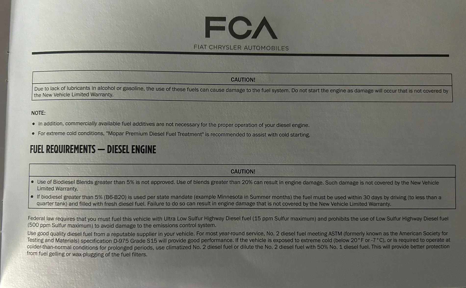

Notice this specifically says NO aftermarket additives are necessary for the new pump.
Jeep Gladiator CP4 Fuel Pump EcoDiesel Recall IMG_7240

Anyone know what's changed inside the pump yet? I got mine done finally (by the original dealer even, parts supply has clearly increased) and I REAAAALLLY don't want to put additive in my fuel anymore if I don't have to (and at least 2x that sentiment from my spouse). But until I know it's safe I'll continue.

Does anyone know if the fuel filter change is part of the 2 ā€œfreeā€ scheduled maintenances that you get when you purchased new? Having first oil and filter changed next week and I’d like to know before I go into the service department.
thanks

@Tom C
Nope, fuel filter is not included in the free oil changes despite the fact it's now required every oil change.

@Tom C
Took my Gladiator in for its first service. The dealership didn’t charge me for the fuel filter replacement and said it was covered by Jeep Wave. I wasn’t going to argue.
