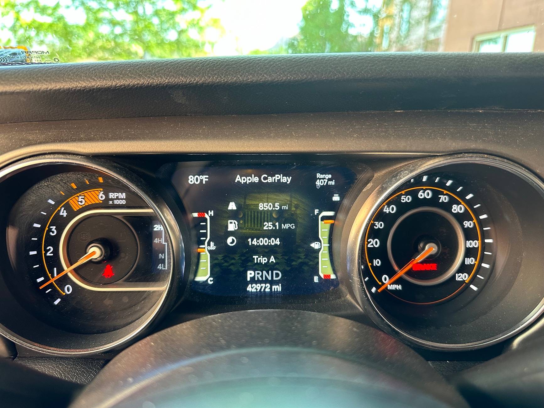

I dont track it every tank anymore but its been +- .75 nearly every time I have.
This is post recall on 39s pulling into moab from san diego through az
Jeep Gladiator Bad mileage after fuel pump recall? IMG_5439
