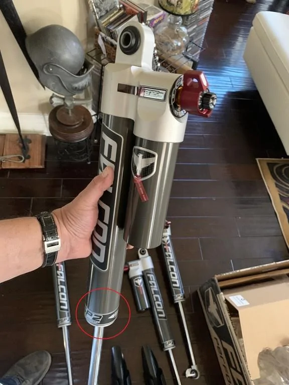

According to the directions I have on my box, SP2 adjustments are separate from the top fast adjust and can only be done when the bottom of the shock is disconnected and fully extended. SP2 is adjusted to soft by turning the shaft 360 degrees counterclockwise and SP2 is adjusted to performance by turning the shaft 360 degrees clockwise. Then, the top adjustments are there to "fine tune" the soft mode or the performance mode. I have one of the shocks in my hand right now, but, I do not know how to tell what the default setting is for SP2. The directions say to just turn it one way or the other, depending on what you want, but, it does not say what the default setting is.... There are also some graphics on the bottom of the shock cylinder next to the "SP2" logo that describe the procedure. I have circled the directions for the "SP2" adjustment at the bottom of the shock in this pic below.
Based on what I have read, I have no experience yet, a light JT with light 35s or 37s can benefit more from the soft mode; and a fully loaded Overlanding JT with beadlocks and 40s may like the performance mode better as the default setting.

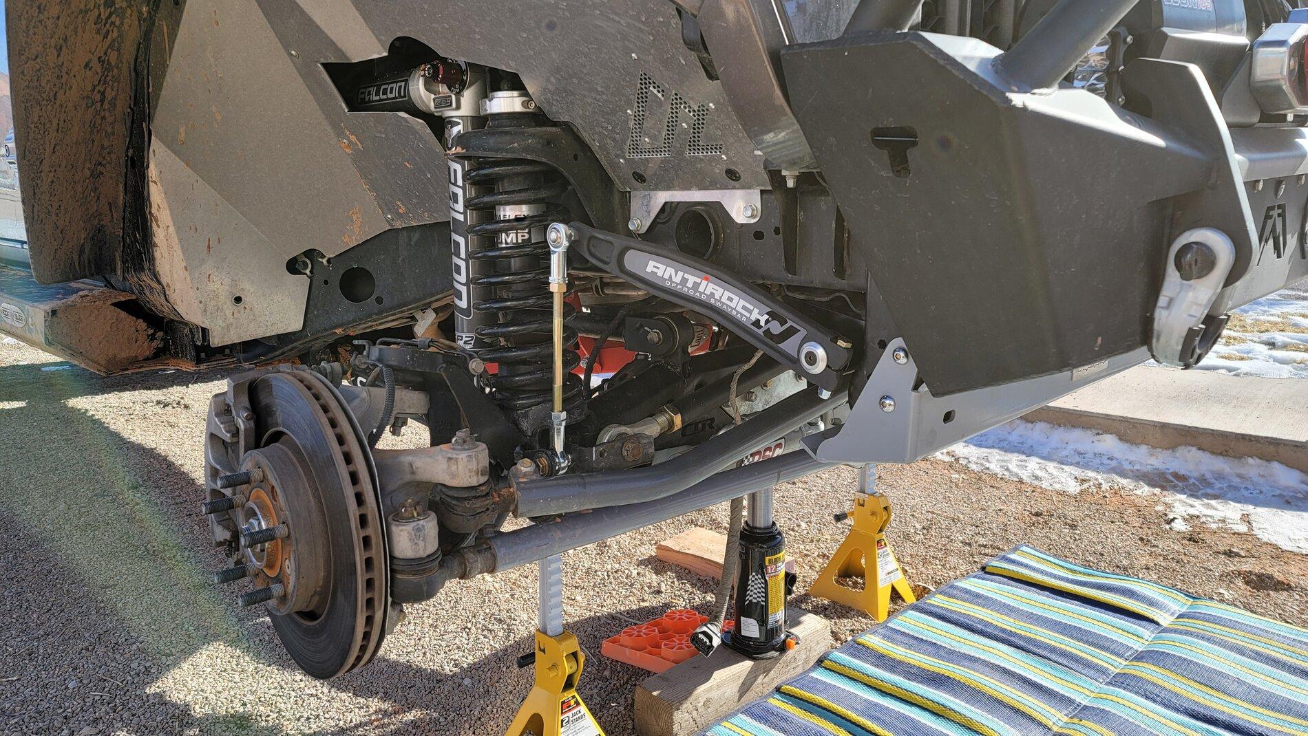

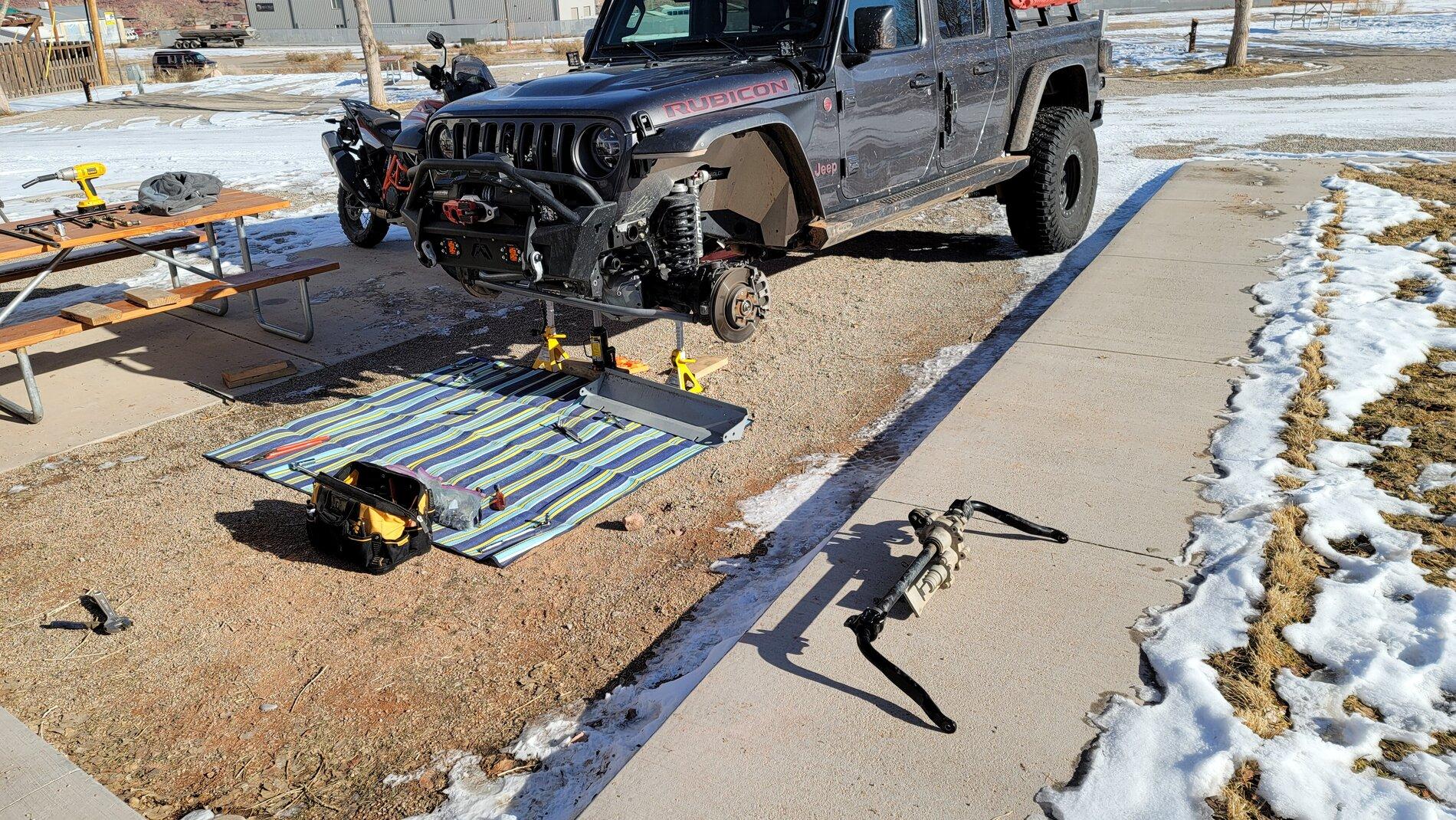

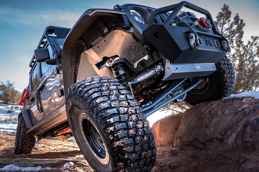

Got the front Antirocks on yesterday and had a chance to flex them out just a little. So far it doesn't seem like I've lost any articulation at all (this image isn't all the way there) and it seems to ride great!! The rear antirocks will go on Monday just in time for the Winter 4x4 Jamboree!:) Full review once they are both on and I get some seat time at Sand Hollow.

Props for driveway wrenching in the snow! You wouldn't catch me laying on the frozen ground at this point in my life; I'd wait for warmer weather to install new parts!

Haha, yeah, installing new stuff has been a pain for sure!! Worth it though!!

For what it's worth, the settings were temperature based (i.e., if it is below or greater than 40 F). I live in NC where we do have, well, seasons, but I *think* I adjusted the lower shaft to the "performance" setting. I have found that I can still soften the shocks substantially with the knob adjust, so it seems easier to have that compromise instead of dropping the shocks every winter/summer or load in the case you presented.
I have my shocks set at "2", but often wonder if the micro-adjust would serve me better...like a 1+ setting right now.
