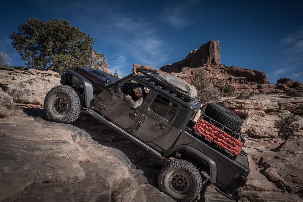

Dan,
Great rig and photos. I'm looking at the Frontrunner roof rack and yours is the only one I've seen online.
a few questions
1. how was the install?
2. wind noise ( I see you have wind-deflector)
3. What is your overall thoughts.
Thanks,
Hank
Overall I really like it. It's the only option I know of that you don't have to worry about at all running hard as it's to the frame. My last rig I was always thinking about my racks offroading and I hated it. This thing is not even a consideration. It's solid.
Install really sucks. It's honestly not hard, just a million steps. Drilling the hard top is of course nerve wracking, but their instructions are really good. I wouldn't not get it because of that. Just a pain.
Definitely some noise depending on what you have on it and if you have a lightbar. It does come with small fairings that go underneath, so you might not need a front fairing. It did help mine a ton and it's really decent now.. Overall I would say it's as good or better than the other racks I've had. Always some noise, but livable.
If you definitely need it go for it!!

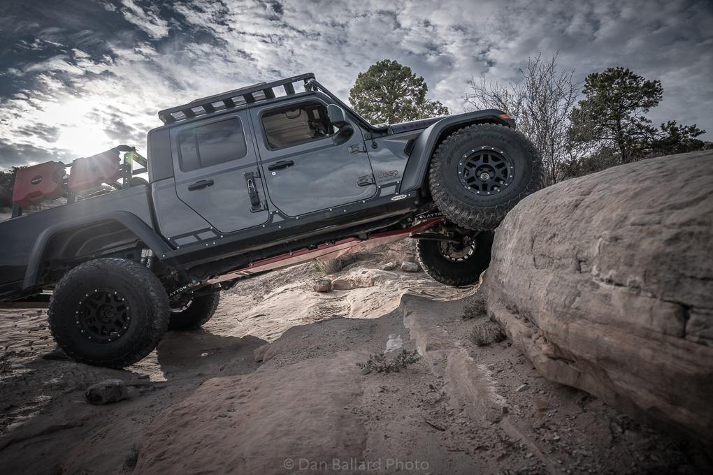

Well the PSC big bore cylinder assist steering kit for the Gladiator is an absolute game changer! One of the best mods you can do imo!
I was sort of getting by turning the 37's before, but with the 39's and beadlocks...no way. At 7psi on Moab rock even in 4wd without lockers, I literally couldn't turn without moving and really planning corners. Now, even locked up it's one finger. Almost zero effort. So nice! Feels like a different truck.
It's also awesome for high speed desert running type driving as well. You can hold a line much better and it just feels more confidence inspiring.
Not only does this add the ram (hydraulic cylinder that actually pushes/pulls on the tierod) but adds a new big bore steering box that is super beefy! No more worries at all about breaking a sector shaft! Plus adds a new pump and cooling system. It actually turns the electronic system into a hydraulic system.
It is a touch sensitive on the highway, but definitely much better then stock.
It does take some time (days) to blead and get the fittings tight... I had it installed as I don't have a shop or good place to work, and I'm glad I did. They had to modify a lot to make it work with my truss, tierod and fad skid.
Overall it's a get kit! Well worth the money!

Do redneck rams exist for the JT? Seems like that might be a preferable setup with the new cast iron boxes with a cooler?
I'm far from an expert on this, and can only pass on a little info I found from researching... and you probably know all this already, but for anyone else reading that might not...
It sounds like you can send your steering box in to them and they can port it for the hydraulics for the ram. You would just need to get the right length. But as far as I know they don't have a bigger pump or cooling system? Which some say you can get by without...but it's far from ideal. Also, while much of pressure would be taken off the sector shaft by the ram, you still have the small stock steering box with the small sector shaft. The PSC is massive. Huge difference.
I also considered just getting pieces of the PSC system which you can do, but when you break it down, it just wasn't that much different price wise.
In the end it just seemed like going with the full PSC kit was just the only solid option even though it's pricey.
