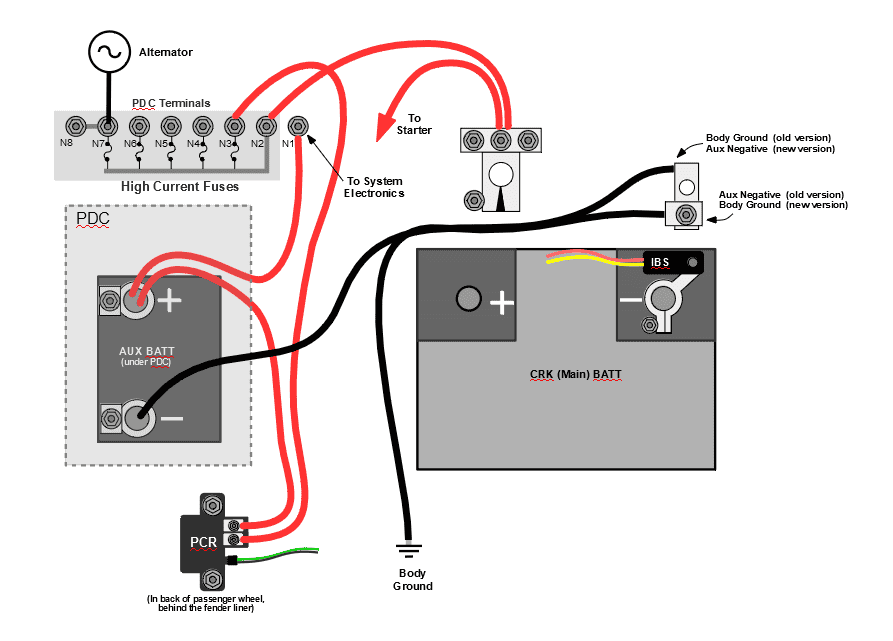

Be aware that the negative cables were changed at some point. At the negative battery terminal, what used to be the aux battery cable is now the body ground cable. Disconnecting that cable used to just disconnect the aux battery, now it disconnects both.
So what would happen if a guy eliminated the Aux negative cable entirely, and then transferred the Aux positive wires over to Main positive? So, N1 and N2 (and maybe N3) are all going to Main battery positive?
Would that successfully remove the Aux battery from the equation, or would the PCM blow the whistle and call a 10 yard penalty on the offense?
That's probably the most common way people eliminate the aux battery. That's how the Genesis dual battery system eliminates the small aux battery - moving the aux battery positive cables to the main battery.
This thread discusses leaving the aux in place as an emergency spare. https://www.jlwranglerforums.com/forum/threads/ess-dual-battery-management.60034/
That's what I'm thinking. So does N3 need to be in the equation? Send it to main positive also, right?

If the Genesis kit was the fix for yours, it could still have been a bad N3 fuse or a bad ESS relay (PCR). The Genesis kit bypasses those. What was the fix for the other vehicles?
Here's a diagram that show's the battery connections. The main battery is connected to the aux battery and system electronics through the PCR and N3 high capacity fuse. As long as that circuit and ground cables are intact, the batteries are in parallel and will maintain the same voltage.
