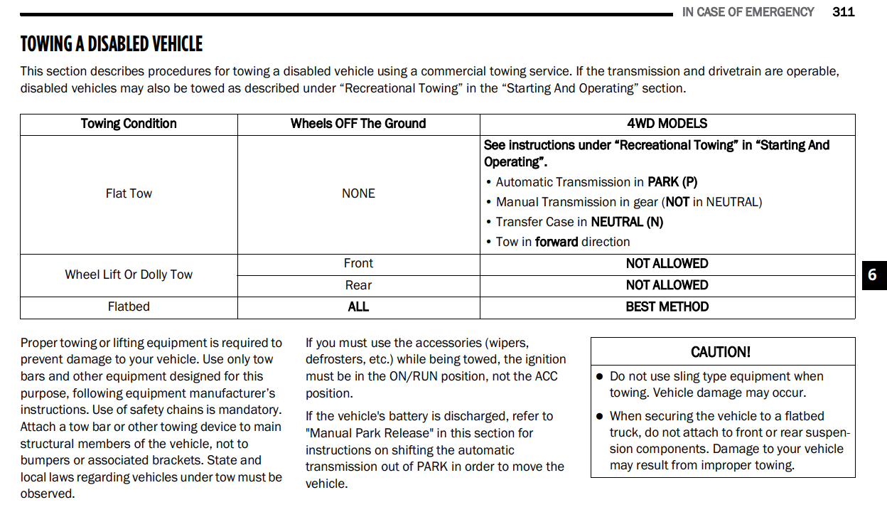

Awd vehicle need a flat bed or set of rear dollies to be completely off the ground. Jeep doesn’t because you can put the transfer case in neutral
They must be flat towed or on a flatbed. They can't be towed with just front or just rears lifted.
Jeep Gladiator Dead Gladiator towing3
For insurance purposes, many companies will NOT haul people or allow them in their vehicles. I used to work for a shop that did towing. It's a liability thing in SOME cases.
Could be other reasons.
