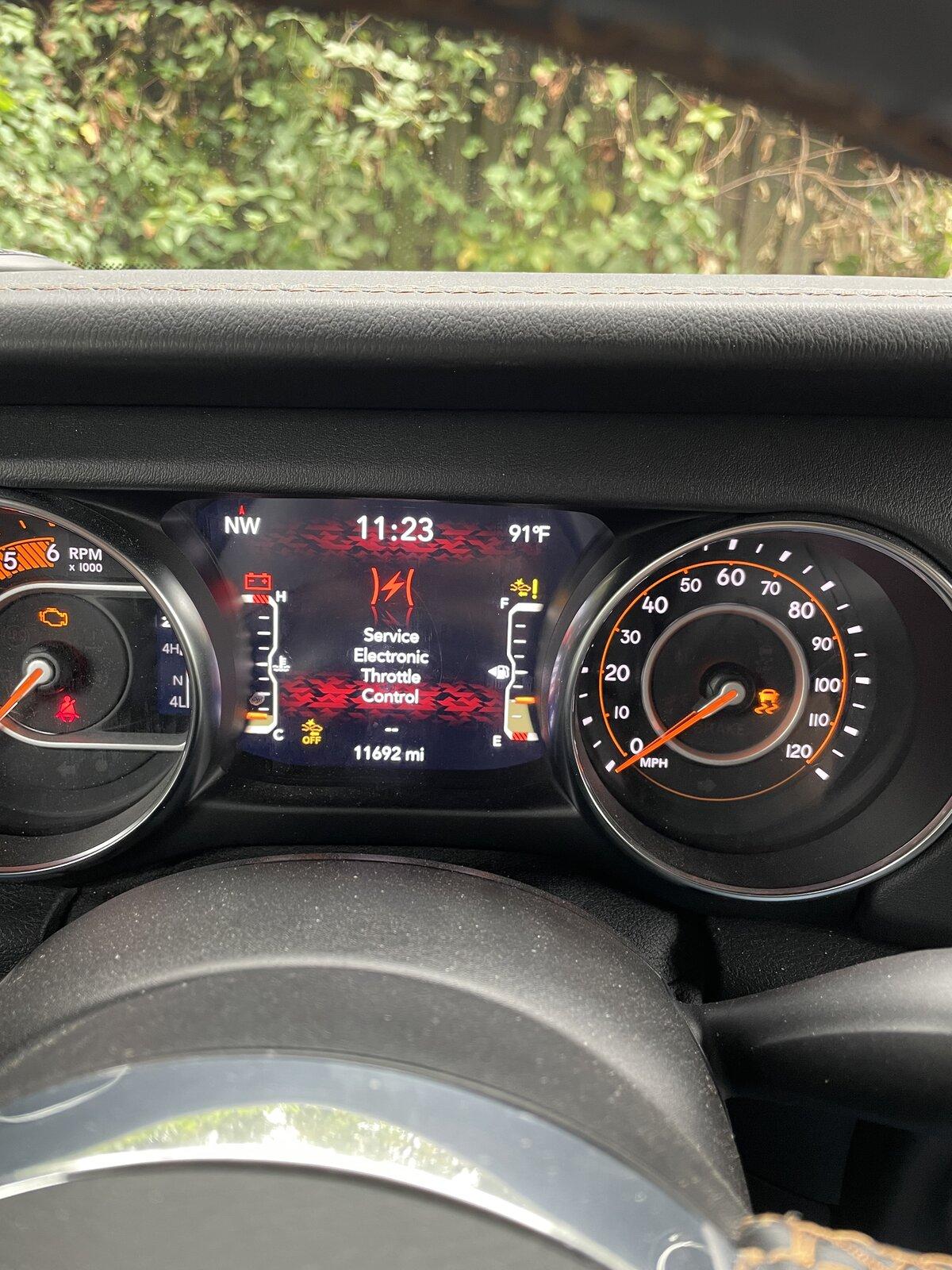

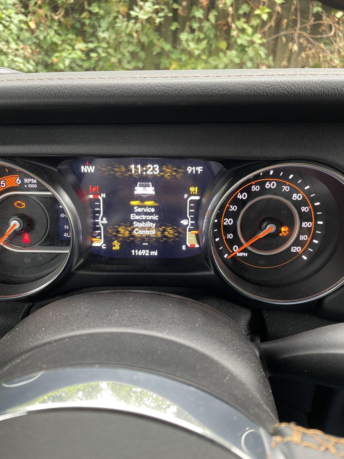

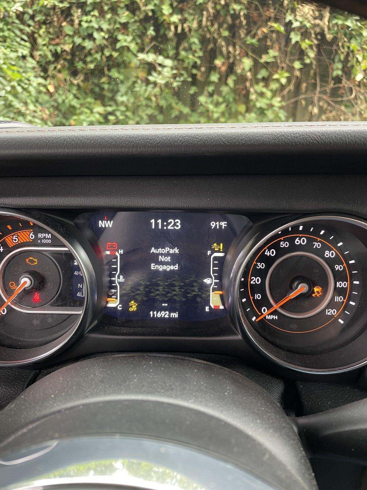

Guess what happened again today…?at least it was only a few miles from a dealership where I bought an extra auxiliary battery to take back to my dealer. I thought I’d have longer than a week to come up with an emergency solution, but such is life. Let me add that the second dealer told me this is a problem across multiple models and, for now, I’ll always have an extra battery so I don’t get stranded in another state(Virginia this time) again

Round 3…. Maybe @JeepCares will get it right the 3rd time back to the dealer

Are they replacing BOTH batteries each time? As was mentioned earlier, because they are not truly isolated, when one goes bad, it usually takes the other one with it.
