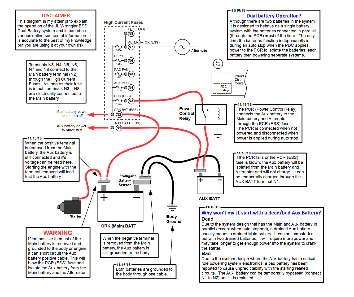

On the surface I agree with you but I think they had their technical reasons since they made the alternator charge path go through a fuse distribution panel first before going to the batteries. with the aux battery relayed controlled when it use.
Below is a diagram from the JL forums with the same setup. It is a mess.

Is the whole purpose of the aux battery to prevent voltage sag to the cars electronics when the starter is engaged, drawing down the voltage on the main battery?
What is PDC in your diagram above??
