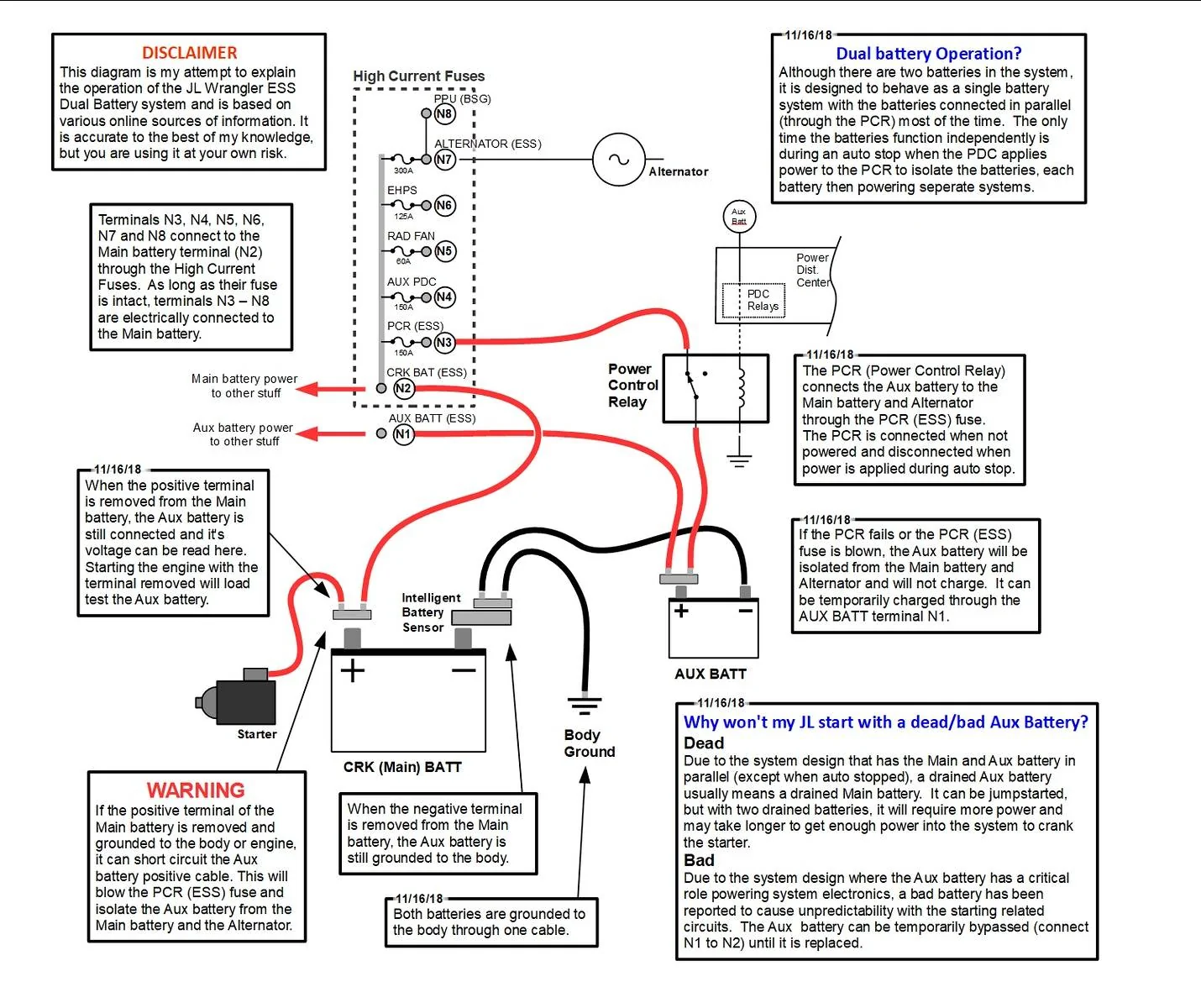

I'm late to the Jeep game and have a minimum amount of experience with the start/stop system. In fact, my best skill might be internet research. :) There are a number of members here who have invested a lot of time and study on the Jeep battery system, and then they freely and frequently shared their knowledge. One of them made the drawing below. I haven't seen things explained any better than on this drawing (I think Bill is the author).
When my Jeep was in warranty, and the stop/start-charging light came on, I went to the dealer. Three visits later they replaced my main battery. I wasn't happy. I wanted 2 new batteries. I fully expected the problem to come back. It has not. In the meantime, my original factory warranty expired. Since my main battery was new, and my aux battery was old, I thought it made perfect sense to disconnect the aux battery. In felt like there was a strong chance that the old aux battery would go bad sometime in the near future and damage to newer main battery.
I drive my Jeep weekly. I turn off the stop/start as soon as I think about it - normally when it operates the first time. :) I don't believe I need 2 batteries.

The batteries in our JTs are wired in parallel, i.e., hooked together. The only time they are separated is during a stop/start event. Naturally, when one battery begins to lose power, it effects the other battery. There doesn't seem to be pattern regarding which battery dies first. I'm sure it depends on usage. In my truck, the main was the bad battery. Complicating this issue is that the stop/start system seems to quit working at 12.4 volts. 12.4 isn't a bad reading for a 2+ year old battery.
I have a 2020 JLU as well as a 2020 JT. When my new car warranty was over on the JLU, I disconnected the aux battery (removed the negative lead, insulated the end of the lead, secured the end with cable ties, removed fuse F42). The stop/start still works as designed, it is just working on one battery.

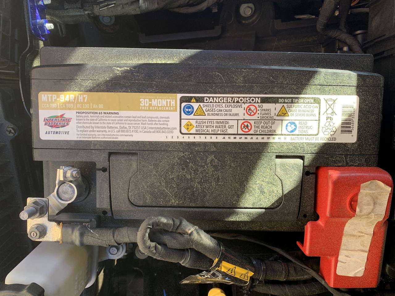

Sometimes you write something and then you have second thoughts. Late last night I decided I should try to verify my good feelings about the new battery my dealer installed in my Jeep.
Jeep Gladiator Dealer appointment for stop/start i-84VRVN3-X2
My battery is not the best group 94 battery that Interstate makes. The MTP-94R/H7 battery rates 790 Cold Cranking Amps and 130 minutes of reserve capacity. The Interstate MTX-94/H7 has 850 Cold Cranking Amps and 140 minutes of reserve capacity - roughly 8% "stronger/better.
The next battery size up from the group 94/H7 batteries would be group 49/H6. These batteries are 1-1/2" longer. I have not verified the fit on my Gladiator. Premium group 49 batteries generally are rated at 900 Cold Cranking Amps and 160 minutes of reserve capacity (a 13% improvement over my current battery).
I referenced this article for info:
Best Group 94R/H7 Batteries 2022 [Review & Buyer's Guide] - Battery Globe
