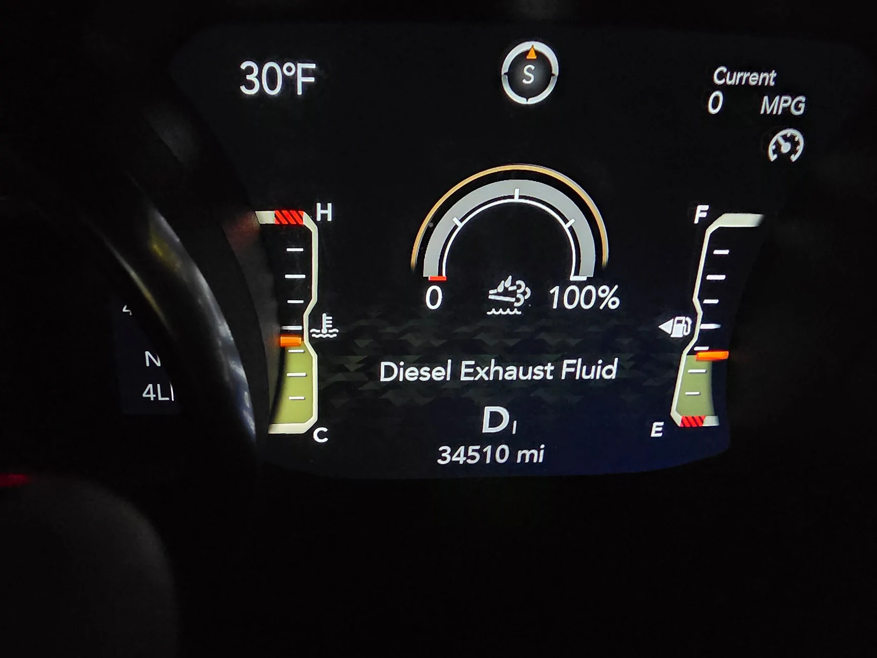

So I bought a 2021 ecodiesel gladiator (Sarge Green Rubicon, 34k miles) about a month ago. The dealer said I get a full tank of diesel and def when I got it, so of course I checked before I drove off the lot.
I've put about 1k miles of it so far and I've been checking the def gage every day trying to gage when id have to fill that up. It's still at 100%.
I just thought that 1k miles may not be using that much def yet since most of my driving is highway, or they just overfilled the tank. But I think it would have dropped at least 1% by now...
Was reading that the tank does take a while to register sometimes, but most people are saying this when its low and they fill it. Also read that the sensor and tank is all 1 piece so its a full replace not small fix.
Should i be worried? Get a service appointment before the 36k? I do have extended warranty just in case.

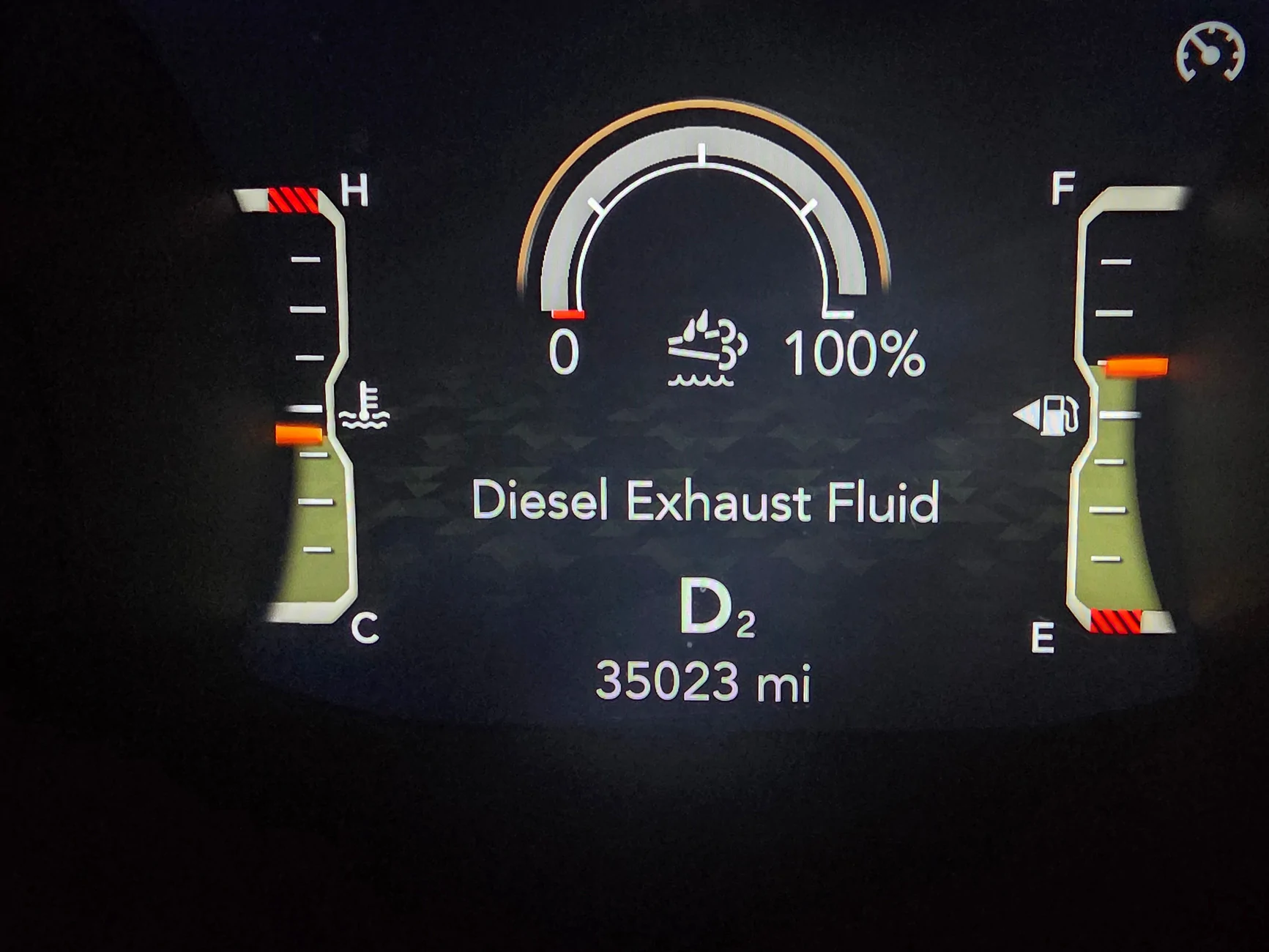

Edit: added a pic of the gauge from about 500 miles ago. Same look today, all of the other gauges show the gray bar at the actual level, I assume this is full do to completely gray.
Edit #2: ok, driving home from work I checked the gauge again, right as I turned away from the screen I noticed it was just slightly below the full. I bet they did overfill the tank. I just assumed it would have a % like the oil life gauge. I was wrong.

You have a photo of the gauge? Some mistake the 100% full display for the level.

The gauge will always say 100% on the right side of it. You have to look at the semi circular bar graph to see the level. Mine takes about 500 miles before the bar graph starts to move.

Your good just look at the bar graph like Rusty PW said. I'm getting beyond 2,500 miles on a full tank using pure Def.
I just flipped to that screen while driving and quickly checked, and went back to the speedo. My fault.
I just knew it was using the def cause I could smell it, just was worried the sensor wasn't working and sense it still was under the 36k warranty I wanted to get to the bottom of it quick.
