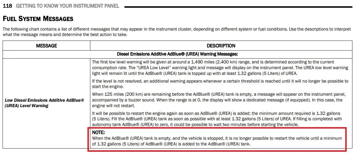

I’m at 5400 miles and my vehicle is threatening not to start in 95 miles … I’m gonna see how serious it is about this. Did the government really create a scenario where a stupid emissions system can leave us stranded ??? What if someone cracks a tank, or a sensor goes bad???
I have 5 gallons in the bed ready to fill it back up.
Did they really create a scenario where the emissions system can leave you stranded? You bet.
