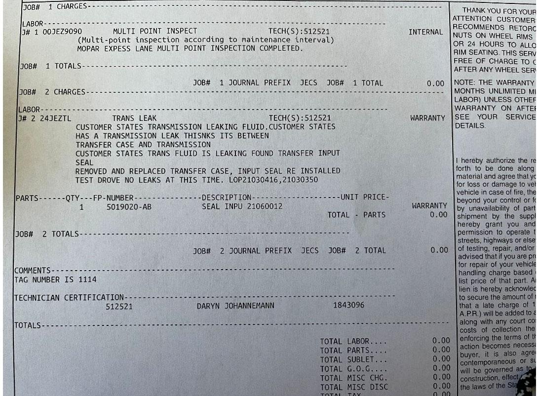

ok, so I just went and got my truck back....looks like they did a good job.
They said there was a nick in the input oil ring seal on the transfer case. Here's a copy of the repair order.

Glad it was warranty, nothing like 1k+ in labor for 10 dollar seal........

Had the same leak at 3600 miles. They took care of it...

Mine has had the same leak however not as bad since I noticed about 3000 miles and I'm at 16,000. Guess I need to decide whether to let the dealer hacks work on it or just fix it myself......
