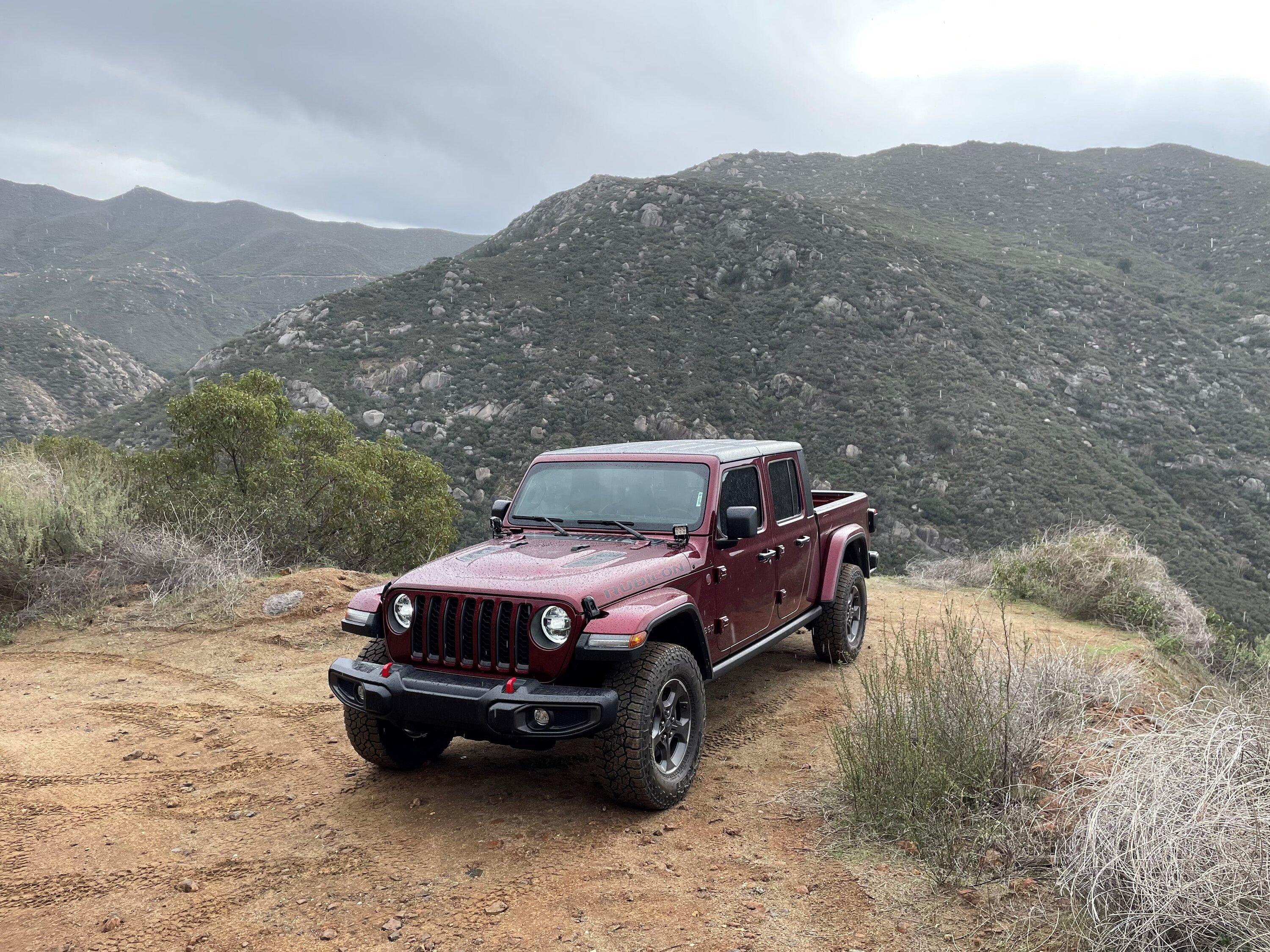

Leave it stock, run the tires it came with till they are ready to replace and then get a nice A/T tire. Lots of people like the BFG a/t, The Toyota dealer always put Kumho A/T. The Wild Peak are nice in my opinion. I see Rubicon take off rims and tires for very cheap. Like $500. Low miles and are stock tires so should work great and get out of the touring style rims. either way a nice set of rubber will go along way. Discount tire will sell you a road hazard plan for any tire. You don't even need to have purchased the tires form them. Flat repair or replacement if needed. I would recommend some nice add on lighting to the A-piler something that lights up the side of the road a little better at night. That will make Night adventures on service roads nice. I got mine on amazon. I think maybe $50 all in for brackets, lights and harness. The lights are small there are brighter ones but these really help light up the sides of the trail nicely. I used them at night to help spot Elk on the roadsides too. Just adds a wider field of view than just high beams.
