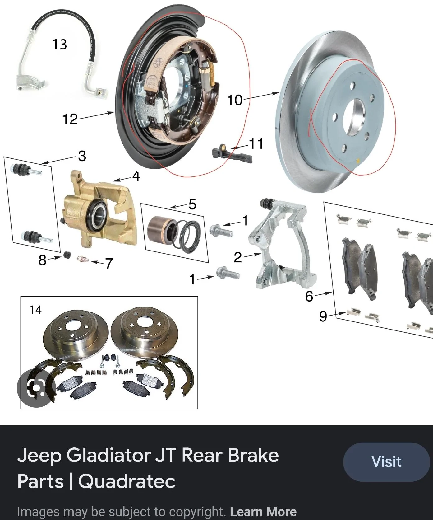

It does? On which wheel?
Both rears have a drum in disk parking brake. If you get underneath and look inside the rear wheels you will see a steel cable that enters the inboard side of the disc backing plate. The cable engages the drum. It is a relatively common design, subaru uses the same setup. I like it because conceptually there is a redundant system if say your brake hydraulics failed or overheated.
