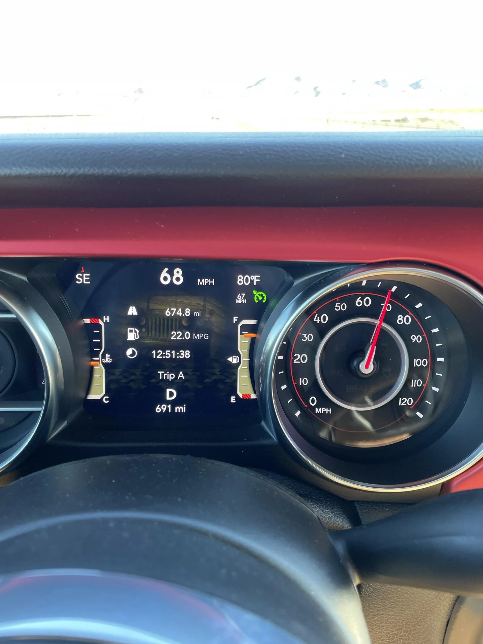

Stock gearing 39” KM3s CA to NM & back
Mine with stock 3.73’s and 35’s wouldn’t get that mileage. I averaged 20-21 on the highway, same as I do with 4.56’s and 35’s.

Run from Austin to W TX. Flat road, zero wind, cruise set at 75.
This is with 4.56’s and Yokohama 35’s. Gearing calculator I used was dead on for speed/rpm with 4.56’s. Everything is properly adjusted for gearing, tire size, and shift points with my Tazer.
What tires psi are you running? Your mpg appears kinda low.
35” Yokohama G003’s at 30 psi on 17” Warn Moonsaults
Same mileage I got with 3.73s. I do have a winch/bumper, Fab Fours rocker protection, Roll n Lock tonneau, and carry quite a few tools. Banks Derringer set on 4.

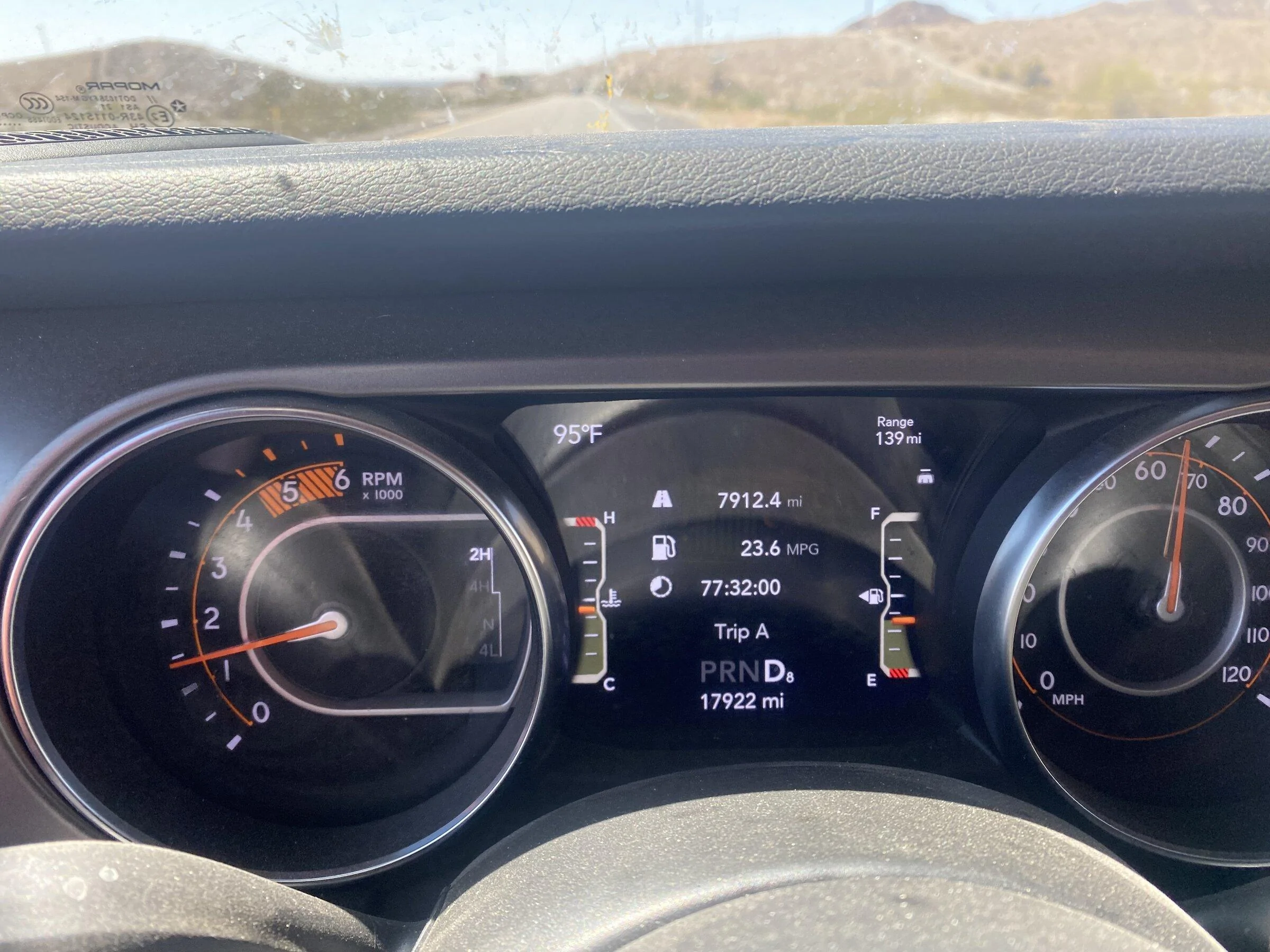

I’ll chime in, on 37’s there is no need for gears. If you think so, you haven’t driven a diesel on 37’s.
Here is my drive home from Idaho back to Vegas in October when I picked her up with 37’s. I now average 19 in mostly city driving and can still pull my 3800lb boat uphill with cruise on 70 on the steepest hills in the vegas valley without busting a sweat. I doubt 4.10’s would really give you a better bang for your buck.
Here is my drive home from Idaho back to Vegas in October when I picked her up with 37’s. I now average 19 in mostly city driving and can still pull my 3500lb boat uphill with cruise on 70 on the steepest hills in the vegas valley without busting a sweat. I doubt 4.10’s would really give you a better bang for your buck.

I’ve chimed in on this previously. I’d say you haven’t had enough time behind the wheel. I was under the same impression. Then stubbornly was like oh a tube will just make up the difference. Although the tune greatly helped and is manageable. You honestly need regearing, not that it isn’t something one can get away with putting off or dealing with the downfalls. So much left untapped here in the powerband that a proper 4.56 would greatly improve.
You think an ecodiesel JT needs 4.56 gears to run 37's correctly? :LOL:
This silly argument might just break the internet.
I've got over 10,000 miles on the clock, about 3,000 towing and plenty of 4L time - it is fine. 4Lo is almost unusable at this point - only for the steepest and the slowest of crawling.
Edit: I'm not arguing that it wouldn't 'help' - I'm arguing that the money, time and effort would be for a negligible gain and likely even a hit on MPG.

Gearing debates are literally the thing that might break the internet :) . Mine is a diesel and I feel the opposite. I want the truck to shift effortlessly and not run around under load at 12-1300 RPM hoping it shifts down. With the hills here in the Seattle area it is a stark difference stock to 37's. Even on a diesel.
I don't know, I've driven this thing everywhere. Towed my boat to Texas and back from Las Vegas. I've been to Idaho and back, long steep hills everywhere I go. Not a damn complaint.
