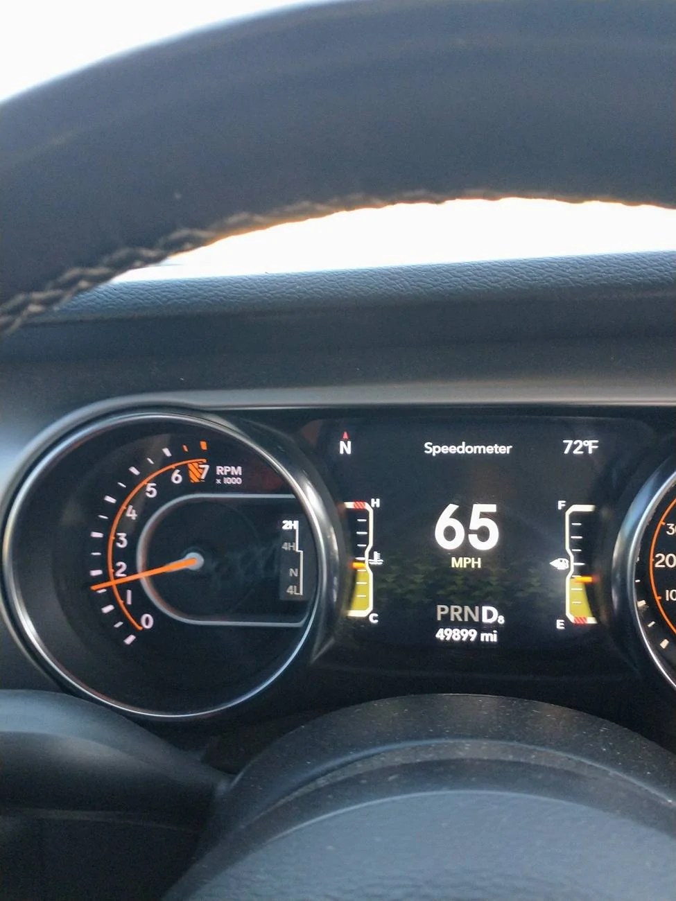

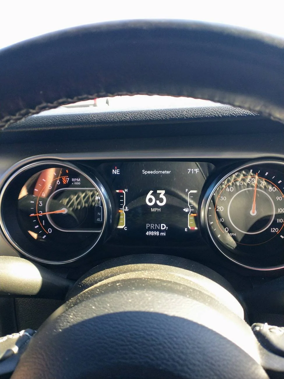

Checked it on the way in. 7th gear on 90% of the commute in this morning. Even hit 8th on a slight downhill on the way.
I'm averaging a combined 17 mpg
That's awesome. I stand corrected and that definitely wasn't my case on 35's and figured it would be worse on 37s but it appears it seems to be the opposite. I wouldn't worry about regearing if that is the case.
