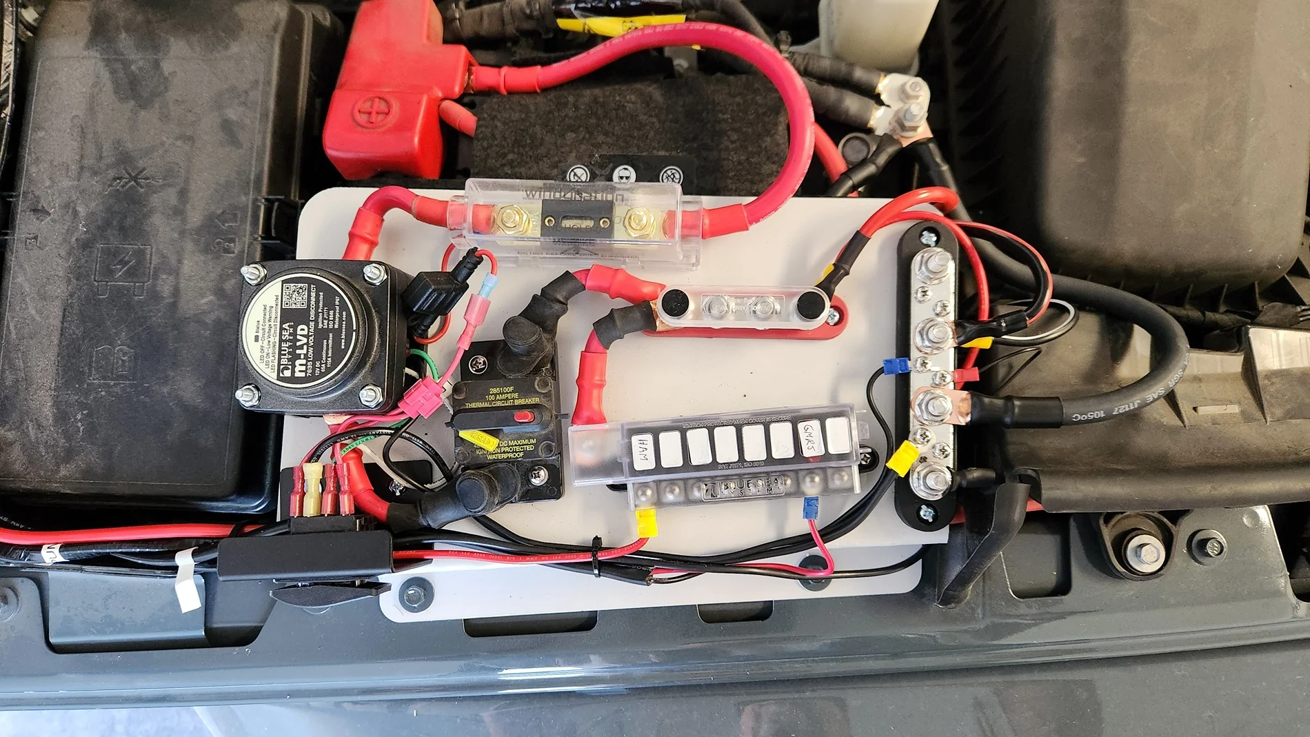

Here is my power distribution setup. If I need to get at the battery, I can discount neg and pos leads, undo the two bolts on the fender, flip the whole assembly to the outside. I leave enough slack in the lines to do that.
My goal was to isolate all accessory circuits. Prior experience with batteries getting kill at the wrong time, wrong place or some accessory that the factory computer does not like. That black box is a Blue Sea battery saver. If the battery voltage drops below a setting level, it disconnects the accessories until the engine starts up and there is adequate current. Override switch is just below it in the picture if I need to run the radios in an emergency or something. The only add-on directly wired to the battery is the winch.
A hodgepodge of what is powered by this. Have added a few things since this photo was taken, but currently, one 6g lead goes out to an AuxBeam controller for the offroad lights. The ARB pump and my radios are wired directly into the fuse box and power blocks. One 8g wire goes to a secondary distribution block similar to this that is under the back seat platform. There a charger, lithium batteries, and power for USB ports, a 50qt frig, interior lights.

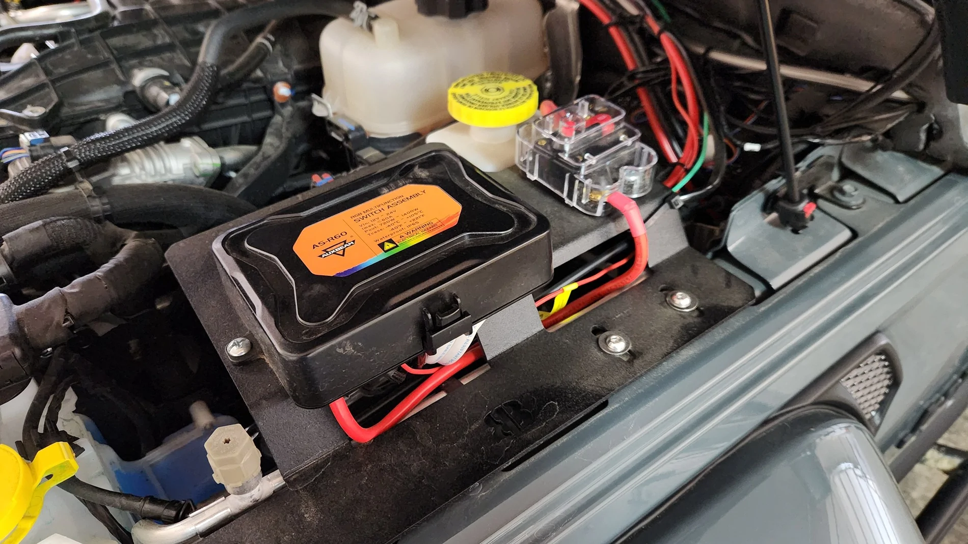

The plate was made by my my neighbor, a fab guy. They are available from various venders as well. I like the ones from 813 Fab. Have one of his plates on the other fender for the AuxBeam controller. Also have his firewall mount for the ARB.

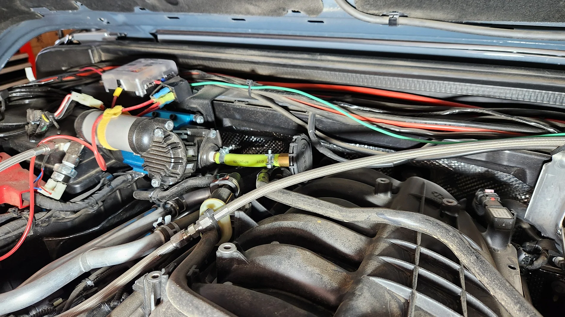

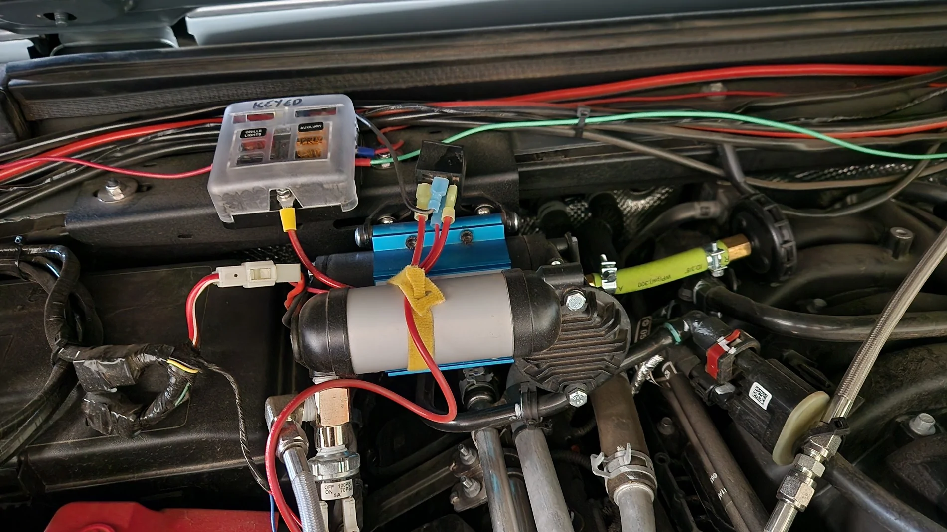

I need to tidy up my wire bundles yet. The hose for the ARB is a bit long, but that is what I had on hand. It goes to an outlet on the cowl.
Both the 813 mounts were easy to install. The pump mount takes a little creativity to set the bottom bolt, but he gives you hints on how to do that in the videos.
