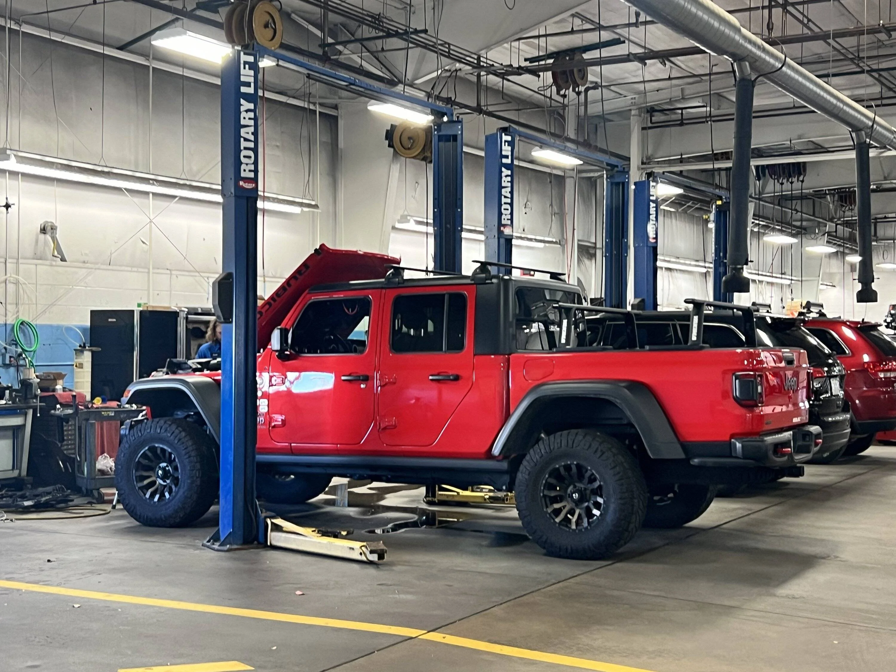

Doing my HPFP recall today

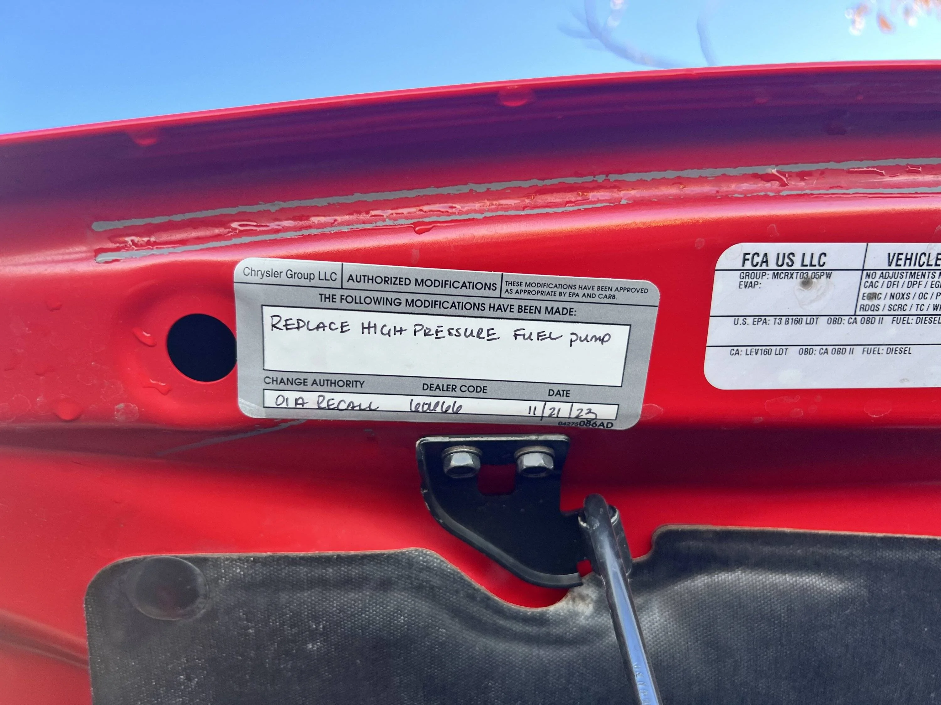

Almost the same deal with mine........if the recall was completed there is supposed to be a recall label placed beside the existing emission sticker under the hood(this is directed as part of the recall service bulletin)
My Jeep Gladiator arrived dealership on the 16th of October. However I was not able to pick it up(until 4 Nov) due to a lag in information on the 01A recall..... the system updated at the end of October and said my jeep had the recall completed on 1 Nov...by who we don't know or what day.
...but for my gladiator there was no safety recall sticker under the hood (the Recall Addendum to the manual, the Diesel fuel tip card, and the B5 sticker Placed for the fuel door were there in the list of documents)and nobody can tell me the exact date the recall was completed. The date listed in the system is incorrect because it was sitting in a parking lot from 16 Oct 2023 until 3 Nov 2023. The Service Dept. did not order parts and only moved it on the day they cleaned it up and did the Safety inspection prior to my pickup on Sat 4 Nov. They were like hey we didn't do anything to your vehicle but the system says we can release it to you.
My next step is to pull the pump cover off and look for the part number. Jeep Cares......... had no clue..... I know mine was in the middle of being built before the recall happened/shut everything down and then UAW decided to leave the plant right when the recalls would have been completed.... Dealership said they will order parts if they find out it was fat fingered, but you would think someone would document this somewhere other than to say it was done.
