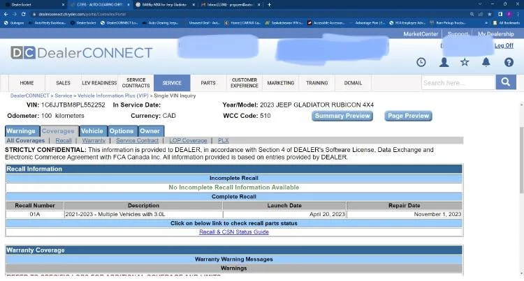

I am taking delivery of my gladiator soon, and I had asked for them to perform the recall before I picked it up, and they just sent me this screen shot. The salesman says it’s been done he thinks. I called the service department in late October to ask about it and they said to take it as is, and they would perform it at a later date.
Looking at the screenshot, I would say it was done on November 1st correct?
Thanks
