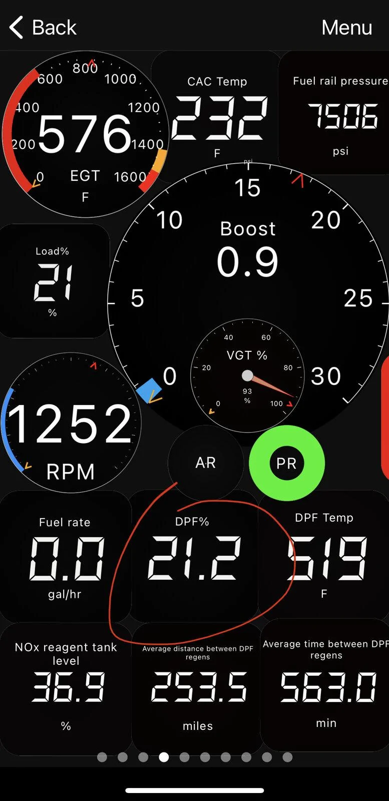

I just checked it again and it was down to ~20%! Didn’t drive any highway miles since my original post, so I don’t know what happened. Glad to know it is ok.
Jeep Gladiator DP Filter at 100% 54B9F7A7-490F-42C0-92AB-7EE915E50170
Thanks for the replies. I’ll keep an eye on it when it gets back to 80%.

It's known that the DPF Filter% is not an actual number--it's based upon a few other calculations. You'll see that if it gets to 100% and stays there for awhile, that's just an indicator that you're due for a regen, not that it is actually at 100%.
If it was actually full, your Jeep would tell you with a notification on the dash that you'd need to drive at highway speeds for 30 minutes--I believe this is in the owner's manual.

I also run the OBDfusion App and have noticed the same thing before, it's happened a couple times now. If I'm not paying attention to the soot level and it reaches 80%, the app will jump to 100% and kick off an active regen as long as the engine is at operating temperature and you have sufficient DEF remaining in the tank.
I have had an incident where I was dropping my son off at baseball practice and clicked on the OBD Fusion app to check EGT before shutting down a hot engine and noticed it was in Active regen. I had to park and get baseball stuff out of the bed and whatnot and by the time I got back in to drive around for 10 minutes the Active Regen had already stopped but soot level still at 100%.
I feel like the next Active regen is not kicked off until a certain number of miles go by but I think it might have more to do with the number of engine starts. I was in the same 100% condition when I took a trip up into the mountains going from 5000' elevation to 9000' so it was definitely getting the EGT up high enough to heat the DPF but still no Active Regen. It didn't happen until a few days after the trip on the way to, once again, drop off my son as baseball practice :facepalm:. I dropped him off fast and drove for 10 minutes and it was done.
Another thing I have noticed is that when an Active Regen starts, you don't necessarily need to drive at highway speeds. I've watched an AR complete while I was stuck on a 30 mph road following traffic. Once the AR starts and diesel fuel is dumped into the DPF, it gets hot enough no matter how fast you're driving as long as you're not stopped.
