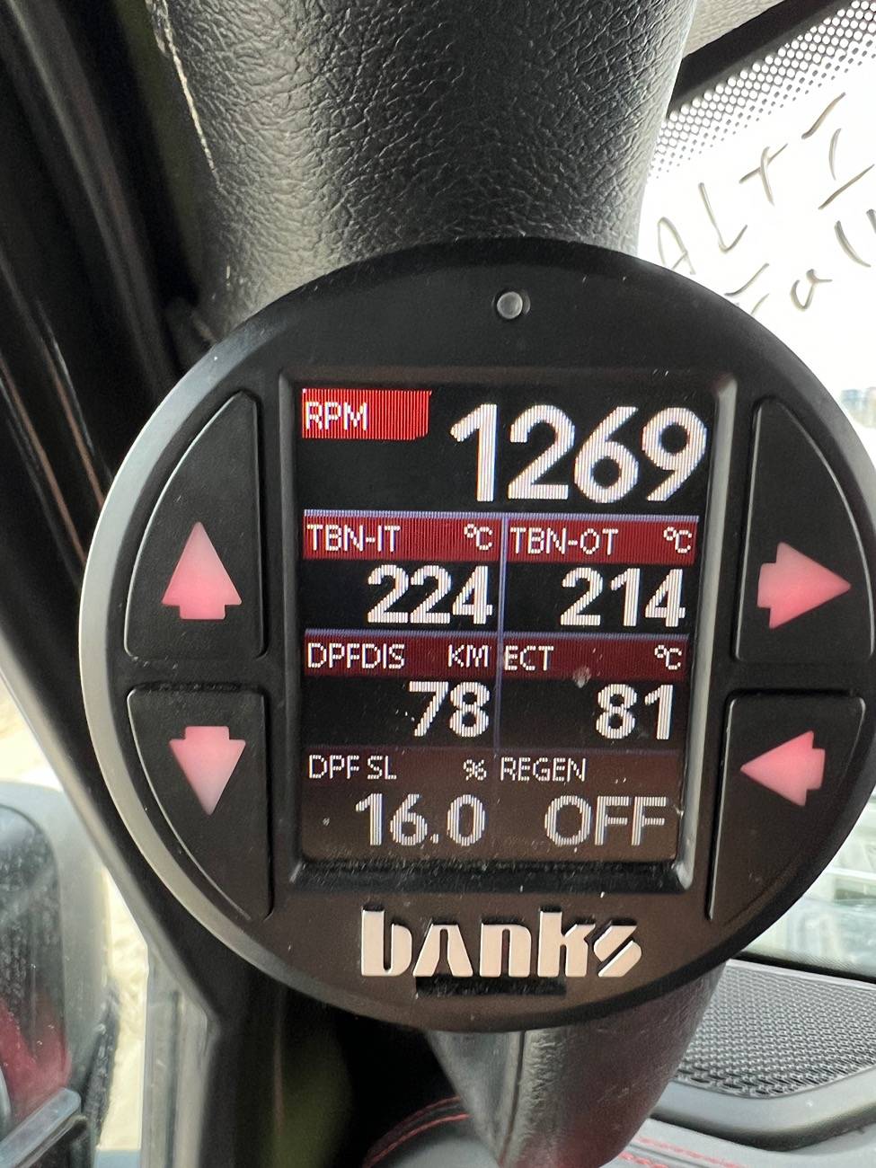

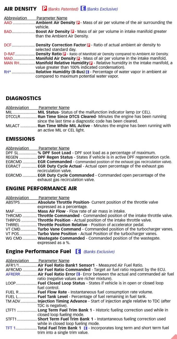

I gave the Banks iDash and when I first set up the gauge set, I was reading 100% too. However that was the wrong selection to monitor. When your engine is working it’s at 100% in that one measurement. I found the correct one to monitor after done fiddling around and even set up the alert to notify of regen starting and stopping. Perhaps you all are on the wrong setting too?
DPF SL % (Soot Level, Not DPF Soot Load %) is the correct setting and if I recall there’s a couple selections that aren’t clearly distinguished. And my DPF Distance is low cause I’ve got a fucked sensor and waiting on parts!

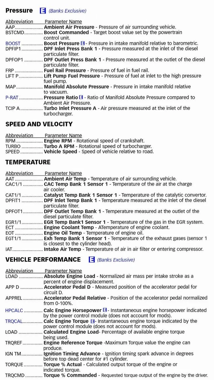

Yeah there really isn’t clear explicit instructions for setting up your iDash. I did find this and it was helpful to navigate these selections! Your Welcome for those have not found this yet, it definitely helped me!

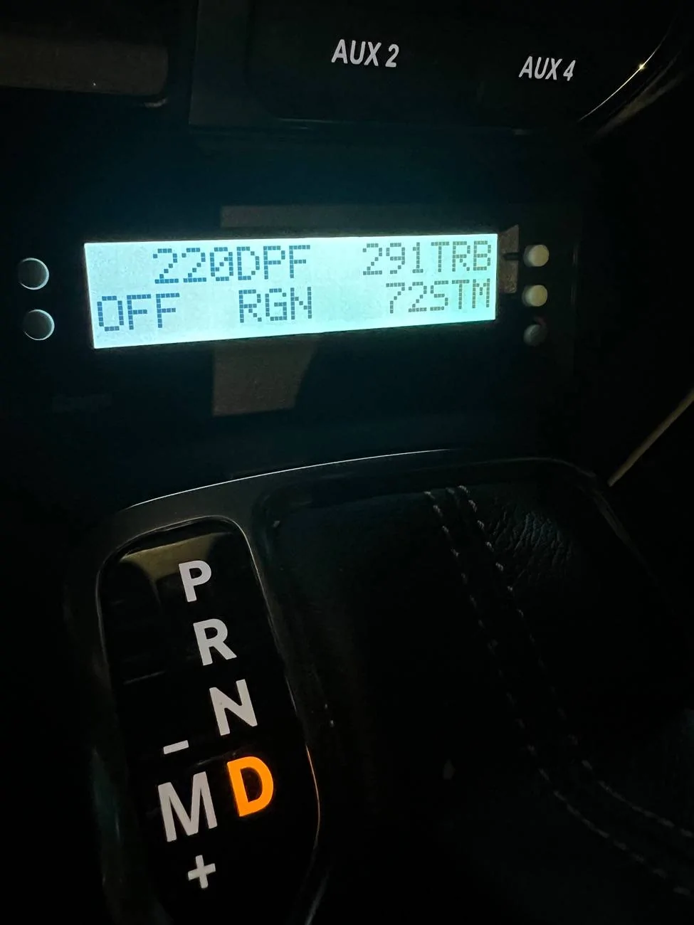

Hi Everyone, quick update from OP. Scanguage installed works great and reporting DPF accurately. Thank you all for your help.

I have the scanguage2 also and like the way it allows me to know when I'm approaching 80% soot on the dpf.
FYI- The AlphaObd app ($50) will allow you to do a forced regen (both moving or stationary) if necessary.
