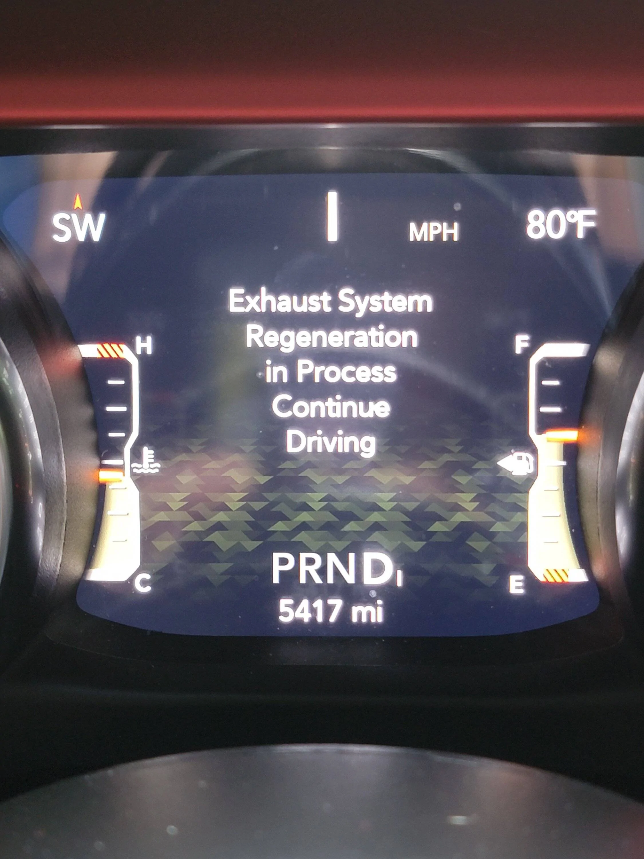

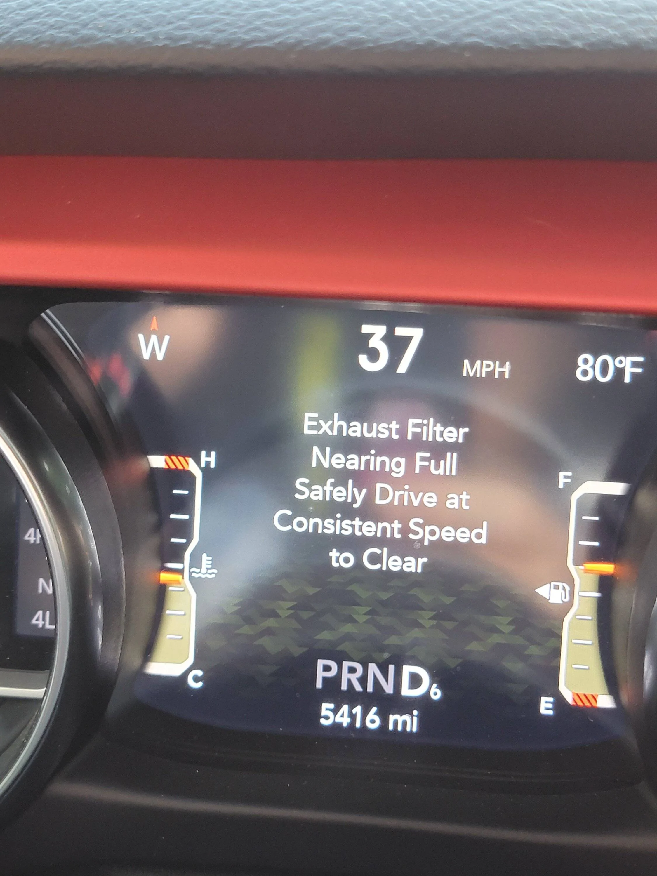

Either way, you shouldn't see this message when cruising down the highway. I don't even see this message with all the in-town driving that I do.
Yeah, In 87k mi of driving, I only saw the top message once (and ironically I was on a windy mountain road where driving at a "Consistent Speed" was not possible).
Don't think I've ever seen the second one.
