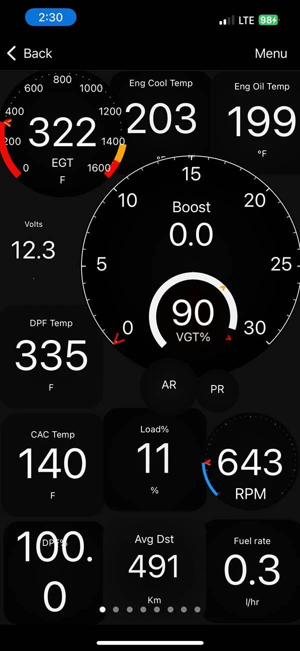

Thanks for this. I bet that is my problem. Pretty sure I'm looking at Soot Load %.
I gave the Banks iDash and when I first set up the gauge set, I was reading 100% too. However that was the wrong selection to monitor. When your engine is working it’s at 100% in that one measurement. I found the correct one to monitor after done fiddling around and even set up the alert to notify of regen starting and stopping. Perhaps you all are on the wrong setting too?
DPF SL % (Soot Level, Not DPF Soot Load %) is the correct setting and if I recall there’s a couple selections that aren’t clearly distinguished. And my DPF Distance is low cause I’ve got a fucked sensor and waiting on parts!

Hi Everyone, quick update from OP. Scanguage installed works great and reporting DPF accurately. Thank you all for your help.

I have the scanguage2 also and like the way it allows me to know when I'm approaching 80% soot on the dpf.
FYI- The AlphaObd app ($50) will allow you to do a forced regen (both moving or stationary) if necessary.

I just installed a Banks iDash yesterday. That seems to be working much better minus the manic regen status between off and passive.
It does appear my OBDFusion was set to the wrong attribute, but I haven't tested the other live.

Depending on engine load. My iDash will flash between pass/regen all the time. Until the SL% gets to about 75%. Then it's a solid pass until it drops to 9%.
