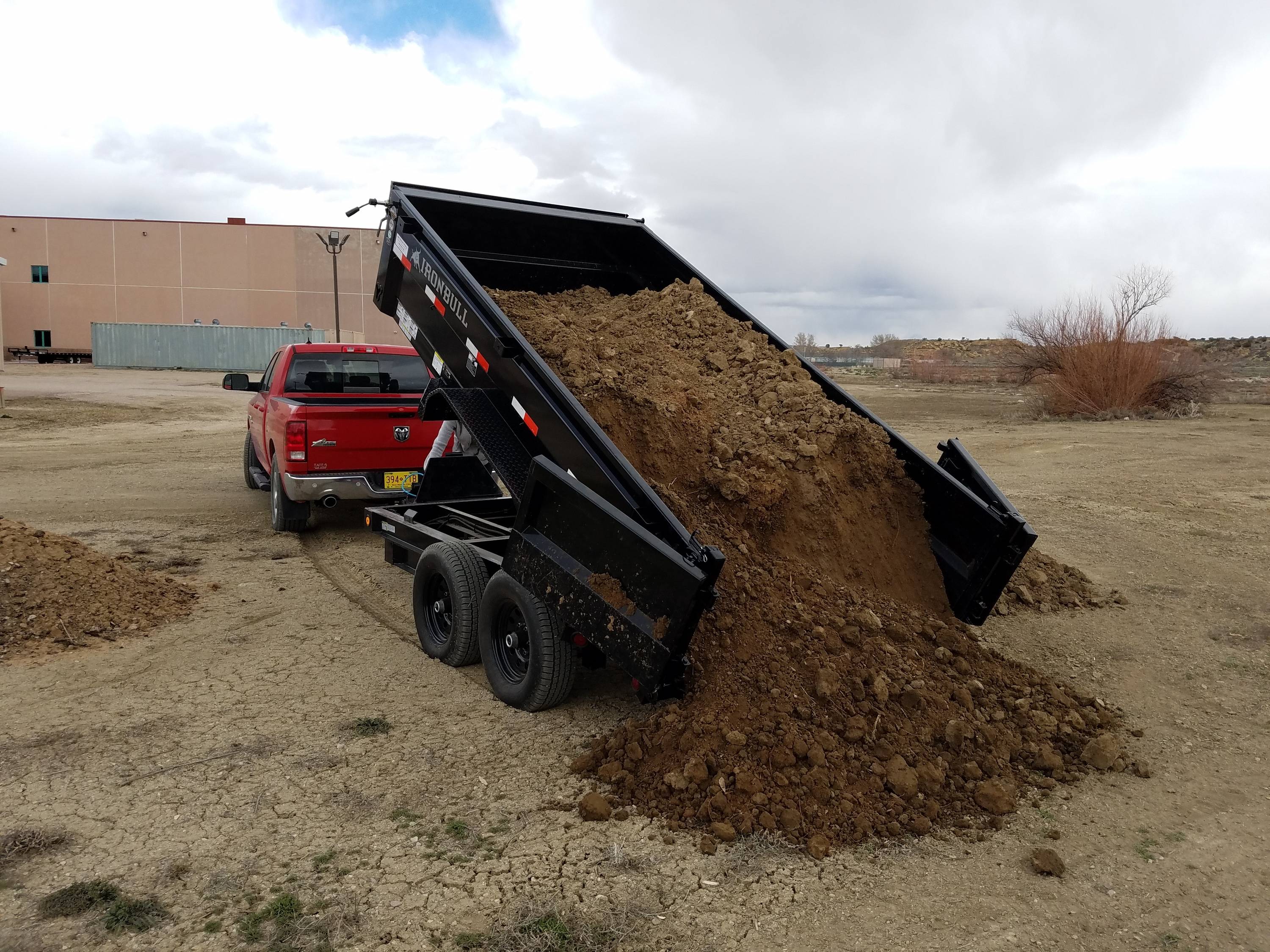

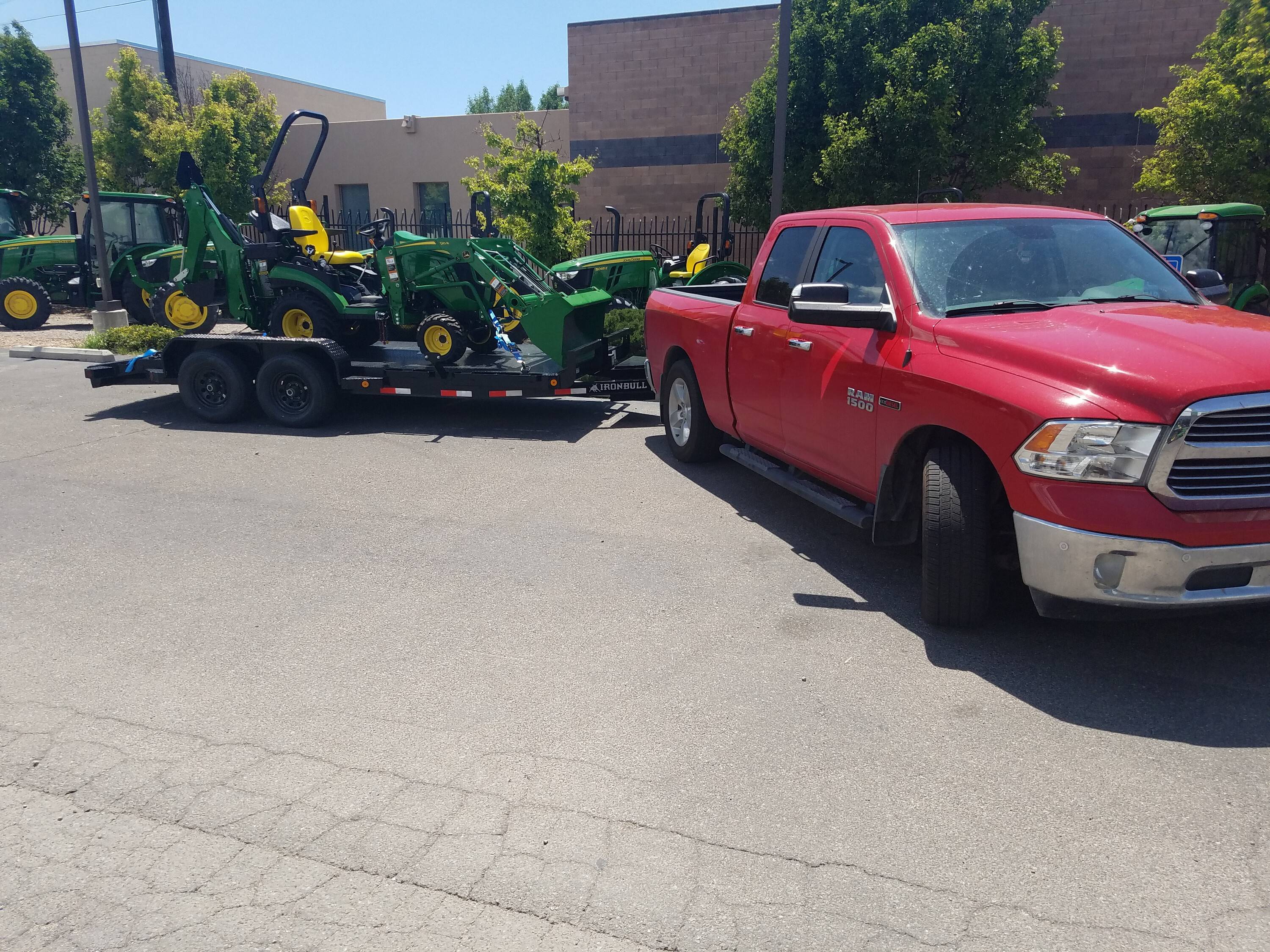

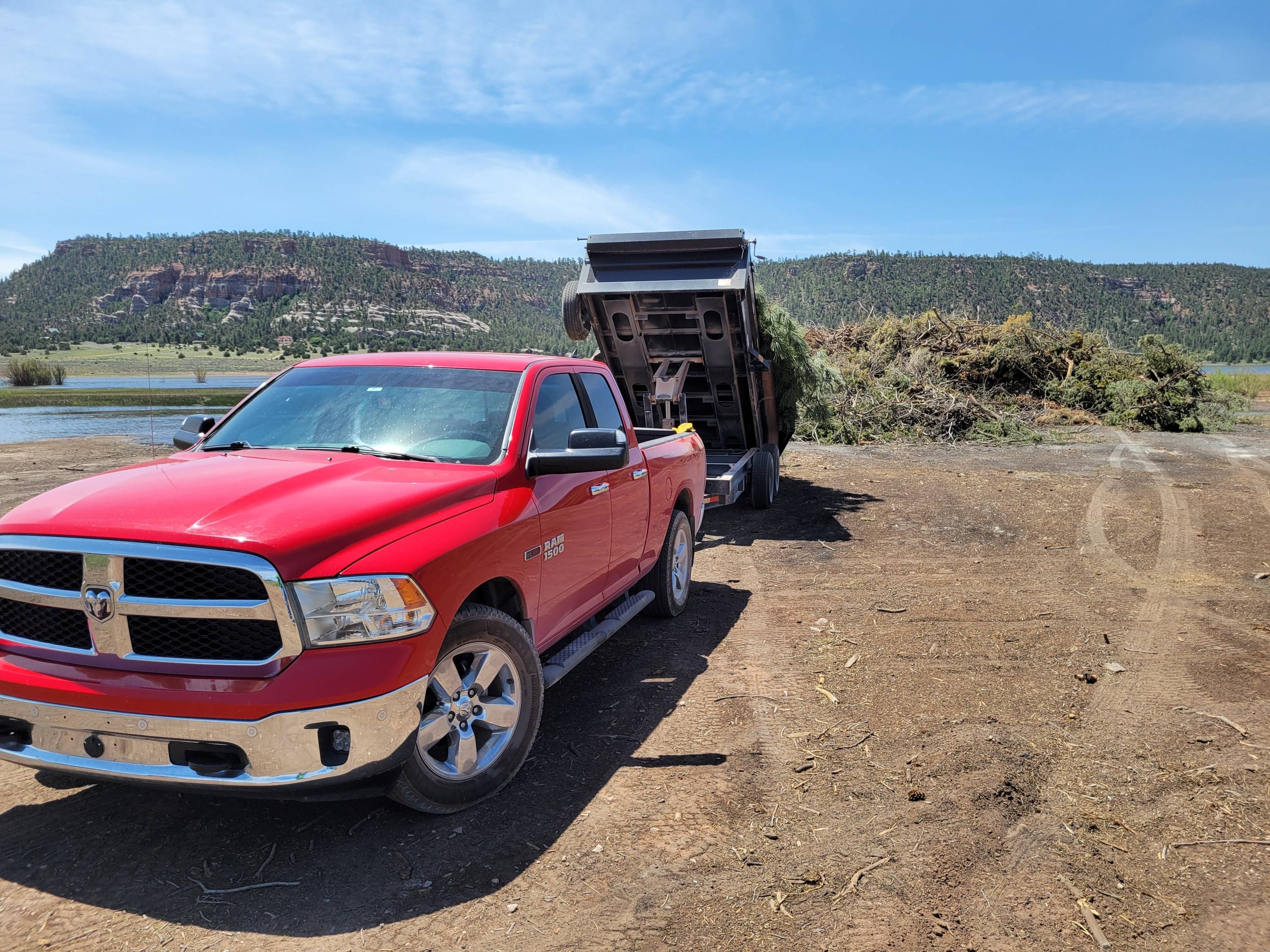

All three of our EcoDiesels are bone stock. The truck that I'm daily driving is a 2015 Ram EcoDiesel. We bought it brand new, and it's been daily driven ever since. Plus, it's towed from coast to coast and many states in-between. At that last oil change, it had 405 hours of idle time and 3,099 hours of driving time.
Just seems like TOO many active regens would shorten the life of the DPF. Would that not be the case?
Running a low SAPS oil will extend the life of the DPF exponentially compared to a High SAPS oil. But yes, frequent short commutes, high idle times, and lots of cold weather operation will shorten DPF life. With that said, there are stock tuned EcoDiesels with over 300,000 miles on their DPFs. I'm hoping to get at least 150,000 miles out of mine.
