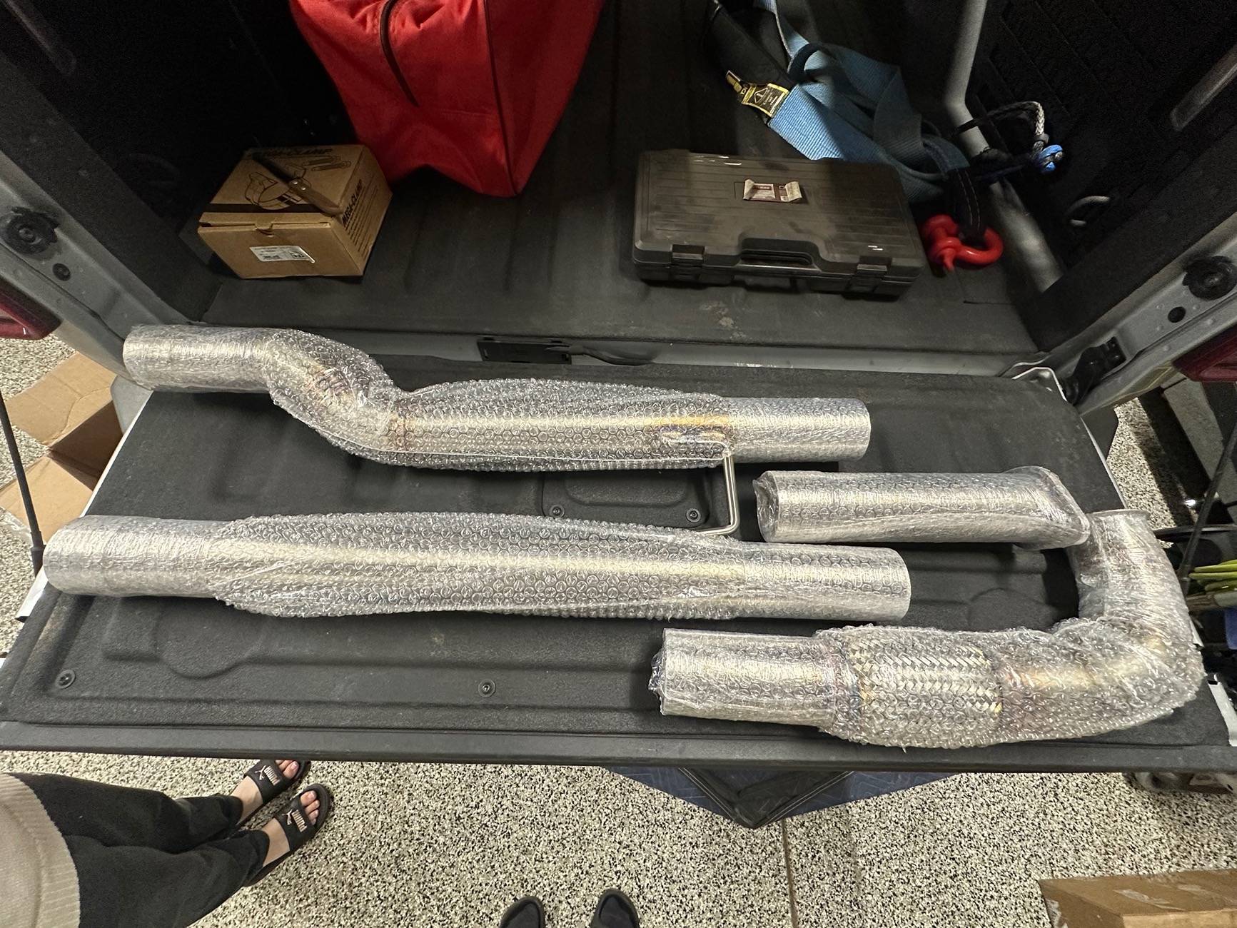

Got my goodies in today. BTW am I missing a piece of exhaust ?
You have everything for a turbo to axle exhaust. The factory axle-back will bolt up. Also looks like you opted out of the resonator.

Perfect then am all good, that’s what I was thinking when I seen it just wanted to make sure. Yea MrTuning doesn’t have one with resonator for the gladiator so I’ll just be cutting in one if it will be tooooooo downy.
