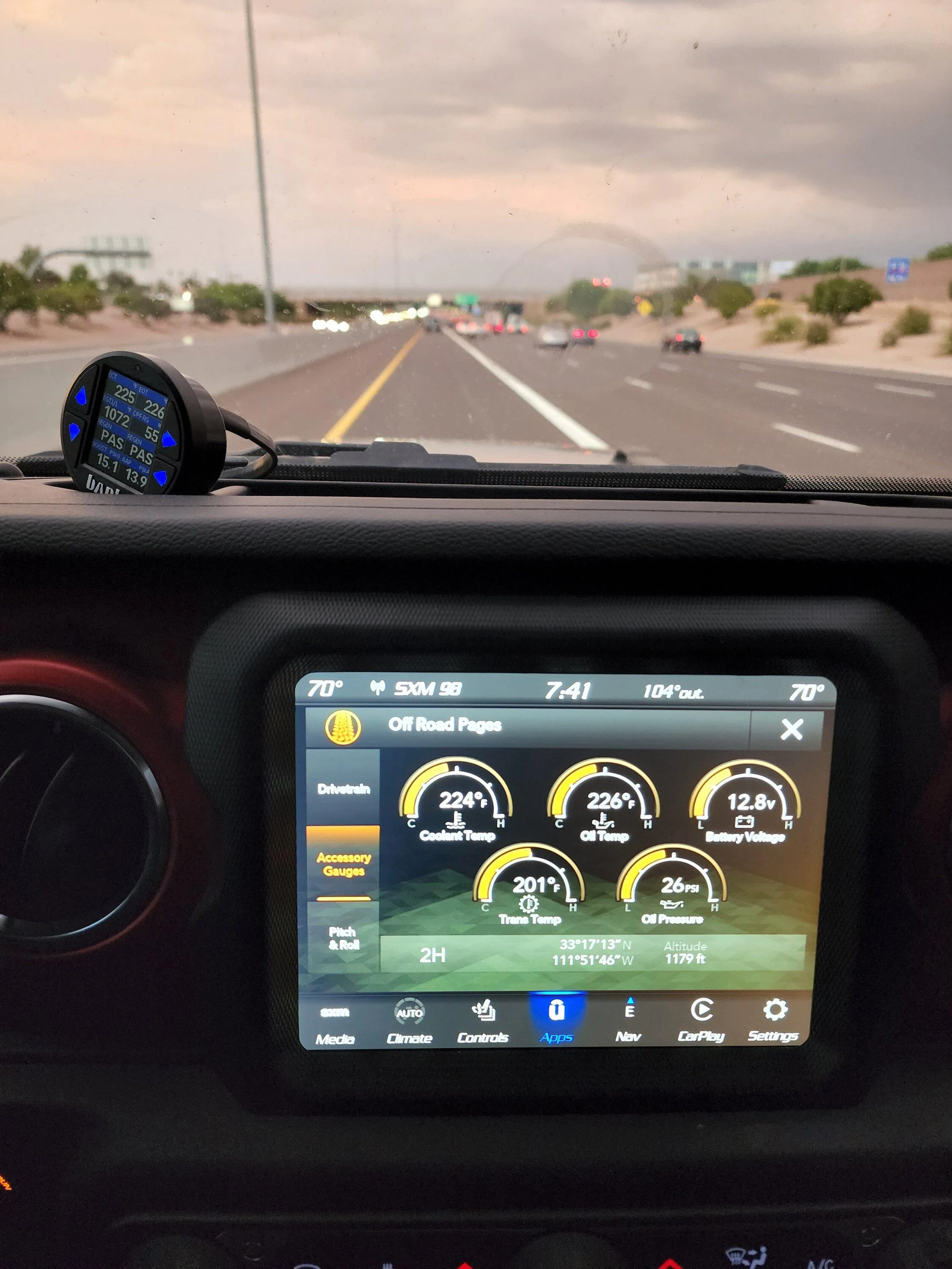

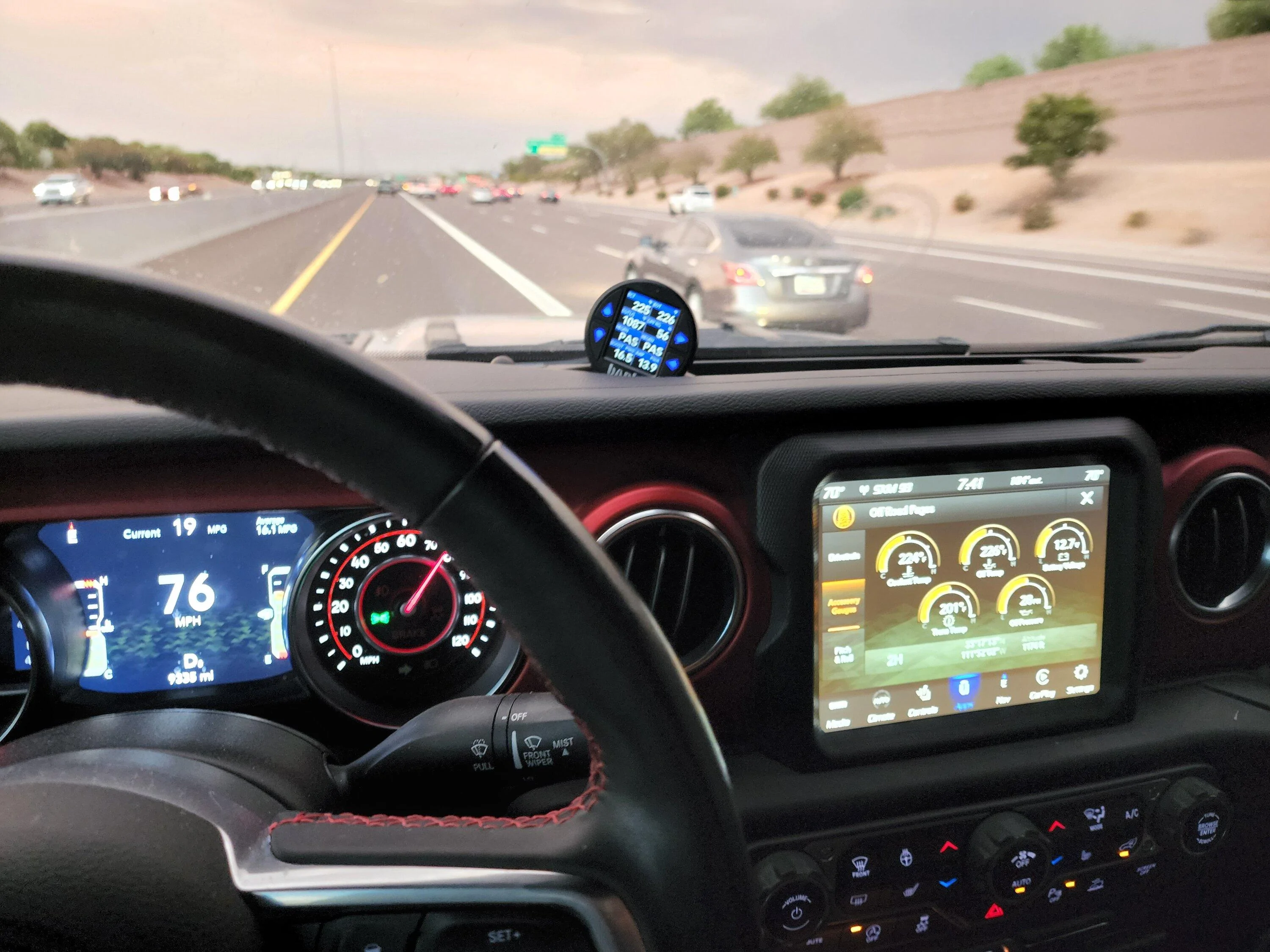

I believe the cooler I already have is too big. The flow is not high enough to take advantage of a big cooler. I know if I added a pump I could get better cooling out of it.
When I say 10 degrees it's a solid 10 but it's linear. My oil temps are always within a few degrees of coolant temp. During street or highway driving. Only when I'm really pushing it does the gap widen.
Just for reference.
I've got about a 5" lift. True 38"x13.50 tires. Stock gears and motor.
I tow about a 3500 pound trailer. I havn't towed the trailer much after the cooler add but I have towed it on flat ground on the freeway and there was a solid difference.
Now that I have a gauge where I can see EGTs I'm more concerned about that now. Freeway cruising at 75-80 I'm running 1100. If I put the pedal to the floor and run it up to 90-95 I've seen temps hit 1600. I can only imagine that next time I'm pulling a trailer up a grade I will see the same temps if I'm not careful.
I live in PhoenixAZ. HOT!
