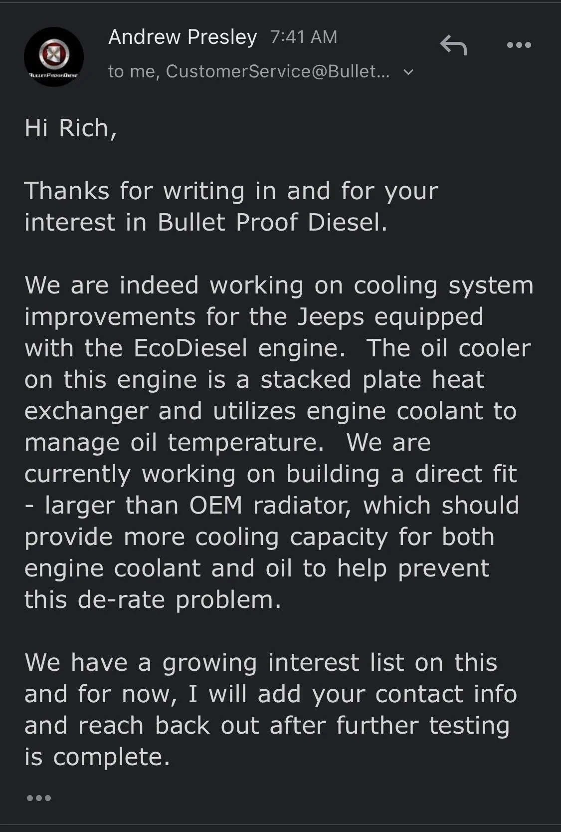

I think I posted this in the wrong thread… ??‍♂ Anyway- here is the response from bulletproof. Looks like they are perusing coolant improvements and not oil cooling directly.

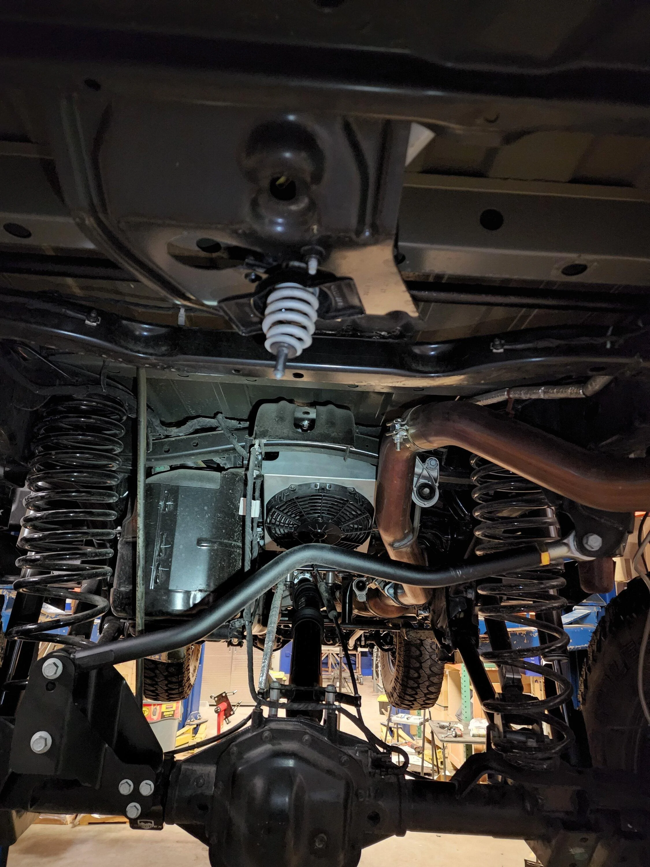

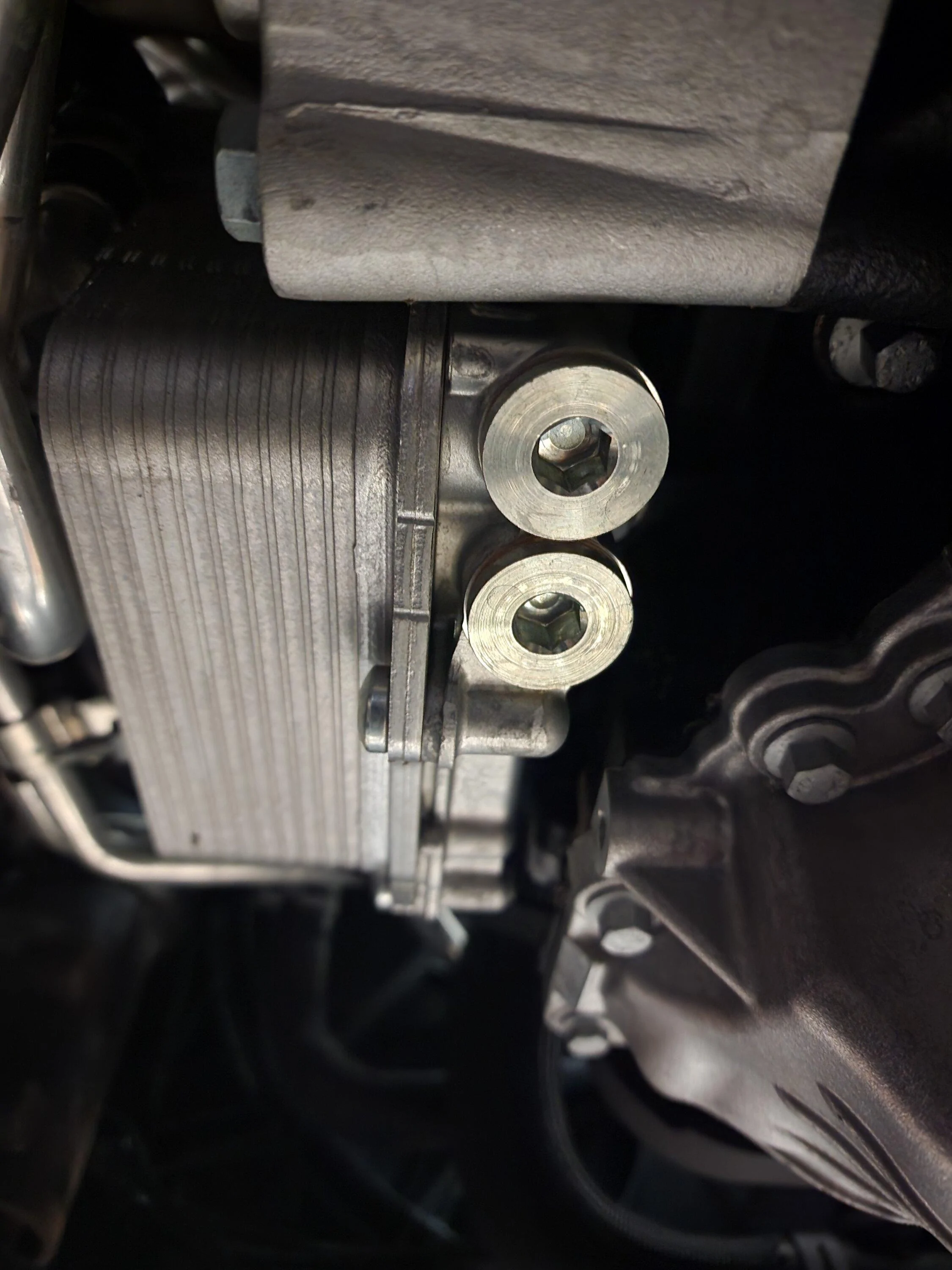

I put in an oil cooler to help with temps. I would say I get an average 10ish degree drop. I just used the bungs that are already on the motor next to the factory oil cooler. I didn't use a pump but I've considered it. I think the bigger problem is EGTs.
Didn't get a lot of pictures. Will try to get some next time I'm under there
I have been contemplating this, since you posted this.
What does not make any sense to me- this hookup is “too easy”- obviously you haven’t grenades your motor.- or at least yet. But I find it hard to believe with how many companies have made plates for the previous generation, or are actively designing aluminum radiator for this application didn’t think about connecting a couple line fittings, some hose, and an oil cooler……
We (we as in those actively participating in this thread) are missing a key piece of information that has kept companies from going down this road.
I am not knocking you by any means! I think it’s great! Something just isn’t right…. This is too simple of a solution to make money on…..
