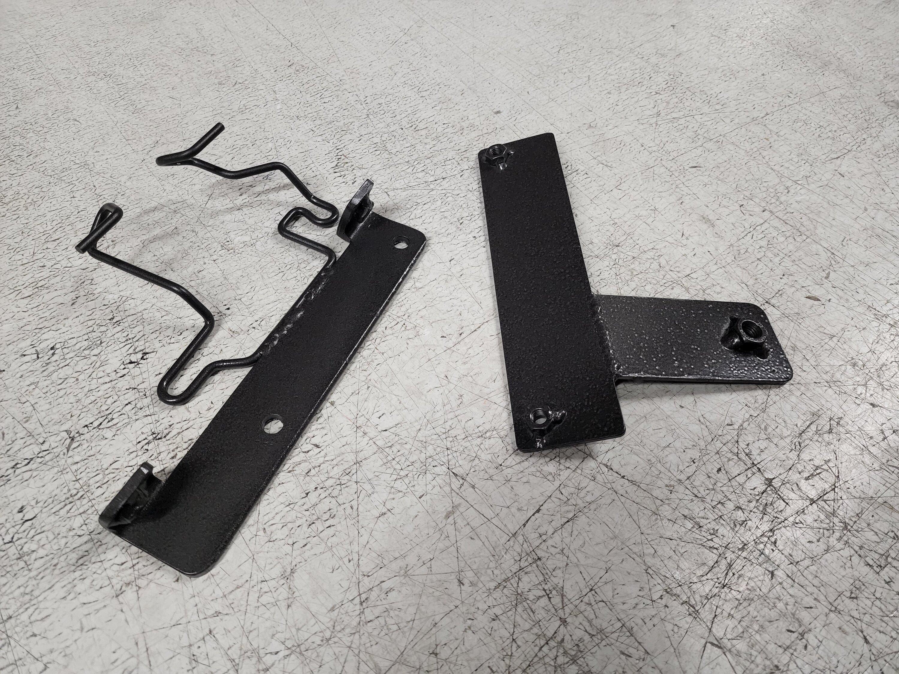

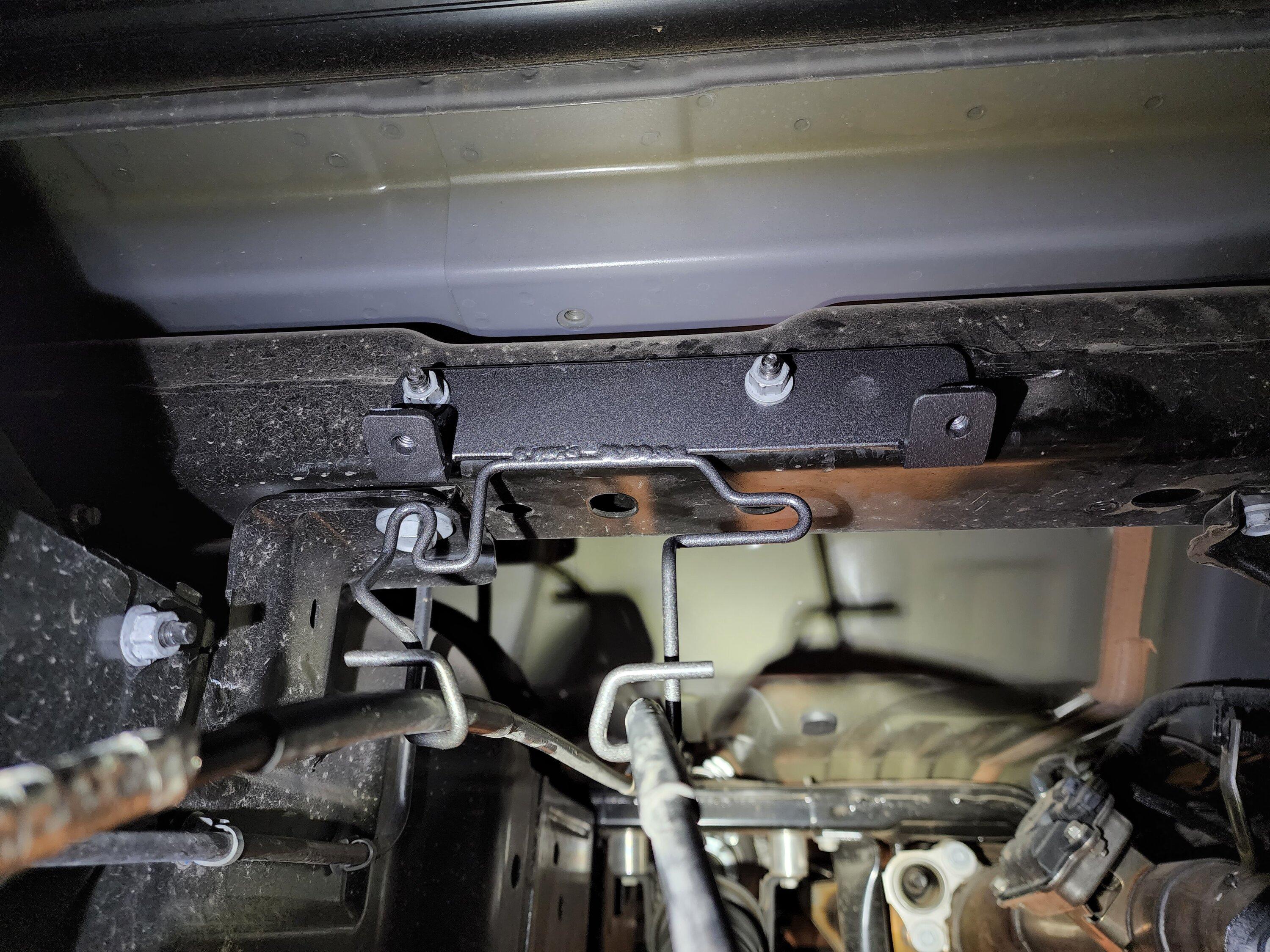

They are definitely in and out from the oil supply. I believe front one it out and back one is in. I didn't keep track after I decided to not run a temp switch. The oil temps are always higher than the temps available for those switches so the fan would always be in anyway. I just have it running off one of the aux switches and set it to remember on/off position after ignition. I can turn it off that way if I need to.
I think you could probably get more cooling out of it if you added a pump.
The cooler is the better Derale cooler with the 10" fan.
I'm not sure the cooler would fit in the same spot on a gladiator without a lift. I had to drop my emergency brake cables about 3 inches to clear the cooler.
