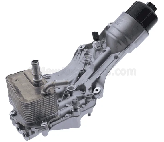

FYI this is your factory "oil cooler"
Jeep Gladiator Ecodiesel power derating as temps rise? 1654890410754
Engine coolant cycles through the heat exchanger to stabilize oil temps. Unfortunately oil temps regularly get higher than the coolant system and due to this design are unable to be cooled below the coolant system temp (210-230).

There is an external transmission cooler but the oil cooler is a small heat exchanger built into the filter housing that cycles engine coolant through it.
There is no external oil cooler on the ecodiesel?
Both diesel shops I had it at said the oil cooler was external, I don't know, I didn't crawl around under it to look. They both took lots of pictures from top to bottom to try to figure something out. Bulletproof Diesel in Mesa has a pretty good rep for diesel performance and after looking at mine was going to buy one to play with it. I just sent my contact an email to see where they are.
Dealer told me that if I replace the oil cooler, it could cause warranty problems, so there must be a cooler other than where it is on the 3.6 motor. The whole idea with the diesel that is stuffed into the small engine compartment is that heat is an issue. There is no issue on the Ram truck with the 3.0 as there is plenty of space under the hood.
So based on what the dealer and Bulletproof Diesel told me I'm still thinking there is an external cooler somewhere for the 3.0. I can't find one but I know that the Ram does not have one for sure and there is some complaining of derating on their forums also towing 8000+

The oil cooler is external.....its bolted to oil oil filter housing and fed water to cool it.

Almost none of the Jeeps that have come into the shop till JL/JTs have had separate coolers in front of the radiators......they are in the radiator.
Like most production vehicles over the years....unless they had some kind of "HD towing package" that's all they usually have is the water/oil exchanger in the cold side tank of the radiator.
