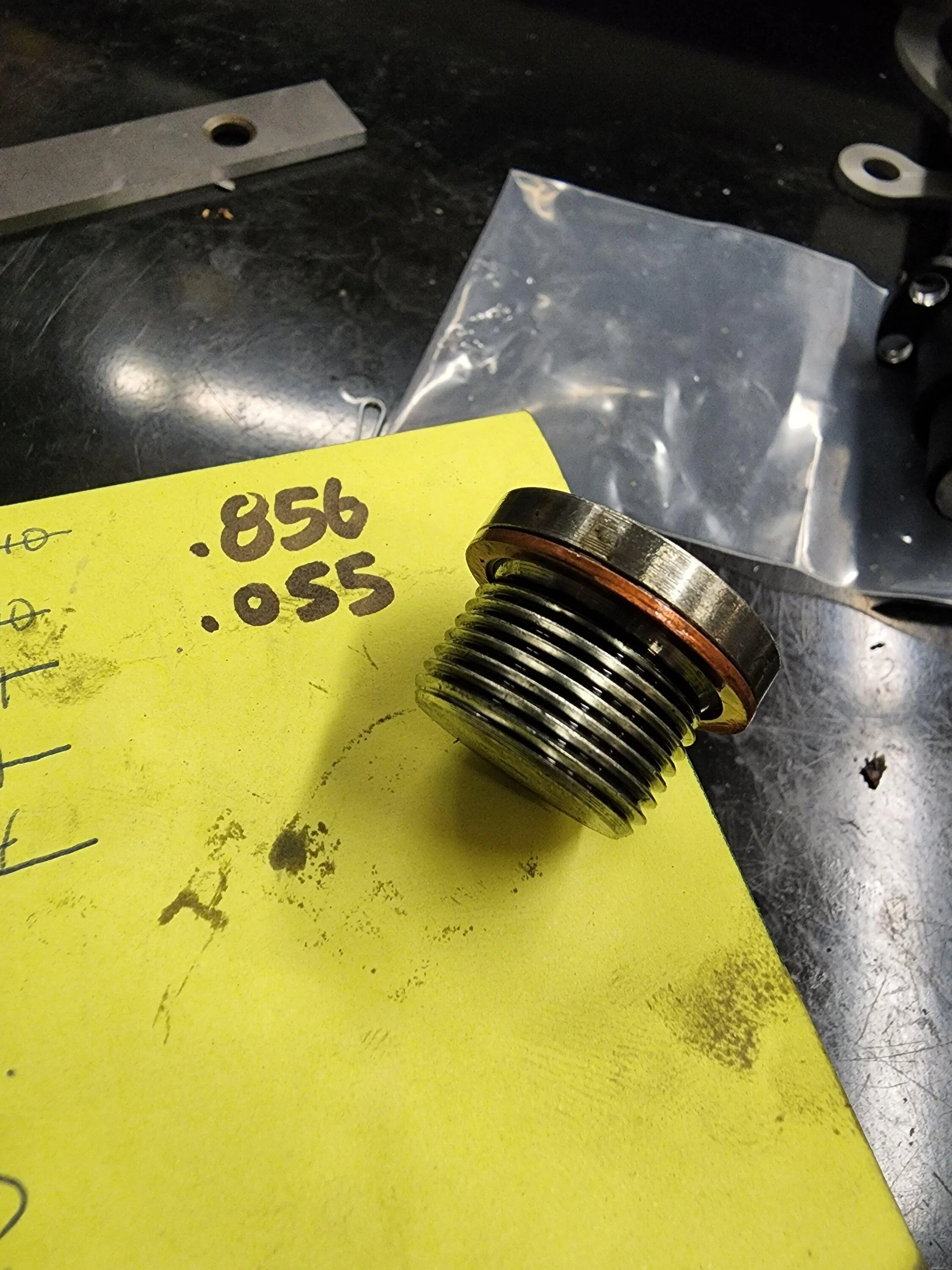

Somehow they were able to machine the gen2 without those holes? Plus, they would have just put in press in plugs and not machined that size hole and used a plug with an O-ring in a size commonly used for oil line bungs.
Let's say your right, who cares? One side is the pressure side that feeds the stock oil cooler and the other side is a return.
I don't think you'll gain much by bypassing the stock cooler. Under normal load with my cooler my oil temps are are within a few degrees of coolant temps. Oil temps are usually 10 plus degrees over coolant in almost every vehicle out there. Only under heavy load do my oil temps climb higher than coolant.

What fittings go into the cooler? Is it boss-oring?

M18 maybe?

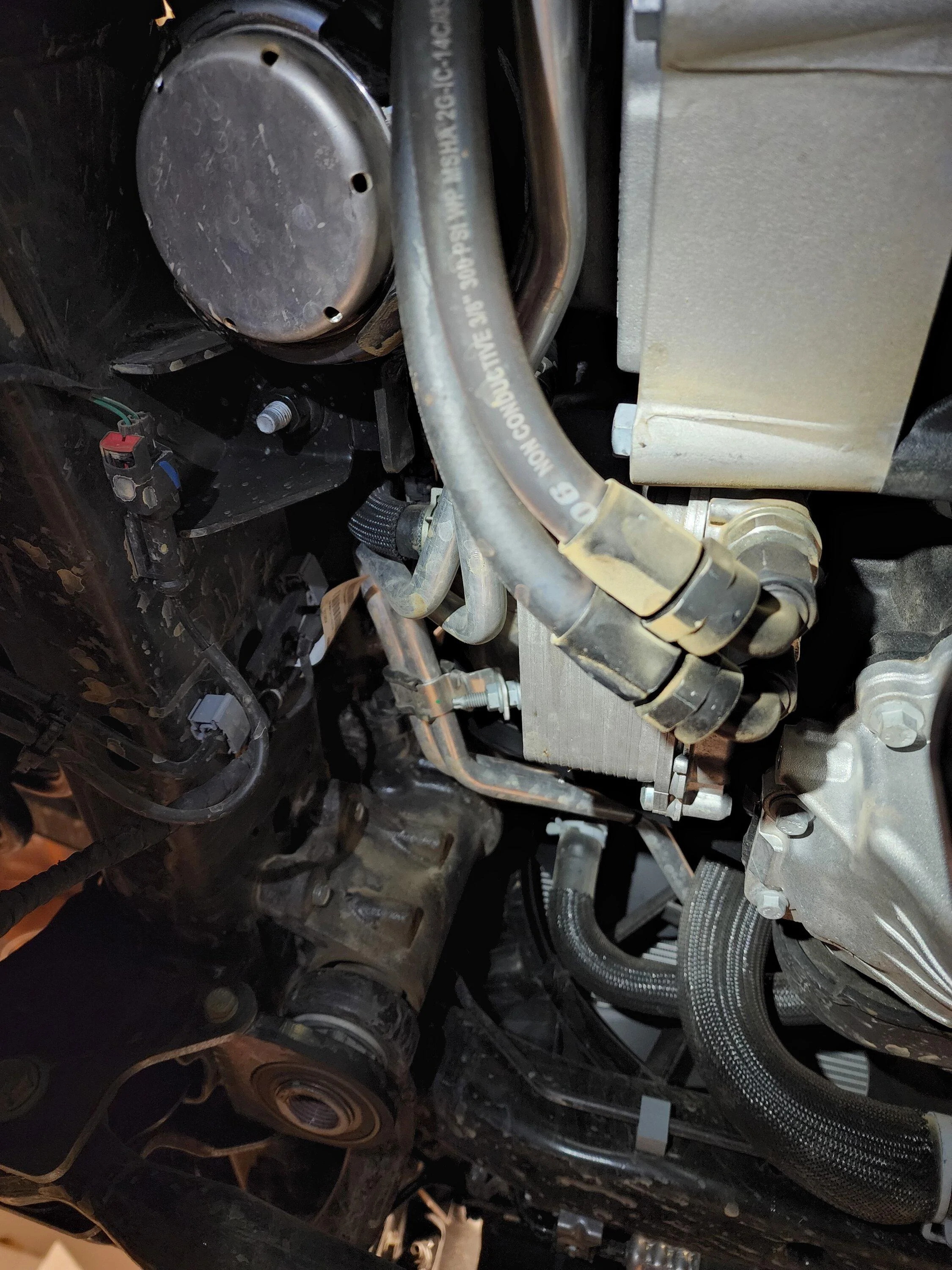

Thanks, I tried coming out of the water side of the oil cooler into an auxiliary cooler and only saw about a 3* difference while towing. I used one of Derale’s larger coolers.
I’m now skeptical that Bulletproof’s larger radiator is going to make a difference.

I don't remember. I was metric oil fitting. I just called my fitting guy and he figured it out. This is the info I gave him.
What is the attachment on the fitting you used?
AN, SAE, JIC?
You mean by cooling the "coolant" flow through the heat exchanger?
Did you keep the the radiator water still circulating or bypassed it?
If upgrading the coolant heat exchanger had no benefits then the factory heat exchanger is likely undersized for the application?

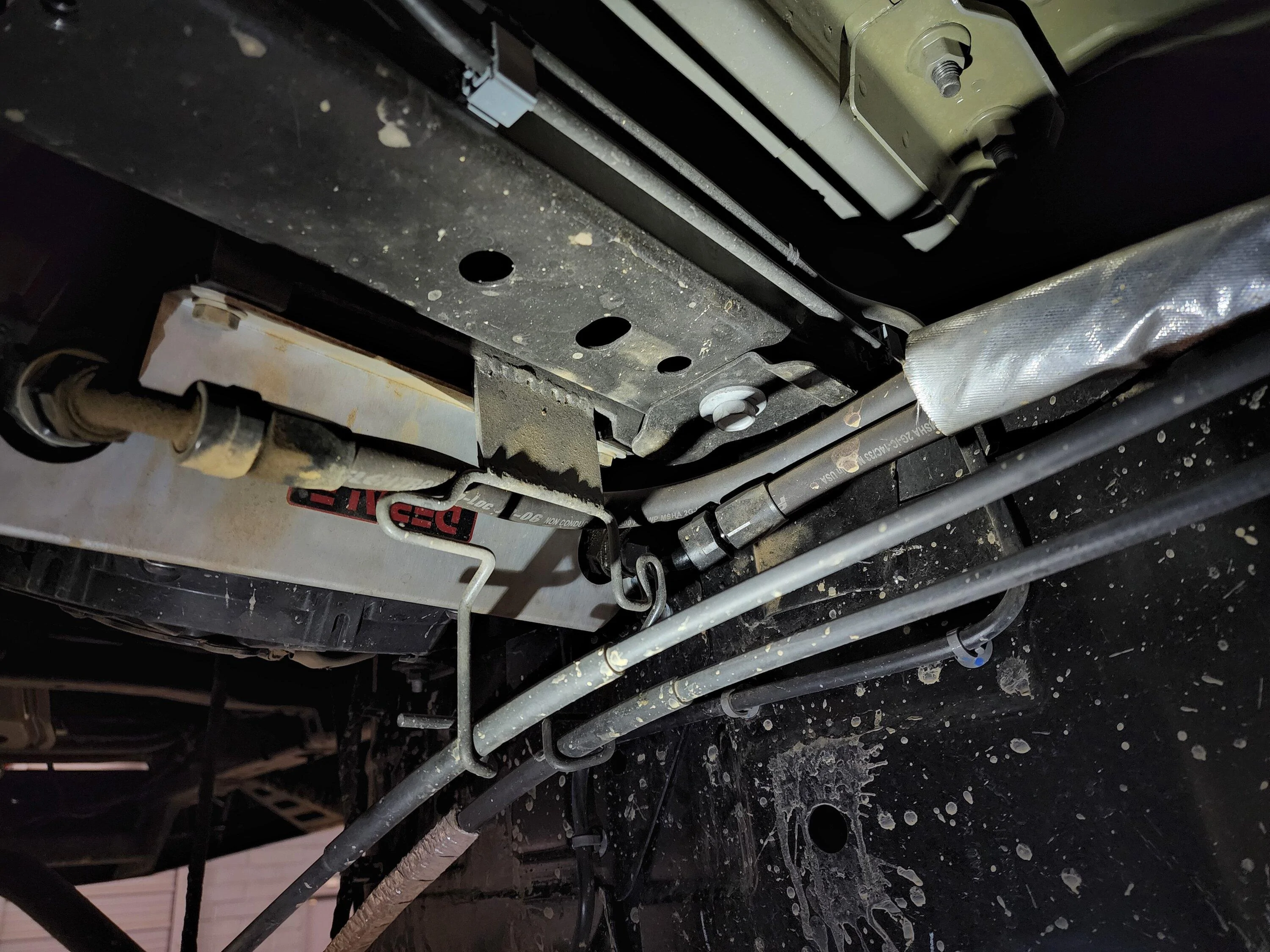

Still waiting on the oil filter housing. My order is still "processing". Once I get it I'll have all the info. I am prepping my wife's Wrangler for it. Going to make a custom axle back muffler delete and mount the cooler where the muffler was. I wish it would ship already.

I went from the block into my aux cooler and then into the factory oil cooler.
