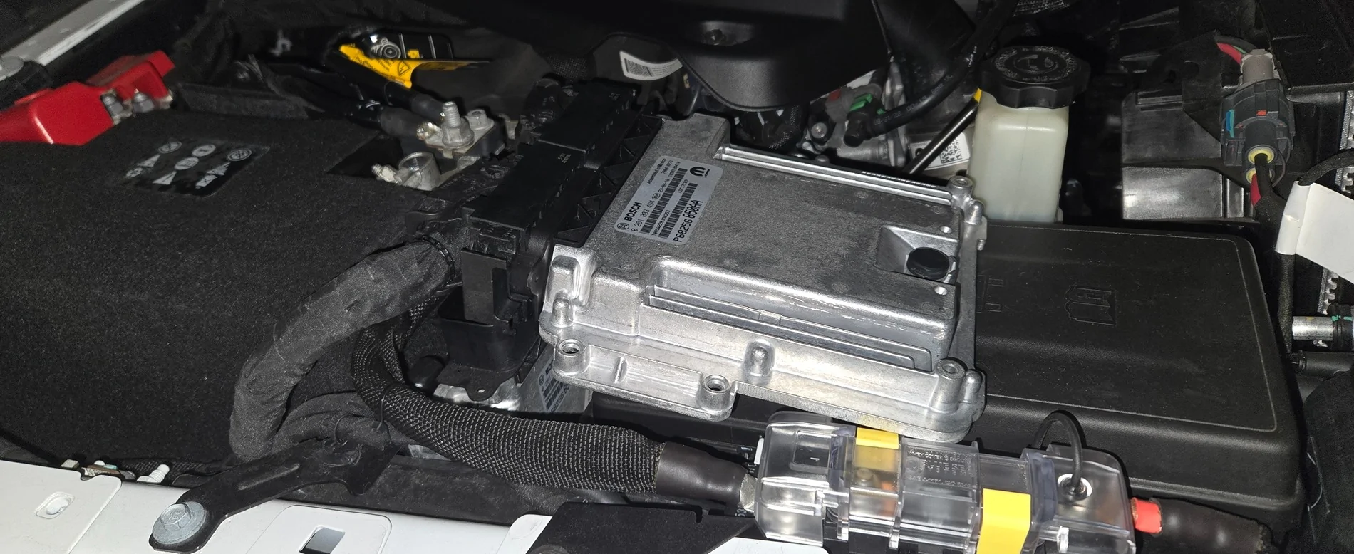

When people say they leave the original PCM in place, and mount the cloned PCM (with tune loaded) near the fuse box, what exactly are they doing?
Which PCM stays in the original location, the original PCM?
Are there any photos of what this 'dual PCM' setup looks like?
What is the benefit of doing this?
Thanks!

Right up above there is a picture from DailyDriven. Click on the pic to expand. The cloned one is sitting horizontal, and right where the black plugs are, right below that, vertical, is the stock one still left in place. If you wanted, unplug the tuned one and move the black plugs to the stock one. Some people use double sided tape and velcro to hold the tuned ECU in place.

Ok, thanks, I get it now!
Is leaving the original ECU in the original place just a matter of convenience and ease (not having to slide it out)?
If this is how some people are running the cloned ECU, I assume it works fine; I was wondering if there is any concern about heat or vibration on the cloned ECU, sitting 'exposed' like that? 🧐

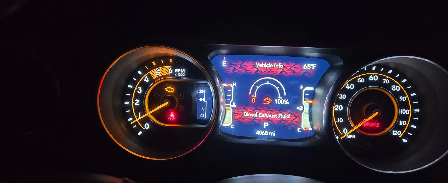

I currently have a DEF warning up with 70kms left till it wont start. I wish I had done this all sooner. Of course I'm planning a trip to Philly on Sunday and this happens.
