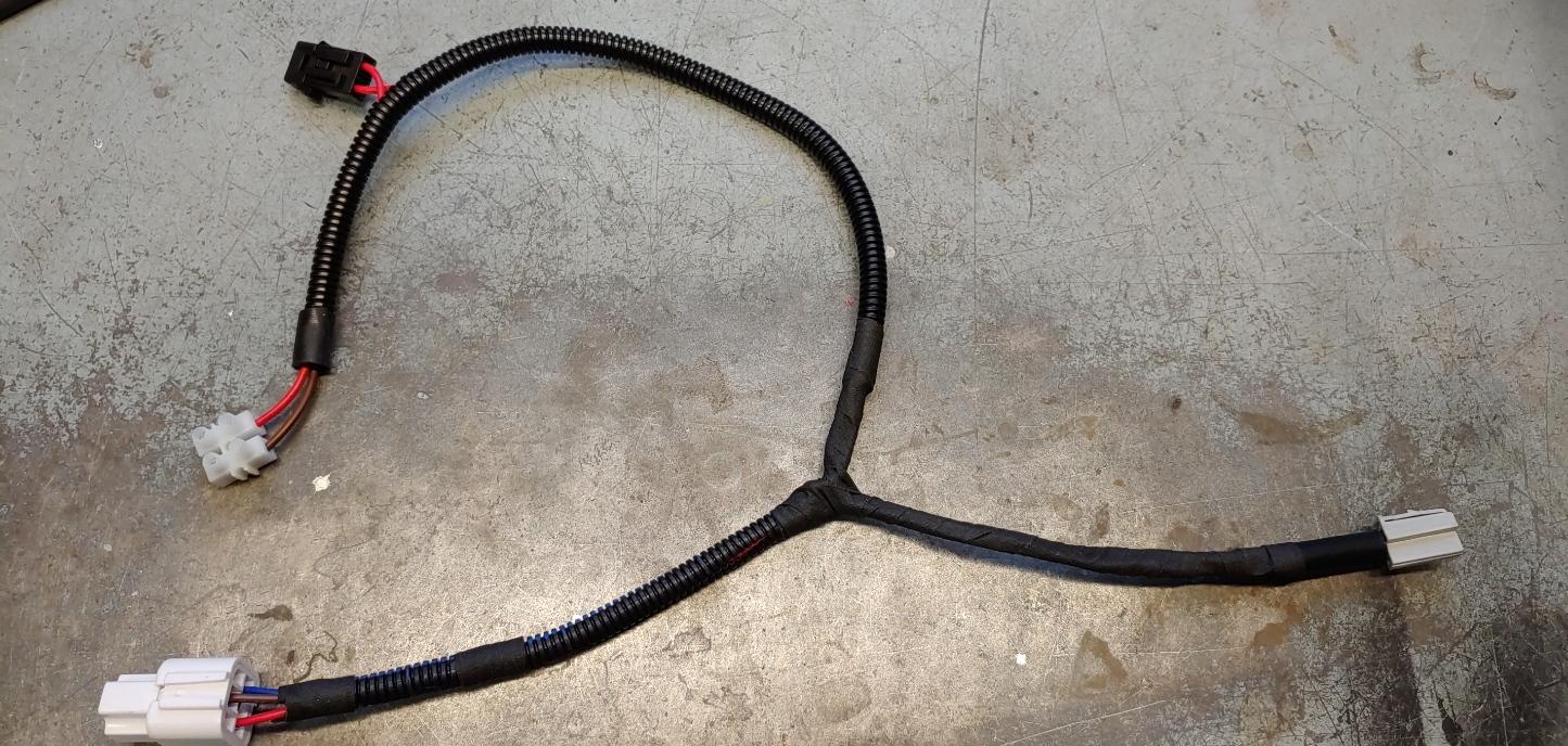

You don't have to use the other stuff. Everything you need for an extension is right there. Just have to change location of a connector.
You don't want to use it, that's fine. But it's a simple, 30 minute job for just about anyone else that is reading this to use. No need to source anything but the correct length of wire for the blue wire that is a short jumper in original configuration.
40,463
53,908
No offense, I know you are trying to help...... but, well, I know - I wire cars and build wiring harnesses for other people to restore classic cars.
IF I had the connectors we'd be talking 10 minutes tops. (strip wires, western union type joint, solder, heat shrink, good to go)
It likely has long enough wires I could harvest and not get into my tubs of auto wiring harnesses.
I custom made all of the engine bay wiring here - (it's what I do ;) ) including converting the headlight to run on relays.

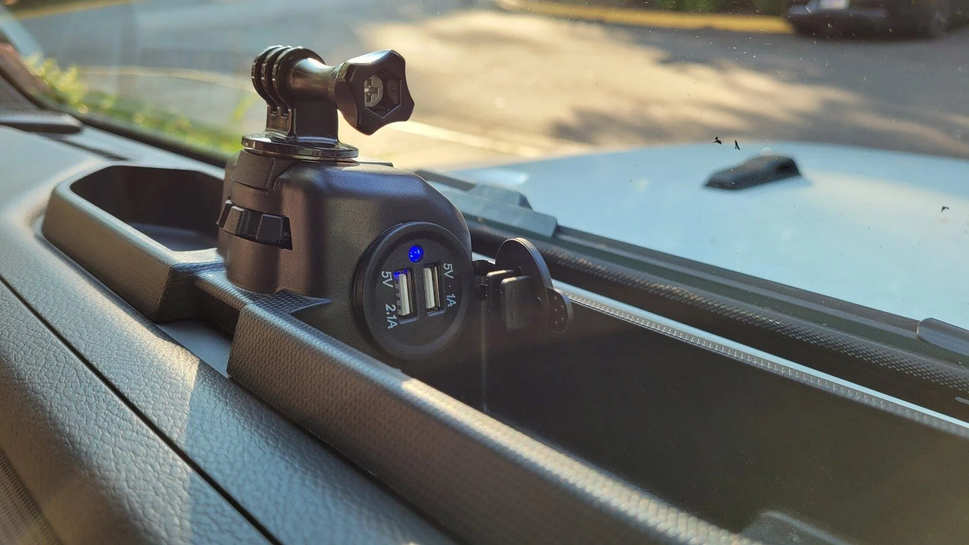

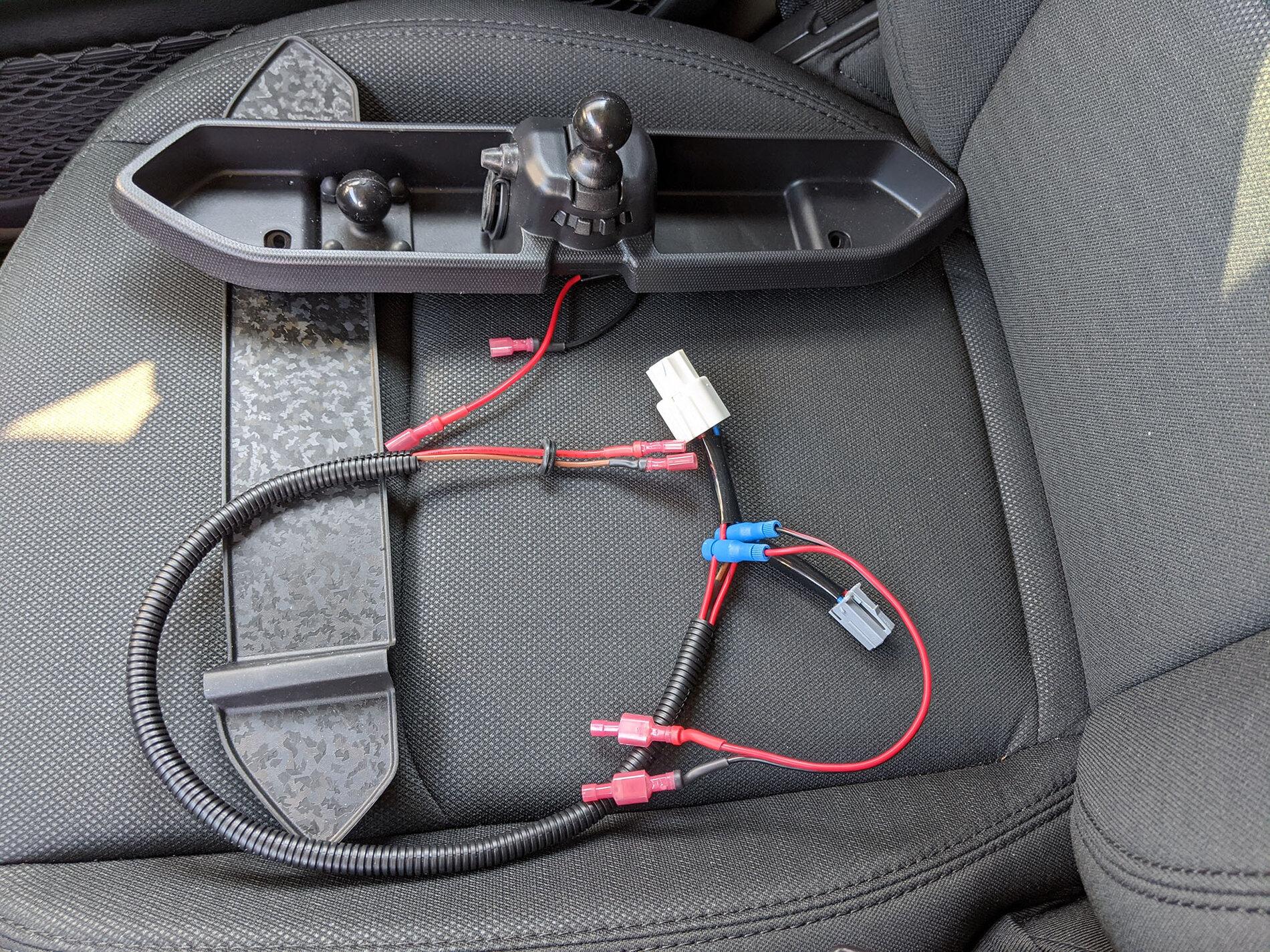

Here's what I did. I used the quadratec cable to feed a switched usb power port mounted above the dash in my Rugged Ridge phone mount. I also tapped into the power wires for the possible future addition of USB power ports for the back seat of my sport. If I was going to do it over, I would skip the quadratec cable and just tap into the power wires for both the above dash and back seat USB ports.

But again, my point was PURELY wanting to extend the cable that runs to the 12 volt outlet - so I could move the outlet and re-install it. Don't need the other stuff.
So if I could buy the ends, I would, but I'll likely end up buying that cable so I can get the ends and make an extension for the 12 volt outlet.
So if you want to get rid of those connectors/ends - LOL
My goal is ONLY to move and reinstall the outlet.
40,463
53,908
Bought the cable on Amazon - free shipping so saved a couple of bucks or so.
I did end up leaving the "tap" they had, but did what I needed by extending a couple of the wires and wrapped it up again. So now I have an extension, unlikely I'd ever use the tap they put in but no biggy, it will just be tucked away back there.
Now I can move that 12 volt outlet to where-ever it will fit or work and use this as the extension to get it there.

This may be a long shot but what balls are you using @jebiruph I have this same mount that I got this weekend.

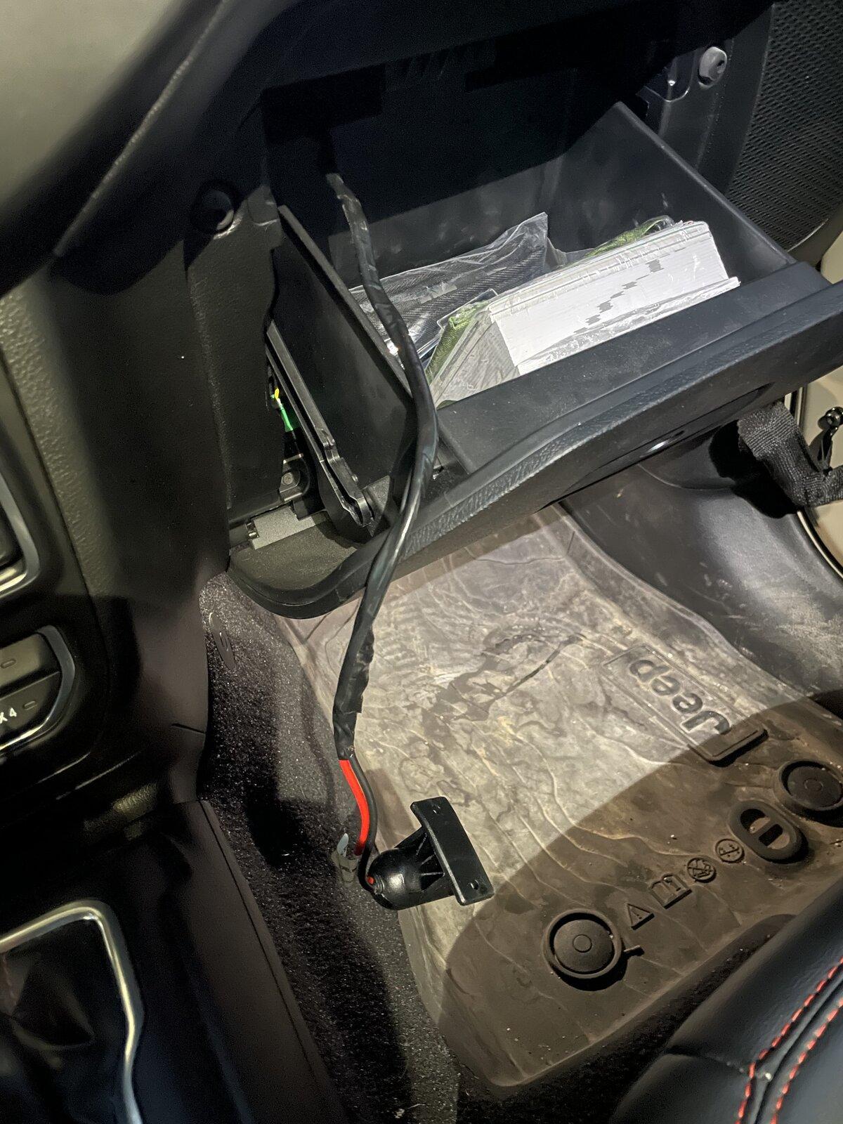

For my specific need I was after a 12v outlet that stays hot while ignition off to power my blue ox supplemental brake when being towed.
I used the aux switched and pigtail under glove box and added another outlet. Was going to dash mount but hate drilling dash so I just made it on a pigtail that I keep in dash until needed. Turning on or off with aux switch.
