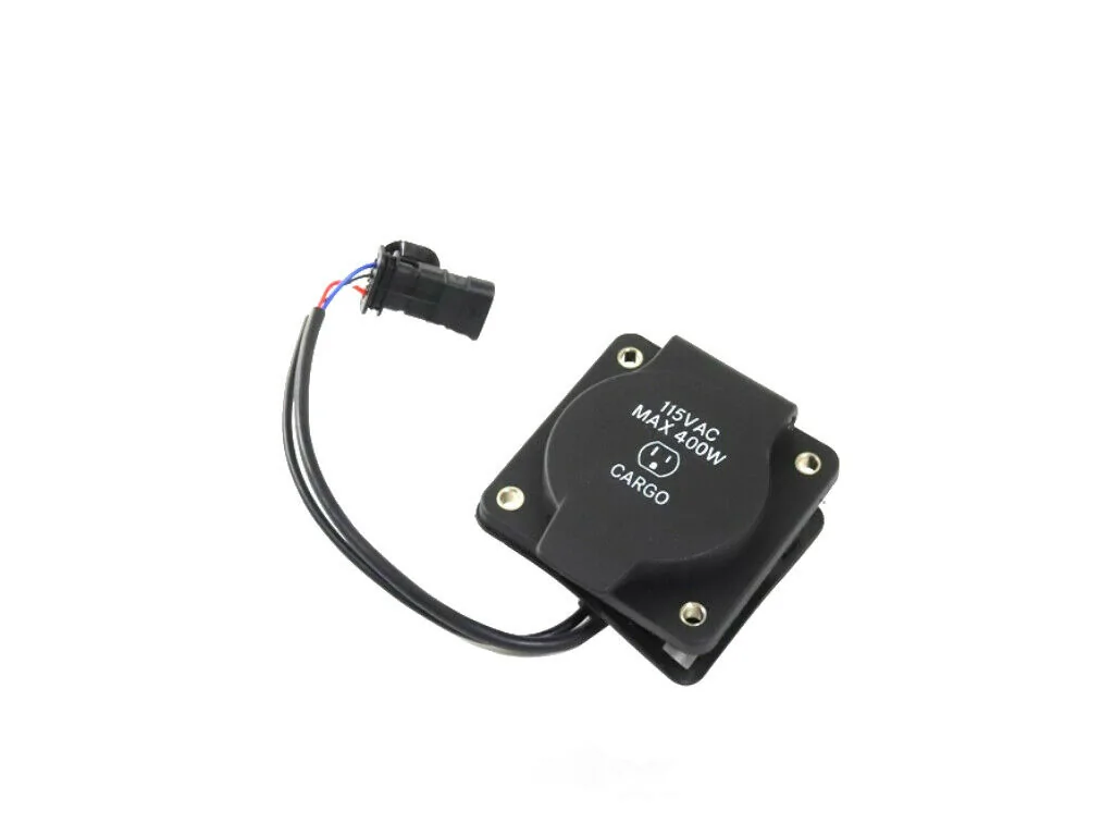

Anyone know where to get the male connector side for this 68312754AC?
I'd like to just splice an extension cord to a male side connector and connect the mopar bed outlet to that extension cord. I would just plug the extension cord plug into outlet that's behind the center console when I want bed power.
Thanks
Is it me or are those wires looking mighty skinny for the purpose ?
