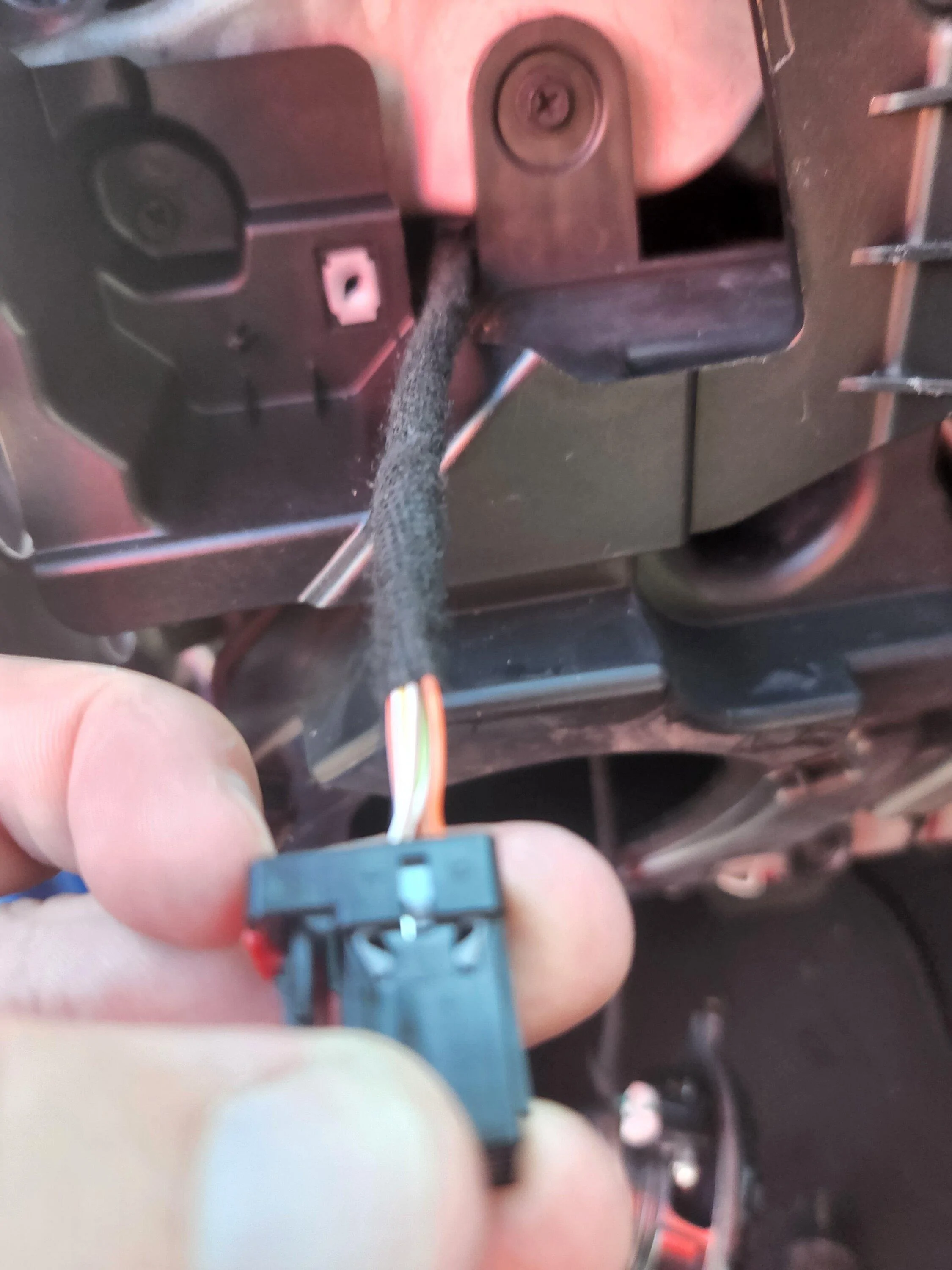

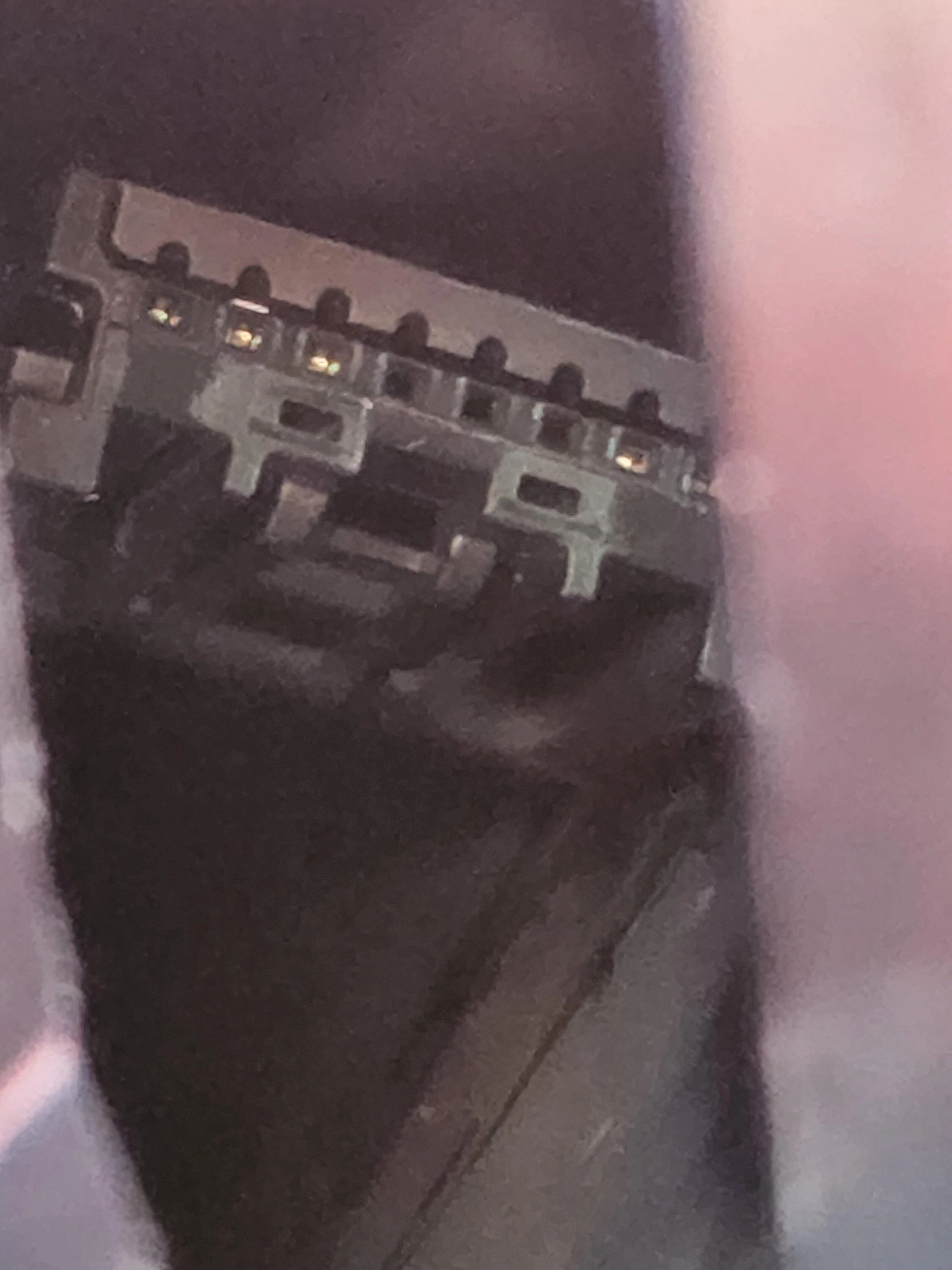

Drivers side, see below for what it should look like, once I pulled the speaker and housing I was able to access it better
Jeep Gladiator Question about adding outlet to bed 20220831_160605
Jeep Gladiator Question about adding outlet to bed 20220831_152724

Got it. I’ll start taking it a part. Thank you
Follow the headlight cables all the way to the back to find it, but it should be there.

Found it!!! I ended up taking out the speaker box to find it taped to the light wire.
Thanks for all the help
