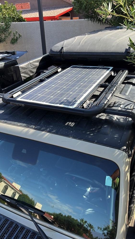

@Geoff Massa These last few posts bring up an interesting discussion; if your true goal is overlanding, then I would posit that a hard top is essential.
If you are making the long haul to the Mojave Road or some other cool destination from the Bay Area, you probably aren't going to want the road noise of the soft top over the hard top. It's also likely you won't be taking your doors off along the way. I've been overlanding for years and not wished that I could take the top and/or doors off while I was off grid.
Another thought is that, if overlanding, you might find the need to have the extra storage space provided from a roof rack. While not impossible to find, there are more options for roof racks with a hard top than soft.
My rig for example, I have a canopy with a roof top tent installed and as my need evolved to add a solar panel, my RTT's contoured top did not really allow for it to be mounted there. However, a simple gutter-mounted Rhino Rack (because the solar panel weighs next to nothing) made it easy. Had I been running a soft top, it would have been more challenging...
