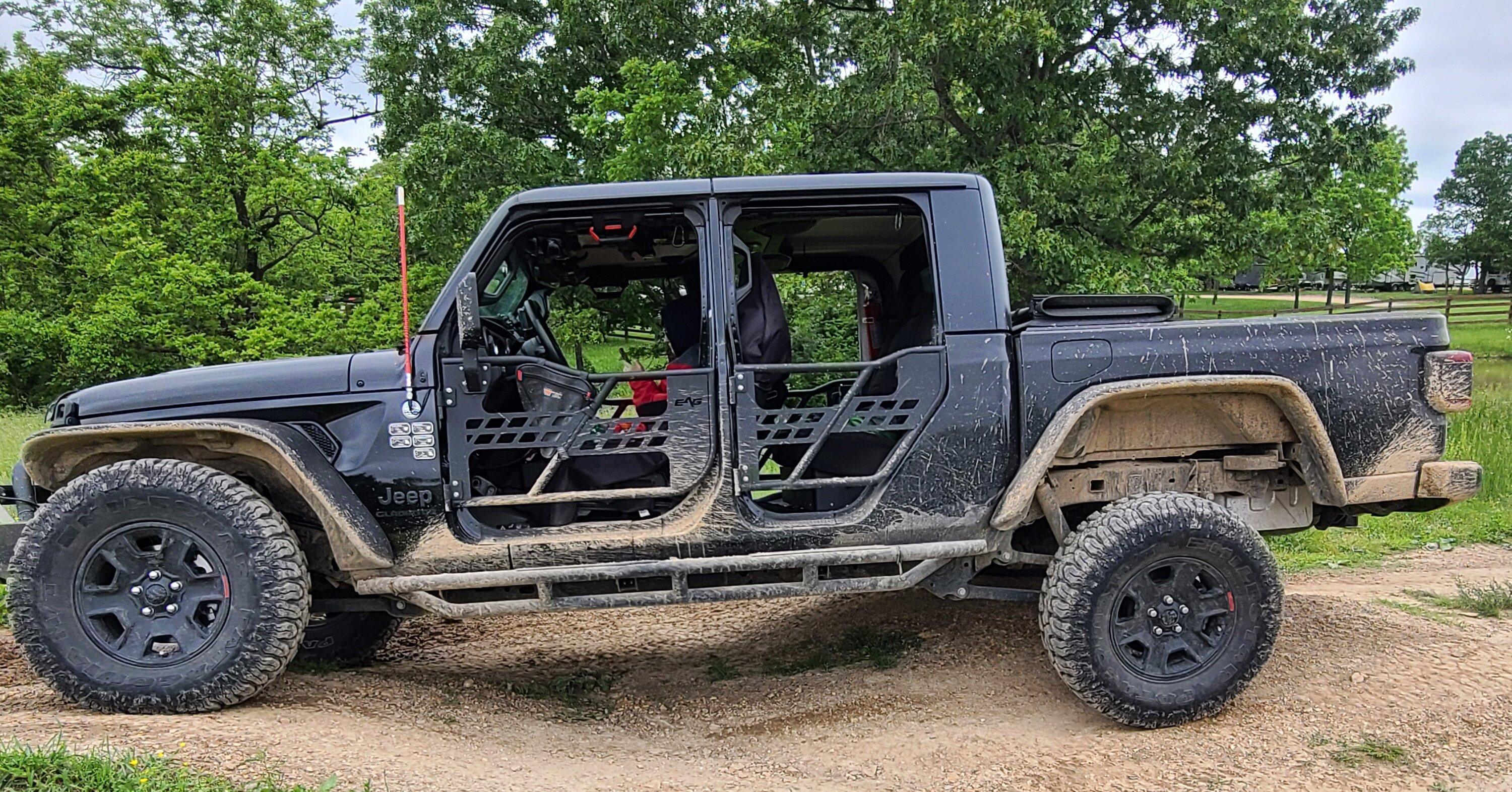

It really depends... the Rubicon offers more than just lockers. It has a 4:1 low range in the transfer case that you will not get. It has approx 1 more inch of ground clearance, that when coupled with leveling spacers will allow for 35's with very slight, if any, rubbing. You get the electric disconnects on the sway bar. And there is the Offroad plus mapping for the driveline.
You can run 35s on a max tow with no lift, and ZERO rub. Just do a set of flat fenders. I ran both badge trails at SMORR with that setup and never rubbed.
Ok... show pics of the sway bar and lower control arm on both sides too. But more to the point, I could undoubtedly fit 40's if I removed the flares altogether... and what did your flat fenders cost...
