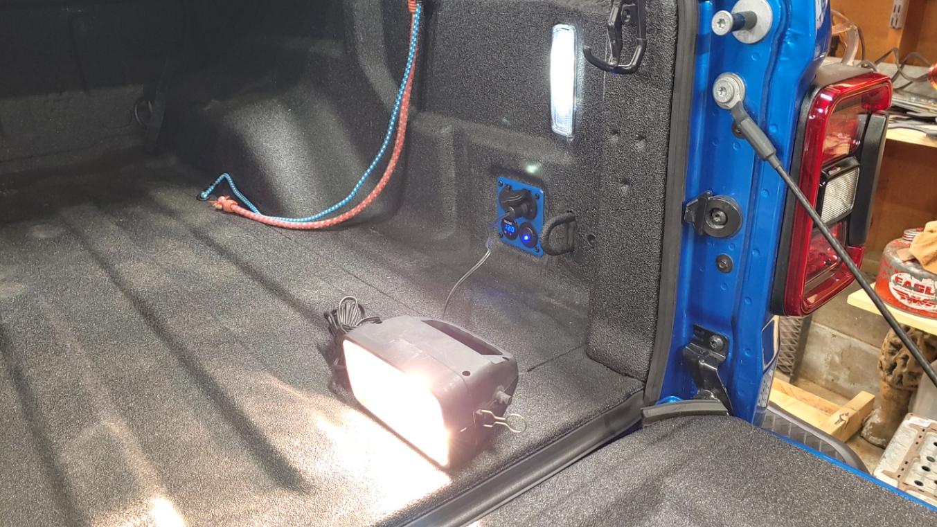

Aux 3 - KC HiLites LED ProSport 6"
Jeep Gladiator Factory Aux Switches: What do you have yours connected to? I8kBIwih
Aux 4 - KC HiLites LED LZR 4"
Jeep Gladiator Factory Aux Switches: What do you have yours connected to? Jc3qVu8h
Aux 2 - Midland MXT275 GMRS Radio
Jeep Gladiator Factory Aux Switches: What do you have yours connected to? tektGtXh

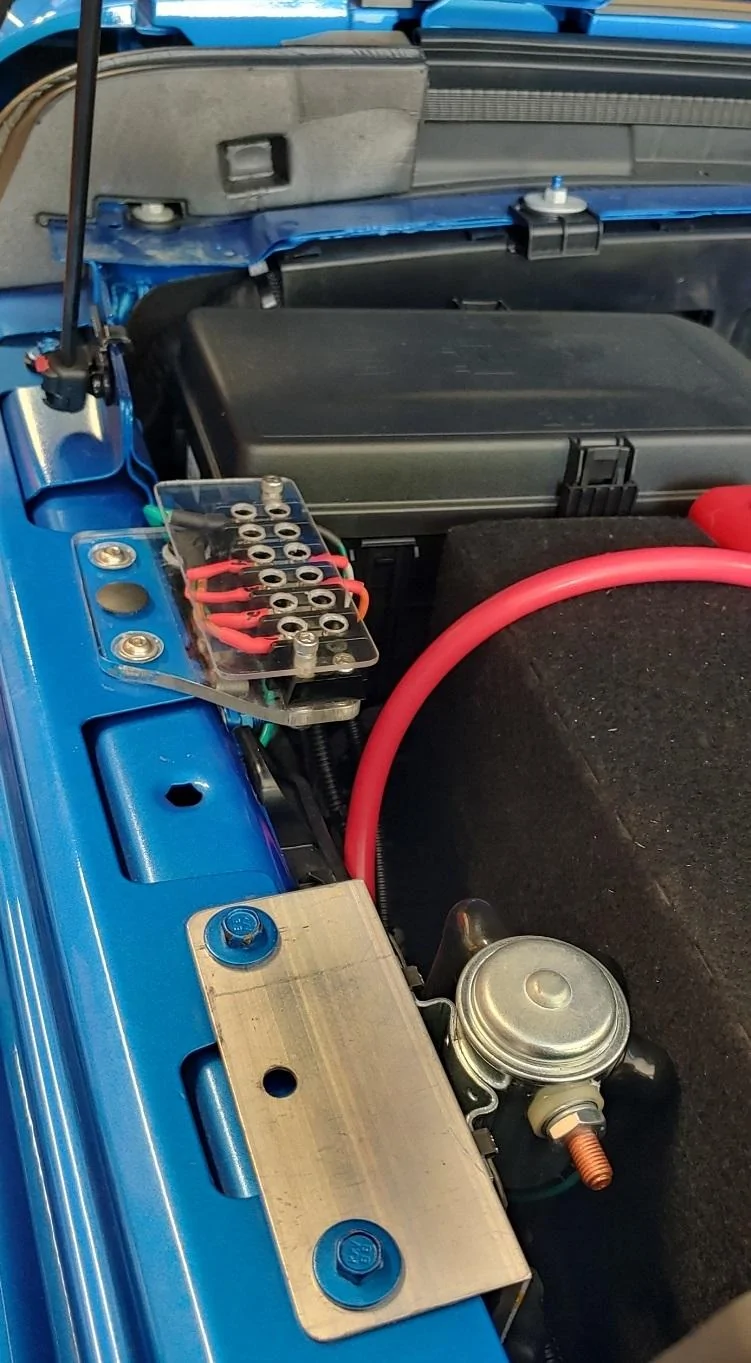

All of it ran to a JL Badgeglow aux board
Jeep Gladiator Factory Aux Switches: What do you have yours connected to? fTqDhMph
