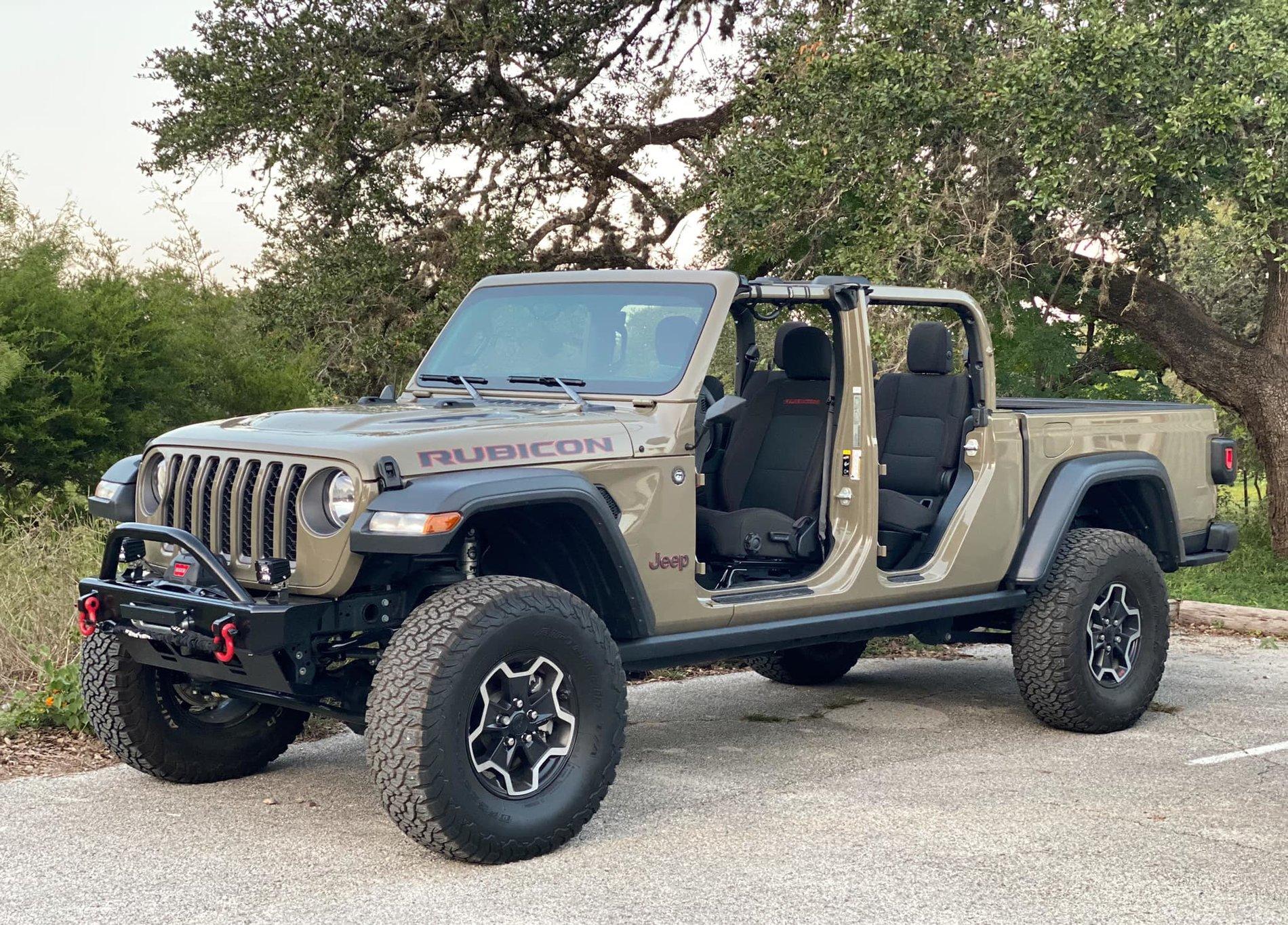

First time Jeep owner here but agree with you about how easy they have made it to go naked. Took everything off this weekend and got way more compliments than I ever do with doors and top on lol.
I bought these door hinge pin guides. They are a low cost solution to removing the doors. I basically added these and got rid if the door bolts.
https://www.amazon.com/gp/aw/d/B085T31Q5D?psc=1&ref=ppx_pop_mob_b_asin_title
Deleted member 24880
took my doors off this weekend and agree it’s not very hard. Now tonight when I put them back on that was a different story. I fought those damn bolt/screws/bushings that hold the doors on like crazy. Managed to get 7 of the 8 tight and flush with the hinge but the one was damn bitch. I tried it on multiple different pins and it seemed to get stuck every time it got to the thicker neck area of the bushing. I managed to get it where I’m satisfied but ended up scratching the paint a tad. Do I even need those damn thing? Any door rattle with the pin guides listed above? Thanks!!!

I had my door bolts off week two that I had her and they aren’t going back on. I got some door pin guides that need to go on. No rattling and I can have all four doors off in about 5 minutes if I want. Using a little impact with the door stop speeds everything up quite a bit.
rcwhat
May 23, 2021
MA
21 Mojave
You don’t need to re-attach the door stop if you’re using the fabric straps as well. I leave my unbolted and pushed into the door. Only thing I need to do is unplug the electrical connector and unhook the door strap. Boom, 15seconds and the door is off.
