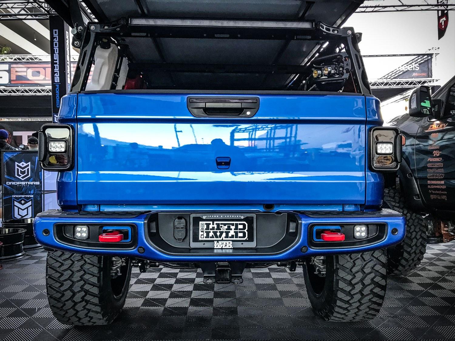

@salsadoc has them and they're BRIGHT
Jeep Gladiator Flush mount lights rear bumper a224bdc7-2d01-481e-96bd-867d120960e2-jpeg

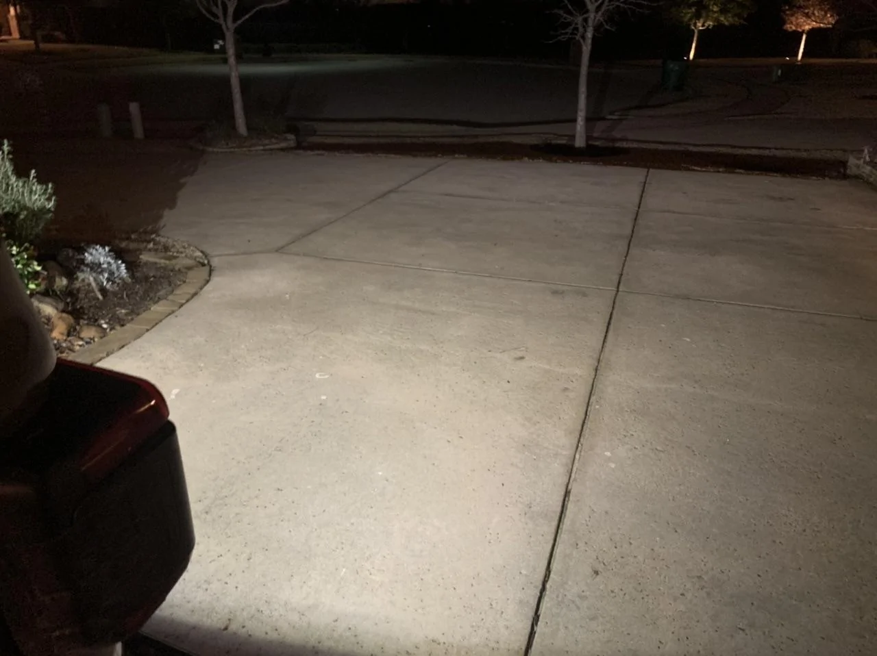

@salsadoc also has them, his photo below.
Jeep Gladiator Flush mount lights rear bumper 26c5728d-2a93-48ff-8252-5f53718c10e6-jpeg

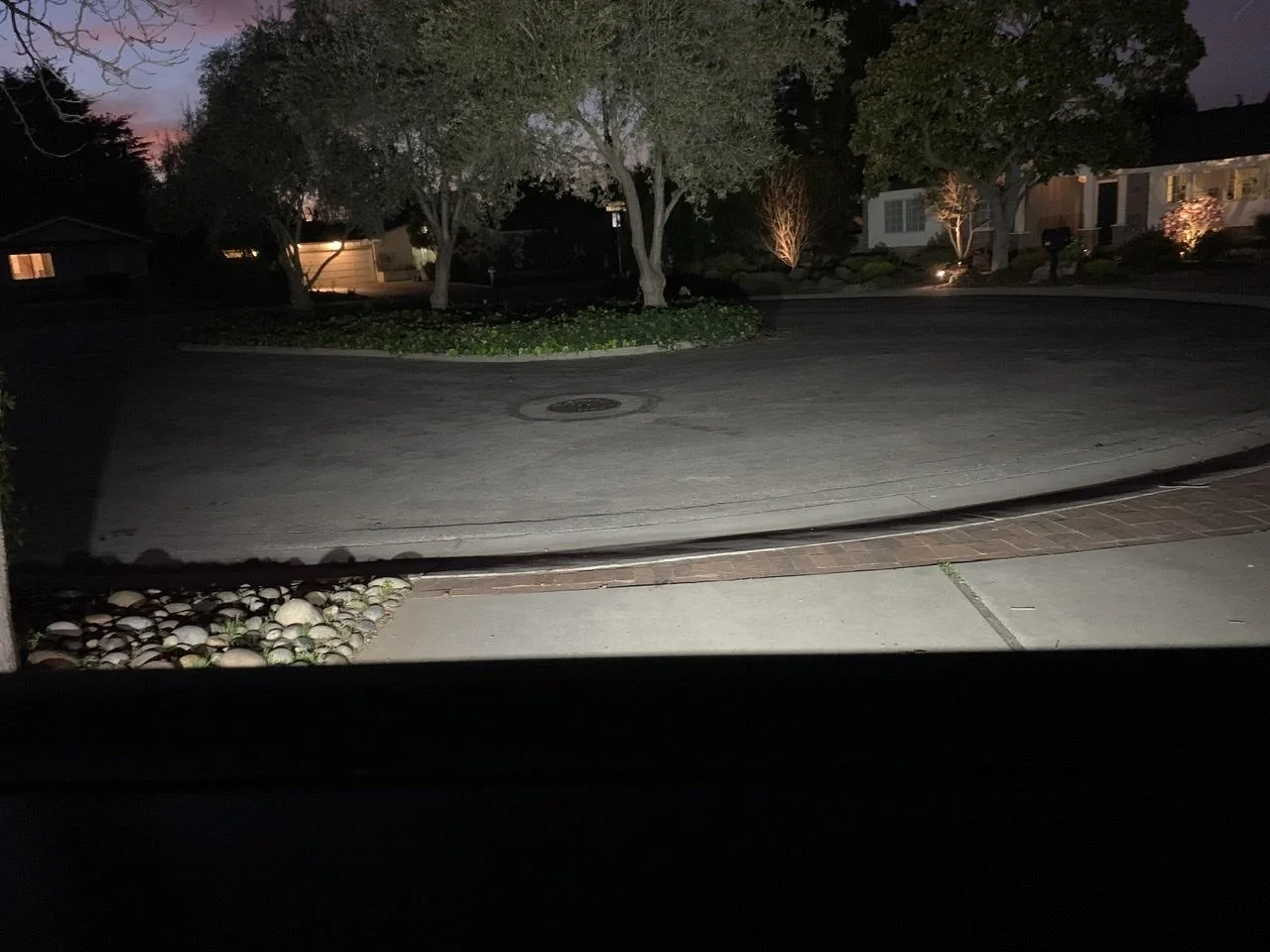

The rigid Industries Ignight bulbs are 60deg flood are 1000lumens/light and 1A draw, no mounting plate and cost $127 IP68 RATED
https://www.amazon.com/Rigid-Indust...&pd_rd_r=f8edf2f5-fbac-4a3e-979f-ecae86eb141c
@mazeppa has these, said he would buy a less expensive Amazon light if he did this again, but also said "The Rigid Ignite I have are bright enough to aid the night vision while backing up without being too obnoxious to other vehicles."
Photo provided by @fonzie who has the rigid lights too.
Jeep Gladiator Flush mount lights rear bumper 27d75be5-7bd0-428f-8603-d86ab9edb14d-jpeg

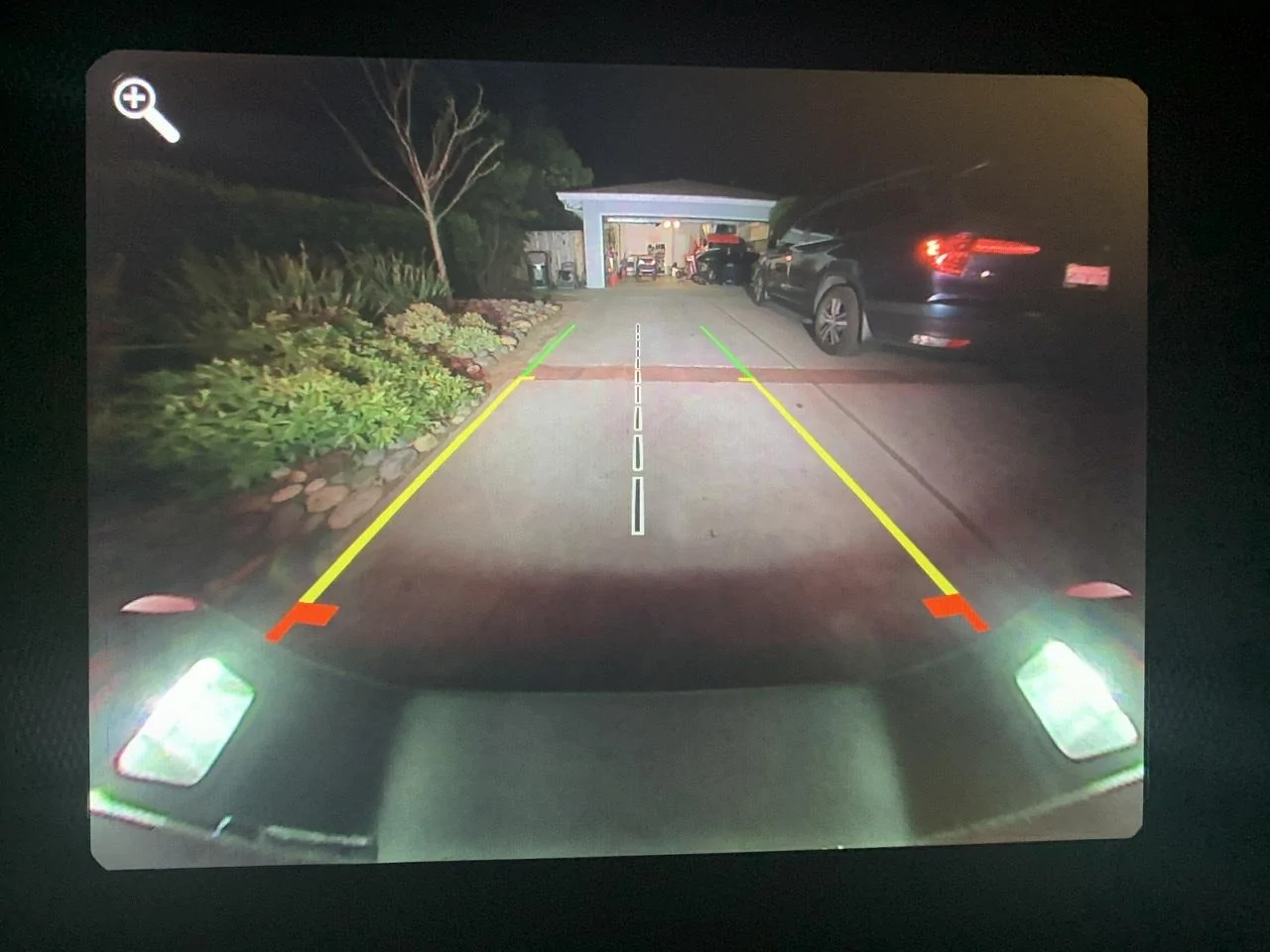

Did this help your backup camera any? The license plate lights appear to blind the camera. maybe these help.
I watched 2-3 rigid ignight backup light JK wrangler reviews. Yours appears to throw out more light.
these help the backup camera a lot. i’ll try and upload a photo later tonight
