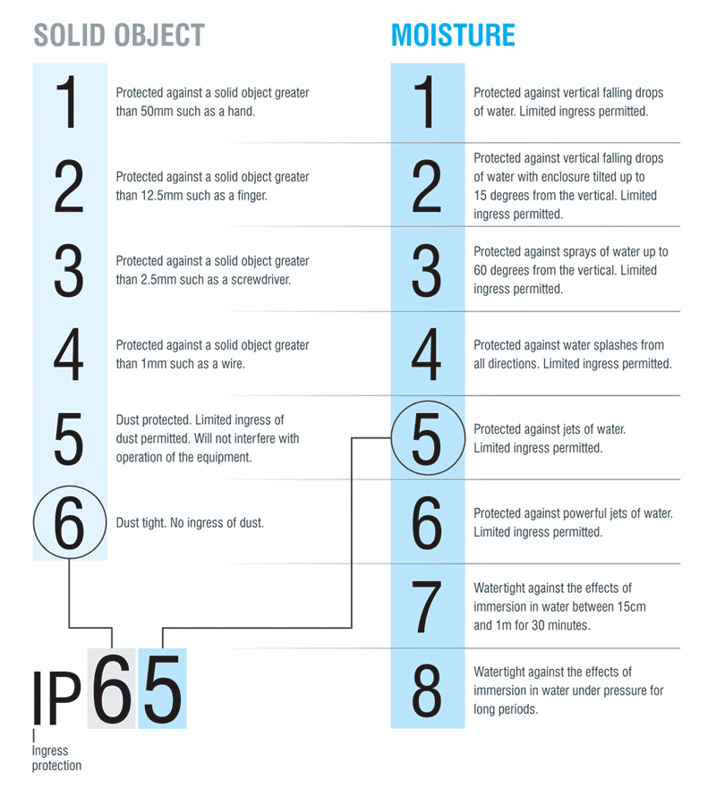

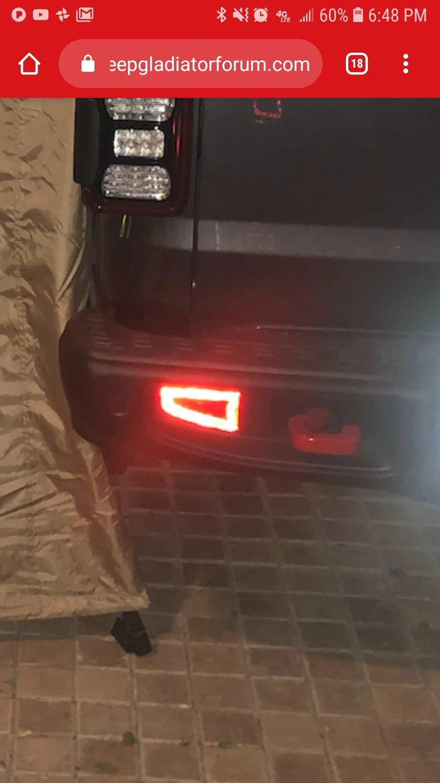

@steffen - great job consolidating all the different lights into one post. Additionally, another very important characteristic to consider is what level or degree of water intrusion each light is tested to (IP Code or International Protection Rating). As an example the EBESTauto lights have a IP 67 water proofing rating. Maybe you could add that to you your comparisons. I will try to get a night time picture as well.

also Rigid's is IP68 rated. is ip68 better than ip67?
EDIT: "To recap: IP67 means the unit can be dropped into a body of water up to a meter deep for half an hour, while IP68 guarantees protection in water up to 1.5m deep for the same period of time. Both are resistant to dust."
https://www.trustedreviews.com/opinion/what-is-ip68-ip-ratings-explained-2947135

I am assuming the larger the number the better the moisture protection.
Jeep Gladiator Flush mount lights rear bumper ip-rating-guide
IP11 RATING!........why would anybody advertise that? lol

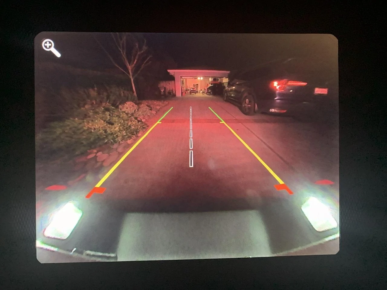

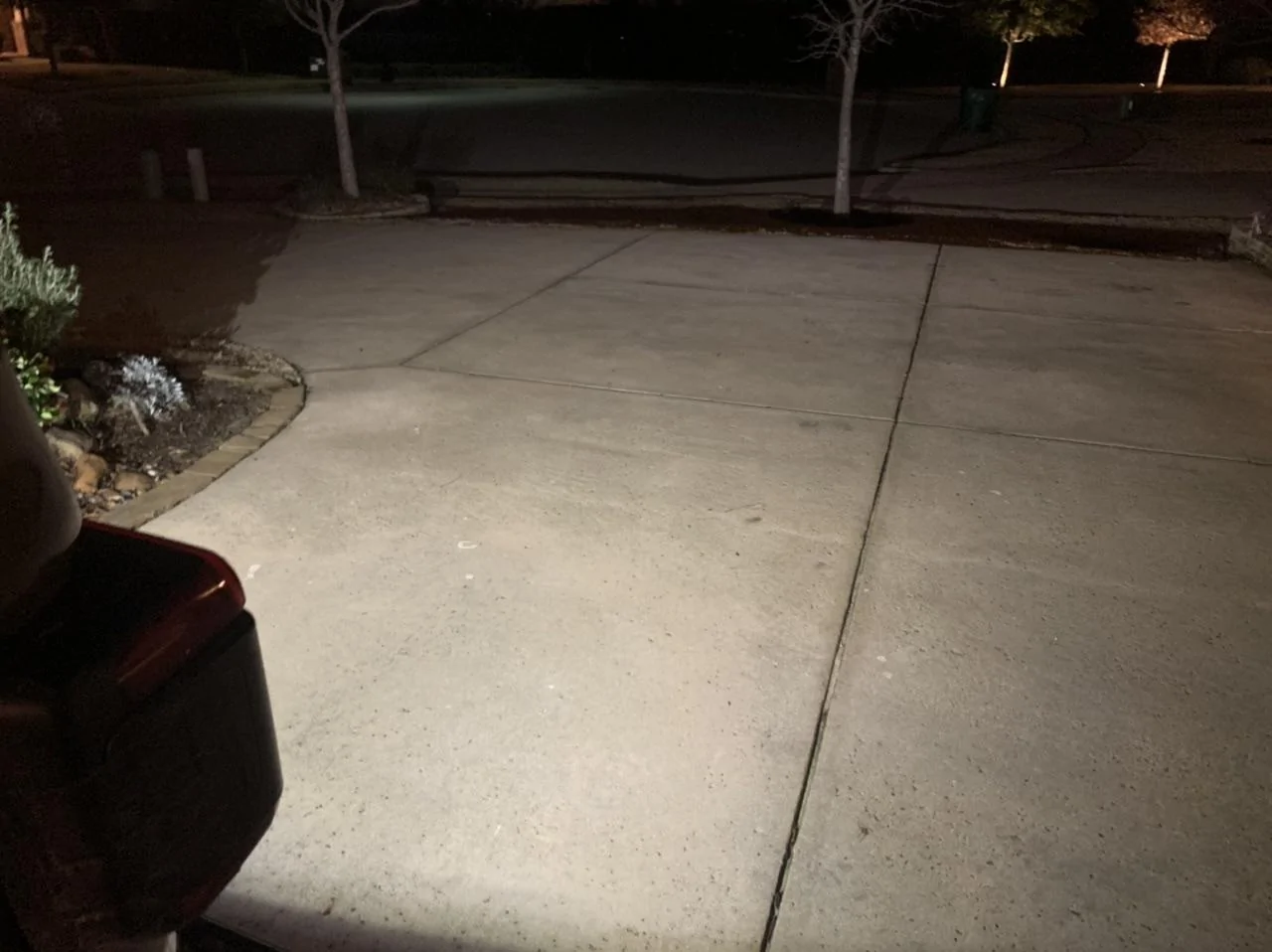

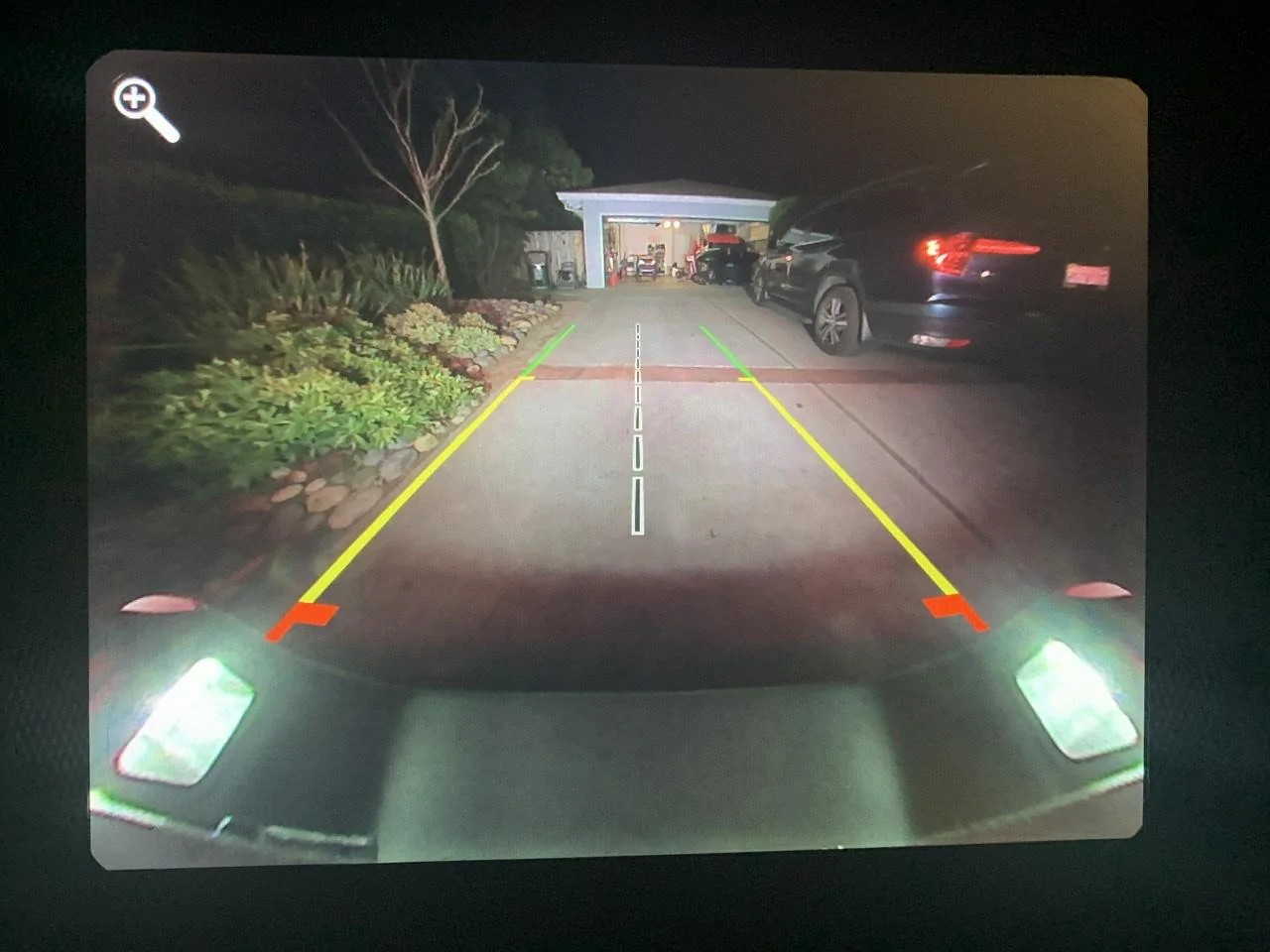

Might have missed it but did you post a picture of them at night?
sorry here’s a night photo. i think the vision x lights are amazing. hope this helps
Jeep Gladiator Flush mount lights rear bumper 47DF616E-38D6-4848-838C-06AB86B07923
Jeep Gladiator Flush mount lights rear bumper 26C5728D-2A93-48FF-8252-5F53718C10E6
