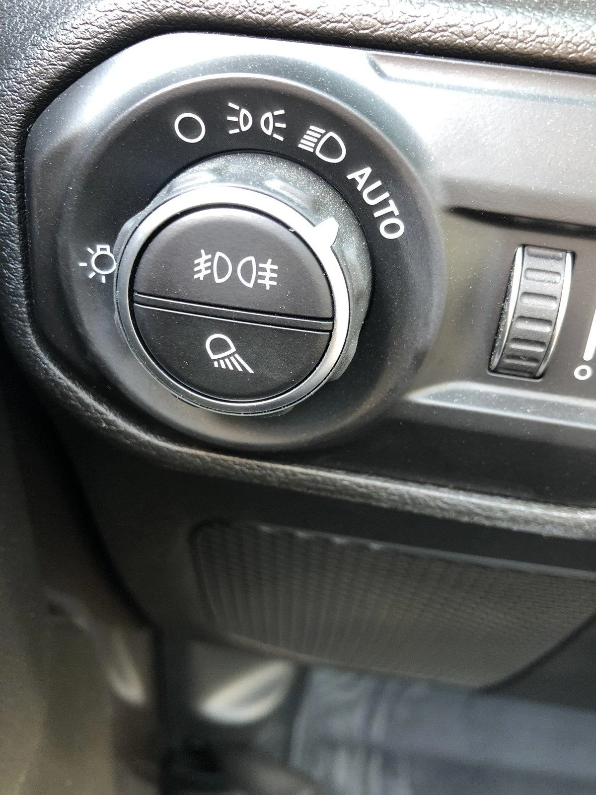

Here is the switch and the light in day light
Is it a rocker switch so you can turn on front and rear independently? Or only both at once?
This is definitely a mod I'd like to have. It's factory, but not standard issue.
For the upper half:
1. Press once front fogs
2. Press again rear fogs
3. Press 3rd time rears off
4. Press 4th time fronts off
5. Repeat
Lower half I think for interior ambient and truck bed...

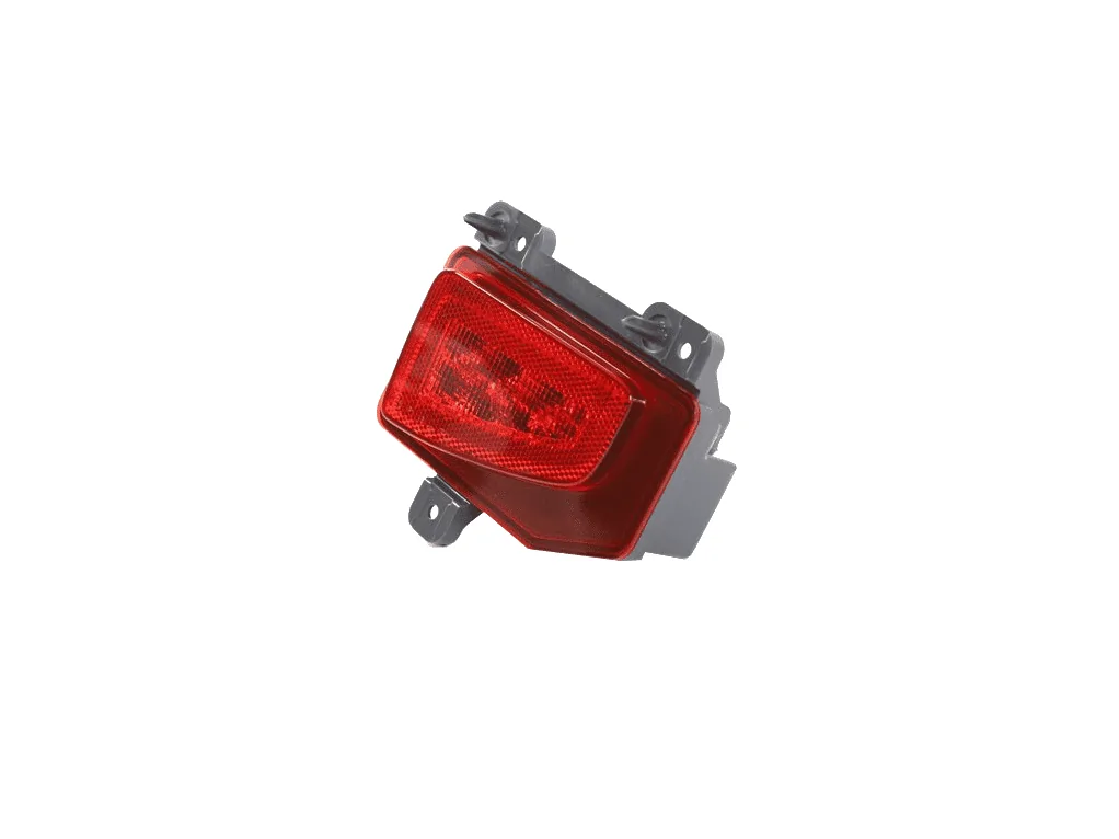

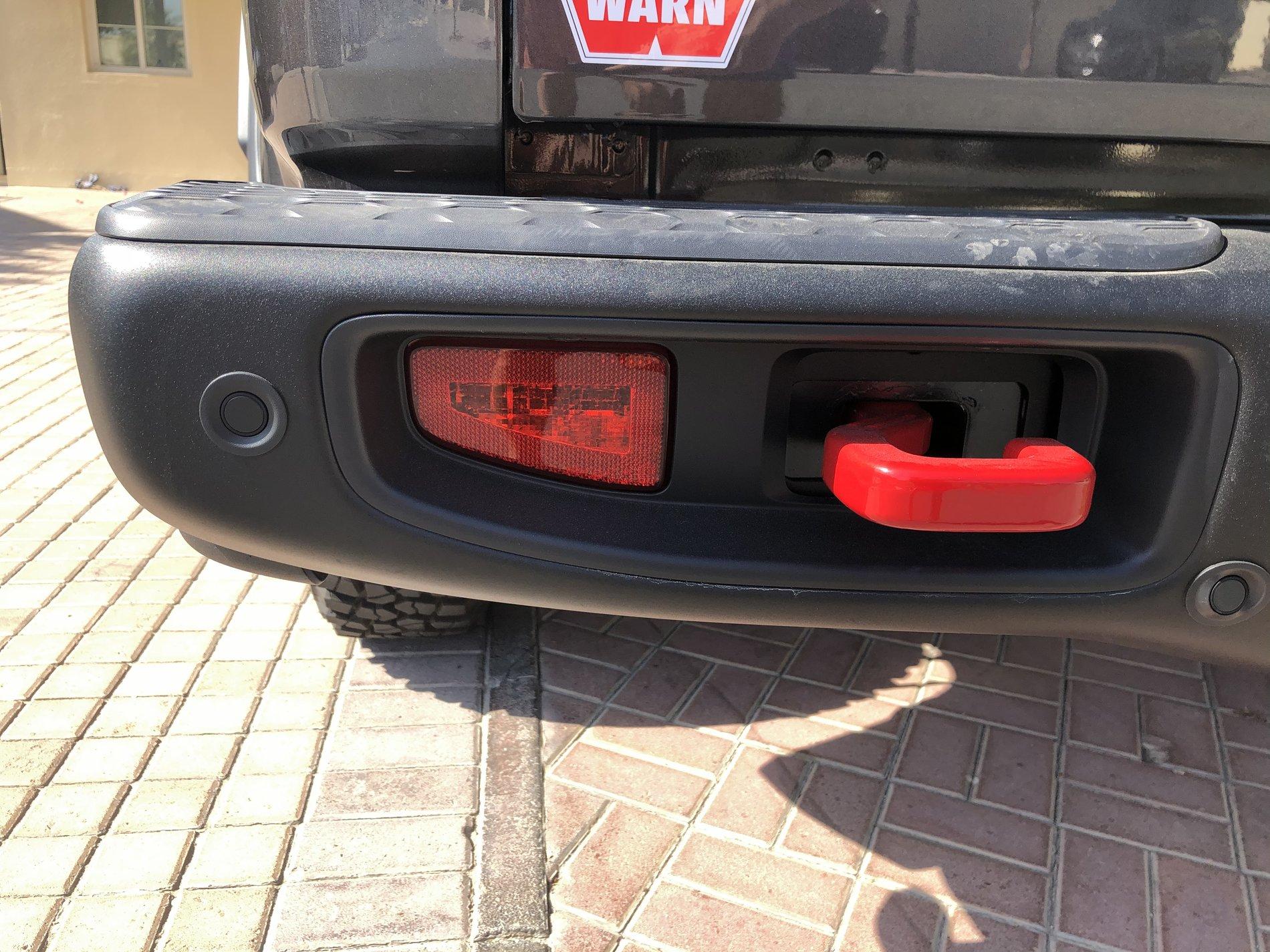

@DiscoDino is the rear light housing all reverse lights or amber or red LEDs for brake and turn signals?
Rear tail lights are Tail, stop, reverse and on the outside yellow led thin line for turn

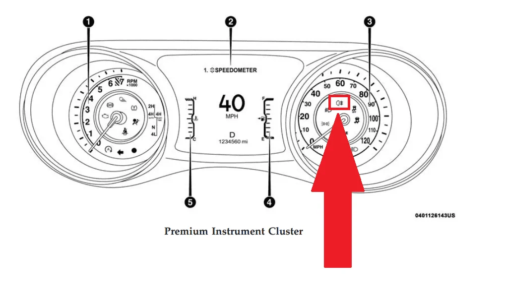

Does the dash have a display icon for the rear fogs on?
Please post a picture.
If you could do a video of these in action that would be great! Surprised they have different LED taillights for export.

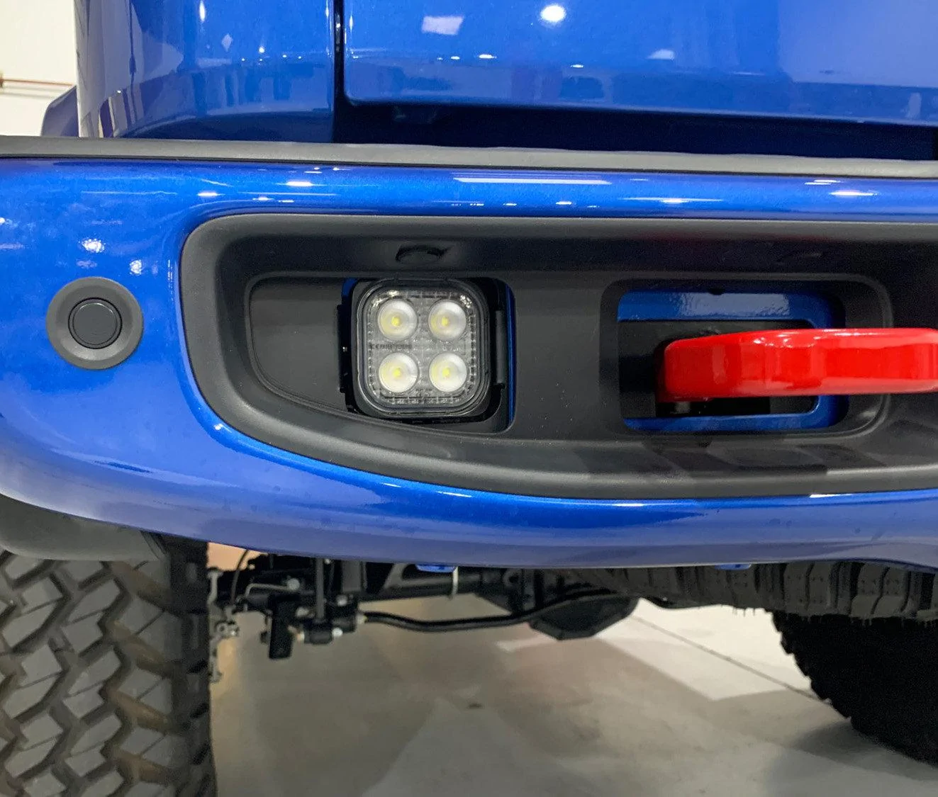

Just ordered these. I'll install them and hopefully soon there will be an answer for the harness to order to make them work for US configured JT's. Nothing like putting the cart before the horse, but damn these look awesome.
Jeep Gladiator Flush mount lights rear bumper upload_2020-3-7_5-48-59
I was planning on ordering one to play with, but you beat me to it. I’m still working with @AllMoparParts.com to figure out the rear fog interior controls and harness. I’ll report back if we can figure it out.
Yes. And our dashes should, too. I’ll have to run out to the truck to confirm, but ours should be in place.
