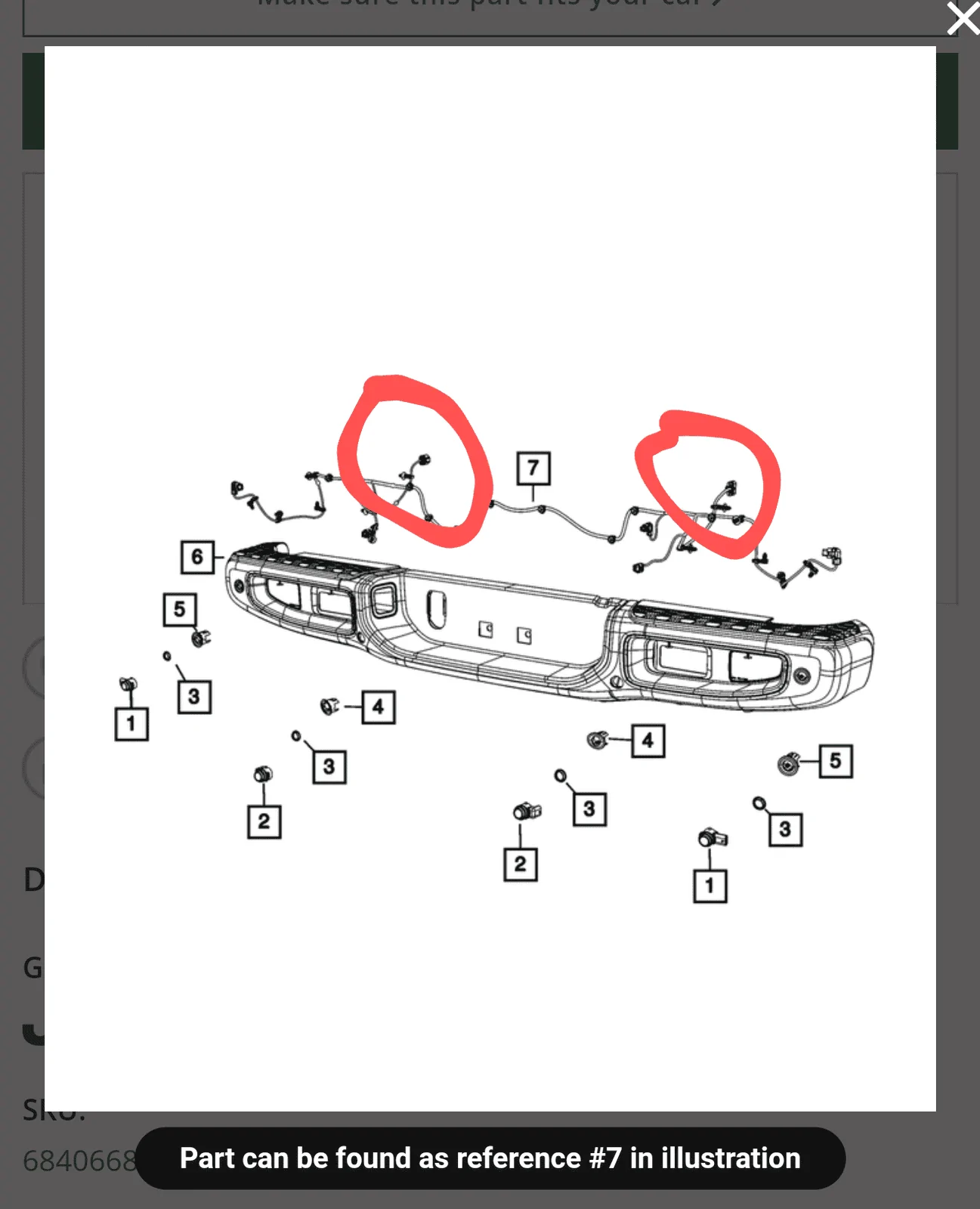

Crawling around under my Sport S, there's multiple harness connectors at the back left starting with a junction right at the rear left wheel, then a short connector to the back corner which then branches to the tailgate, bed lights, taillights and bumper, but for my bumper, only two lines go that route. One for the 4/7 pin connector, and the second for the licence plate lights. I don't have the parking sensors, and would have to see if one is available without them in the harness. It seems pretty modular and the first harness may determine which secondary ones will fit depending on options like LED, lane assist sensors and parking sensors.

Main difference I can see is the 4/7 pin trailer harness seems to be on the same side whereas the JL feeds from both sides

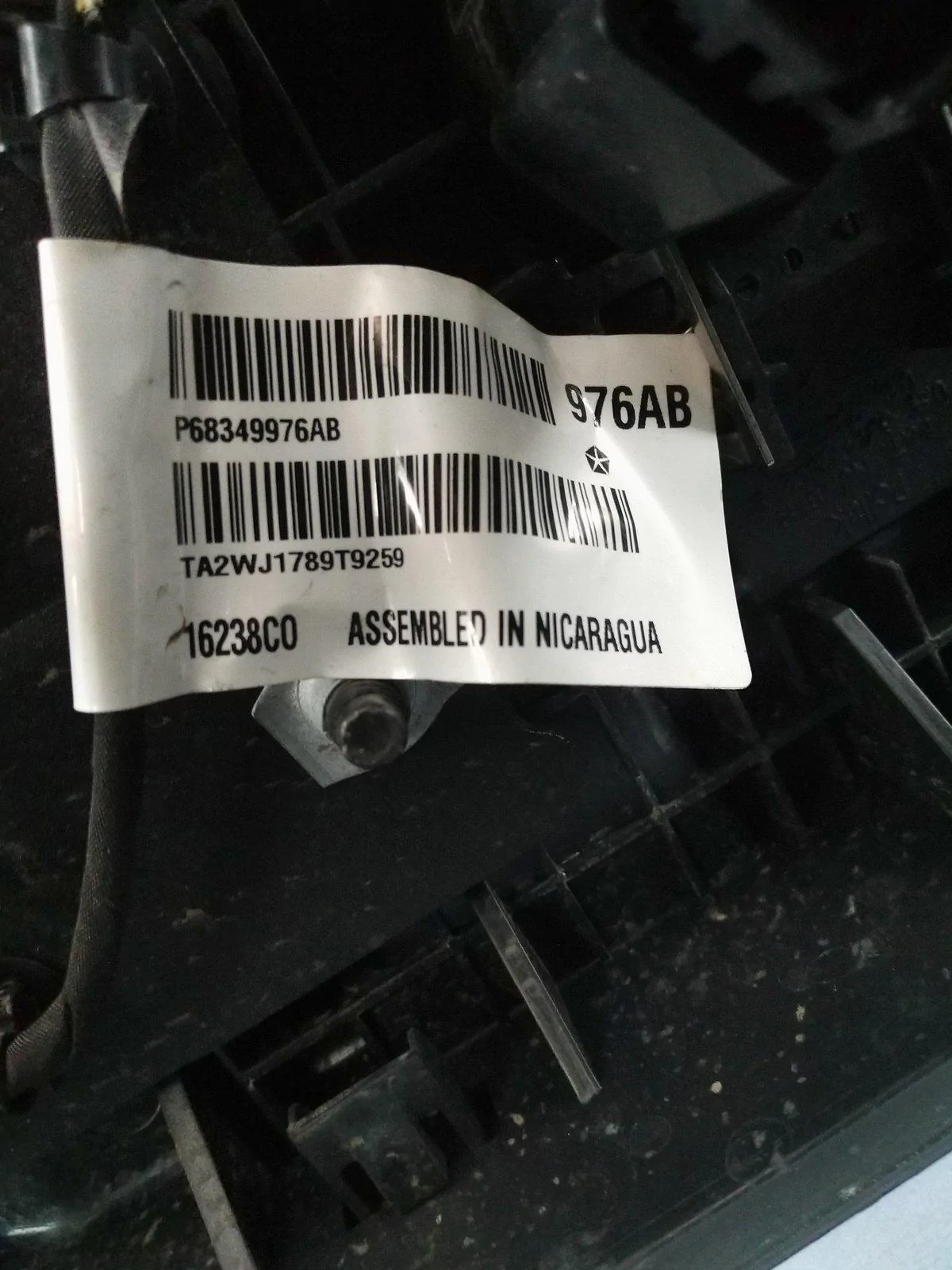

@AllMoparParts.com , can you determine which version of #2 is needed for the fog light connectors?
Wiring is probably 1 of the many part number 2s.
It's definitely not the last one as that is what's currently on my JT, with no pigtails for fog lights.
Jeep Gladiator Flush mount lights rear bumper IMG_20200307_164018

@DiscoDino can you check the tag on your bumper wiring harness, it'll be near the left frame rail bumper mounting bracket. That would give us a better idea what we're looking for and needing. It'll look like below but upside down, I rotated this one.

Do you have blank connectors where the pigtails could be attached? Or would a whole new harness (item 2) be needed?
I haven't taken that connector apart to check it, but the plug looks to be the same as what's in a previous post, so the spaces would be there to add pins.
