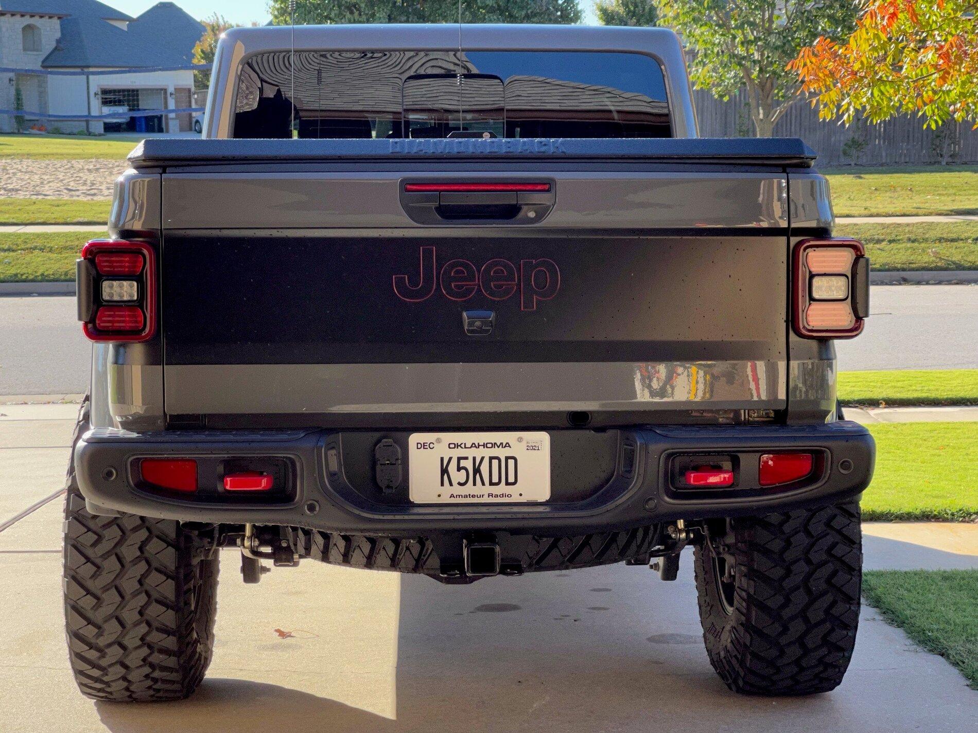

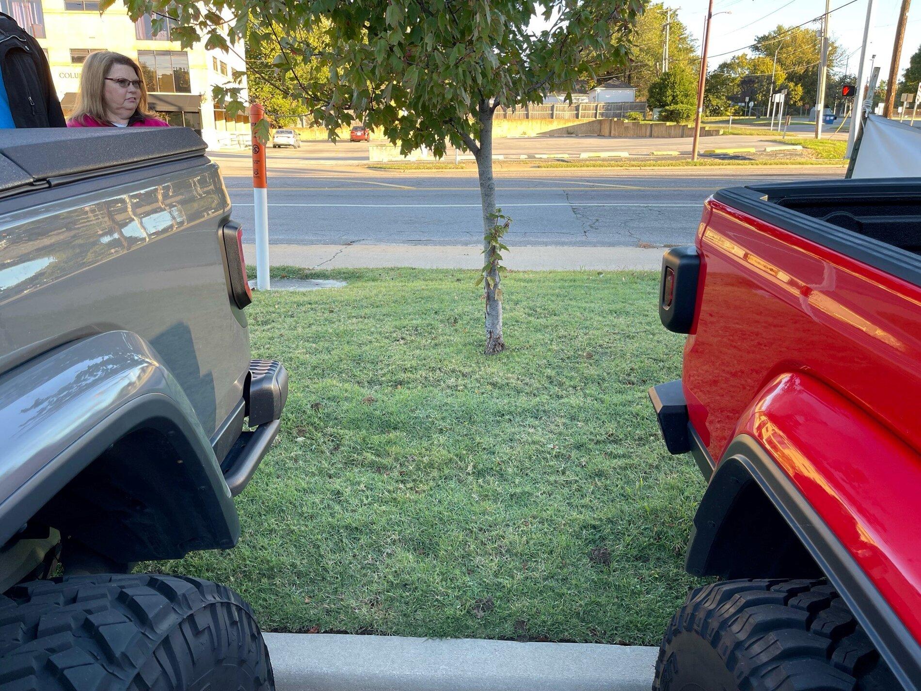

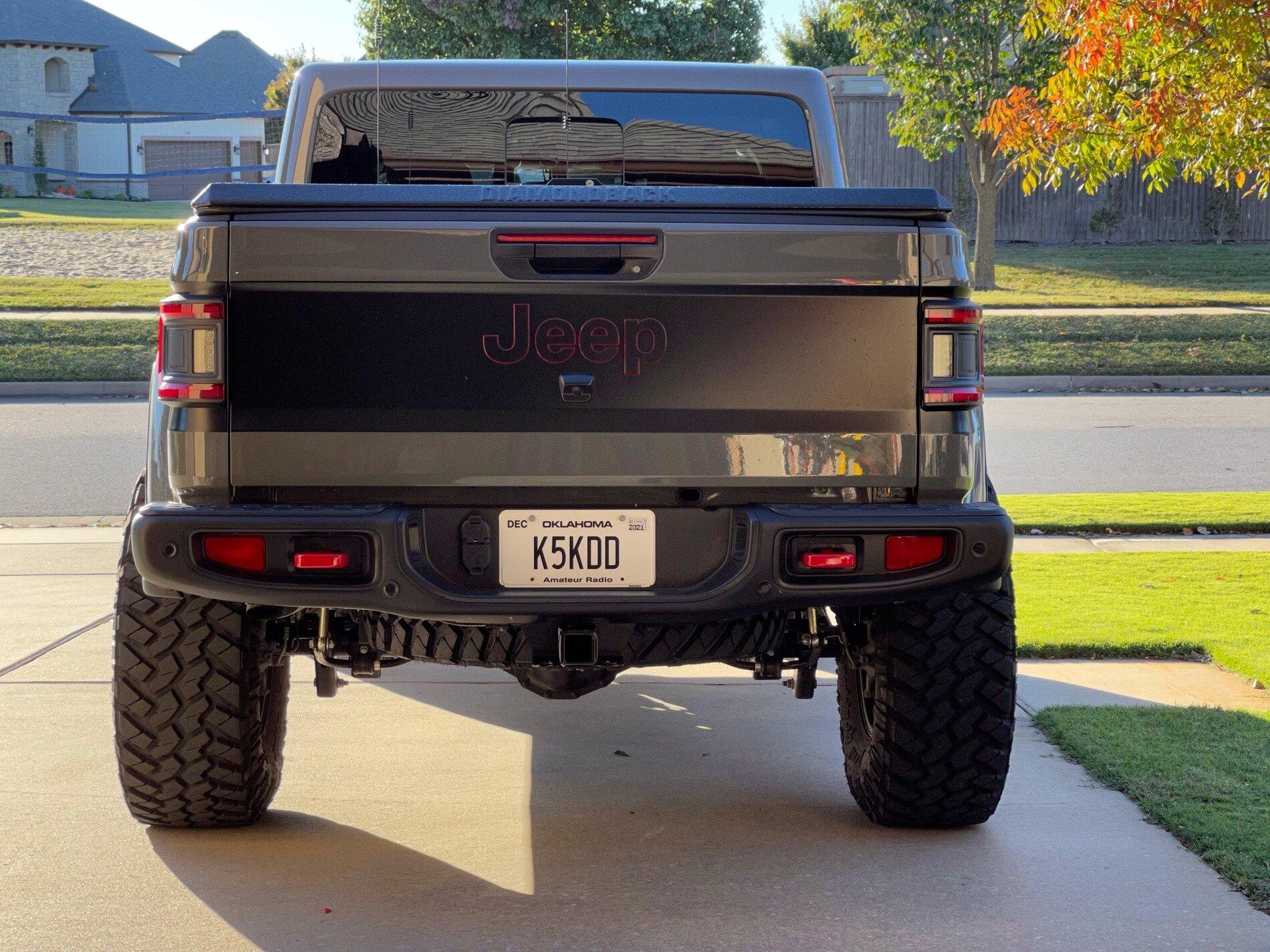

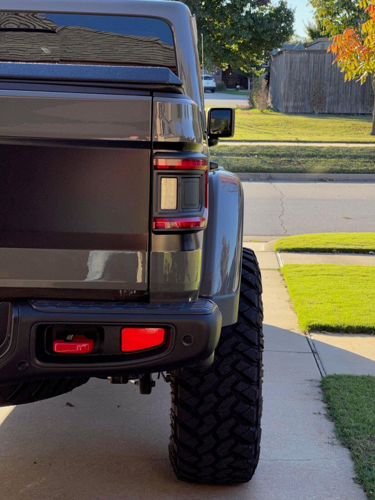

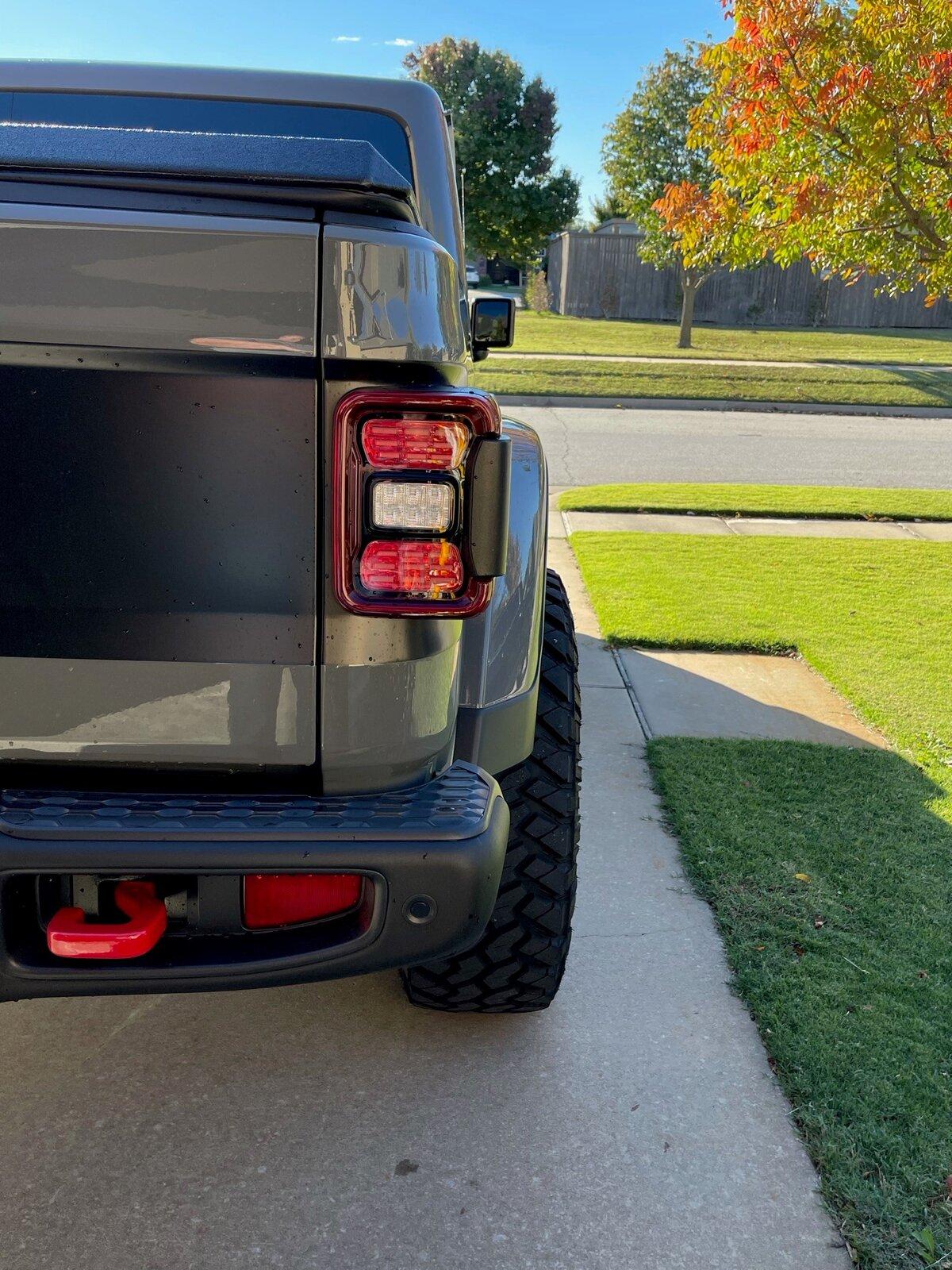

I received mine and have them installed (including the BSM) and no issues so far. Love the look and the backup light brightness is outstanding. The regular lights seem to be a bit brighter than factory as well. I'll throw my before and after pics on the pile here as well. I did not have any fitment issues.
Before
After
From the sides
I was parked next to a buddy of mine and he has the stock tail lights. Easy to see the comparison on how they stick out.
After seeing these comparisons, I actually think the OEM ones look better. The style, size & shape fit the truck better.
Just my opinion though.
Thoigh the ”flush” mount ones are probably better for off road.
