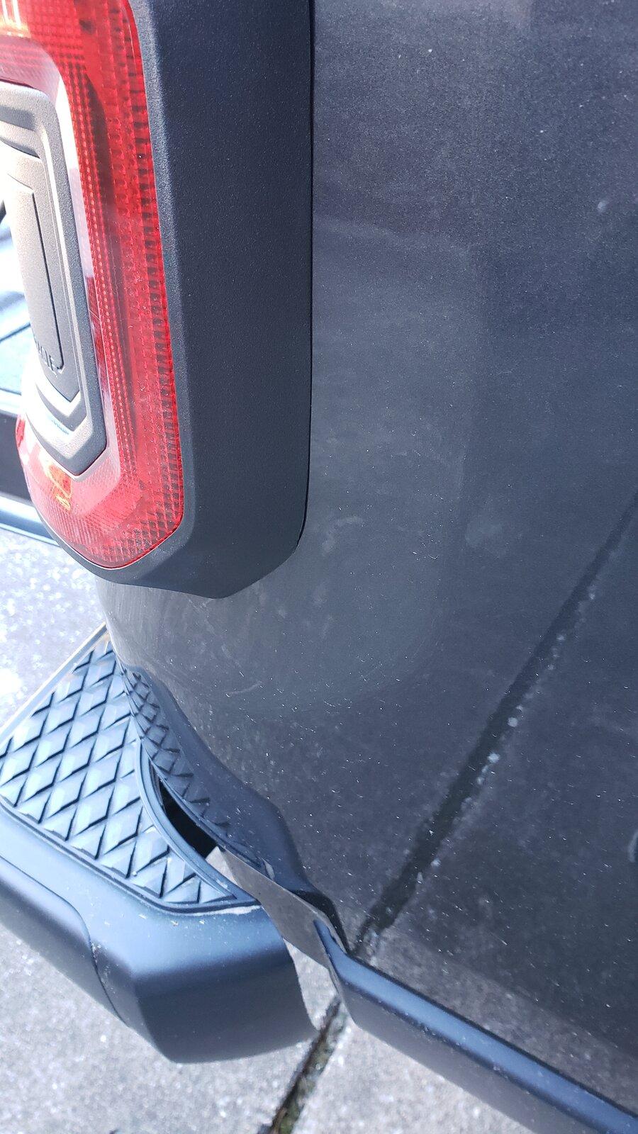

After installing mine, the passenger side had a big gap at the front bottom like everyone else complained about. To fix it just remove the light, take the heel of your hand and apply inward pressure on the sheet metal where the alignment pin holes are. This will bring the bottom of the housing closer to the body. I should have taken a before pic.
It's the driver side that has the issue.

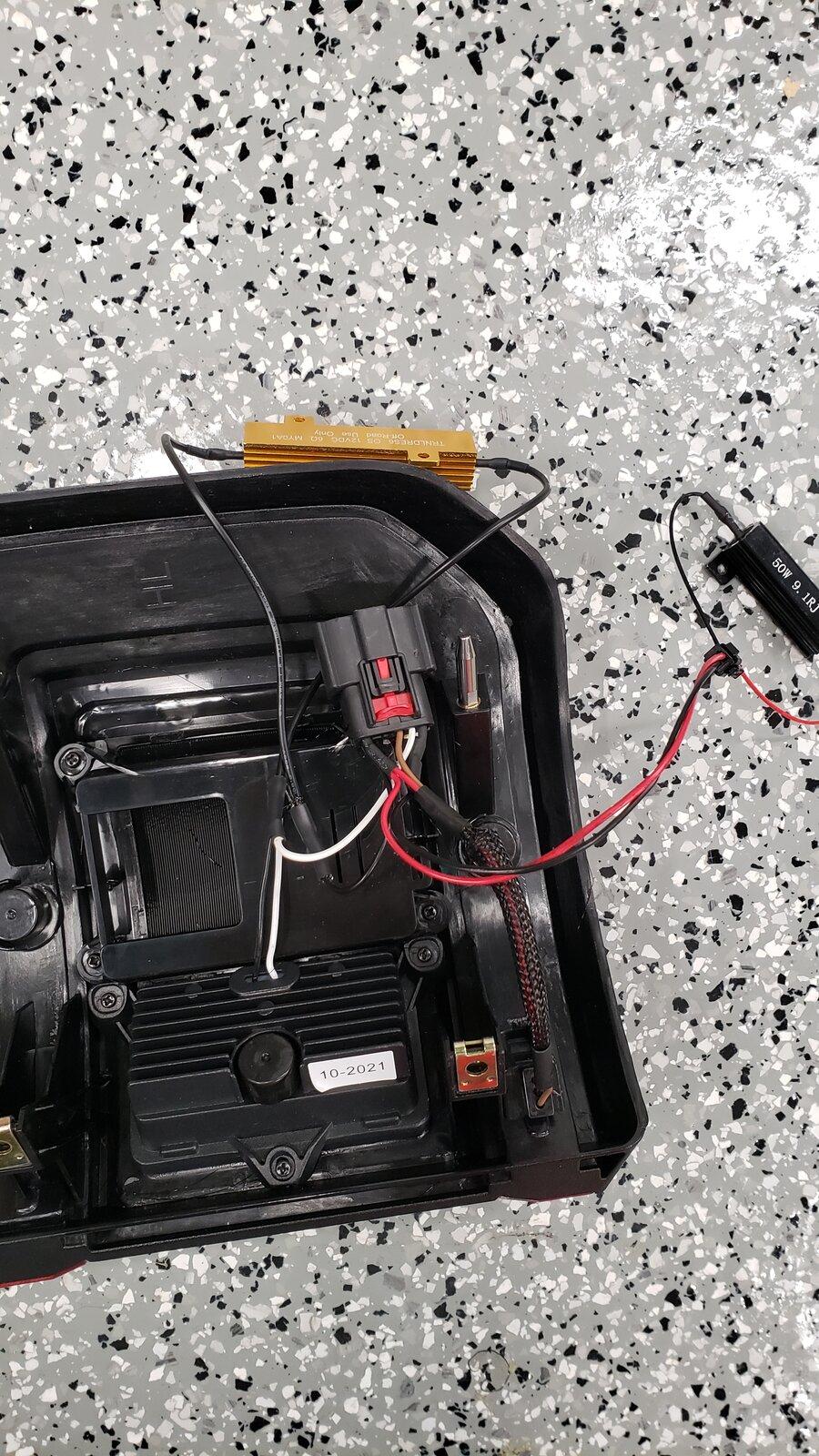

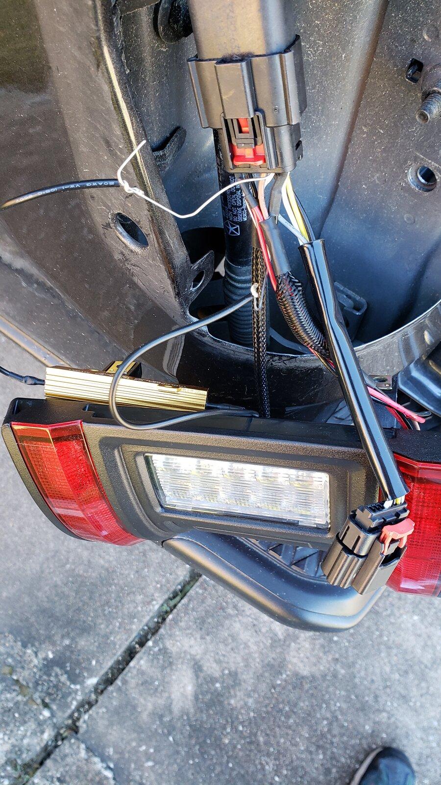

For those of you with inoperative back up when replacing halogen units lights there is a fix. You have to be comfortable doing custom wiring which i am. To test, I just rigged the wiring by back probing the connector. The circuit needs a load to stay on so get a couple resistors and wire them parallel to the reverse light wires. Ill take these apart and do a permanent repair next.

Hold that thought. L side reverse working and R side not. Stay tuned

Rechecked the wiring and all is good. There's no voltage going to the reverse light circuit on the passenger side. Going to let everything go to sleep and retest.
