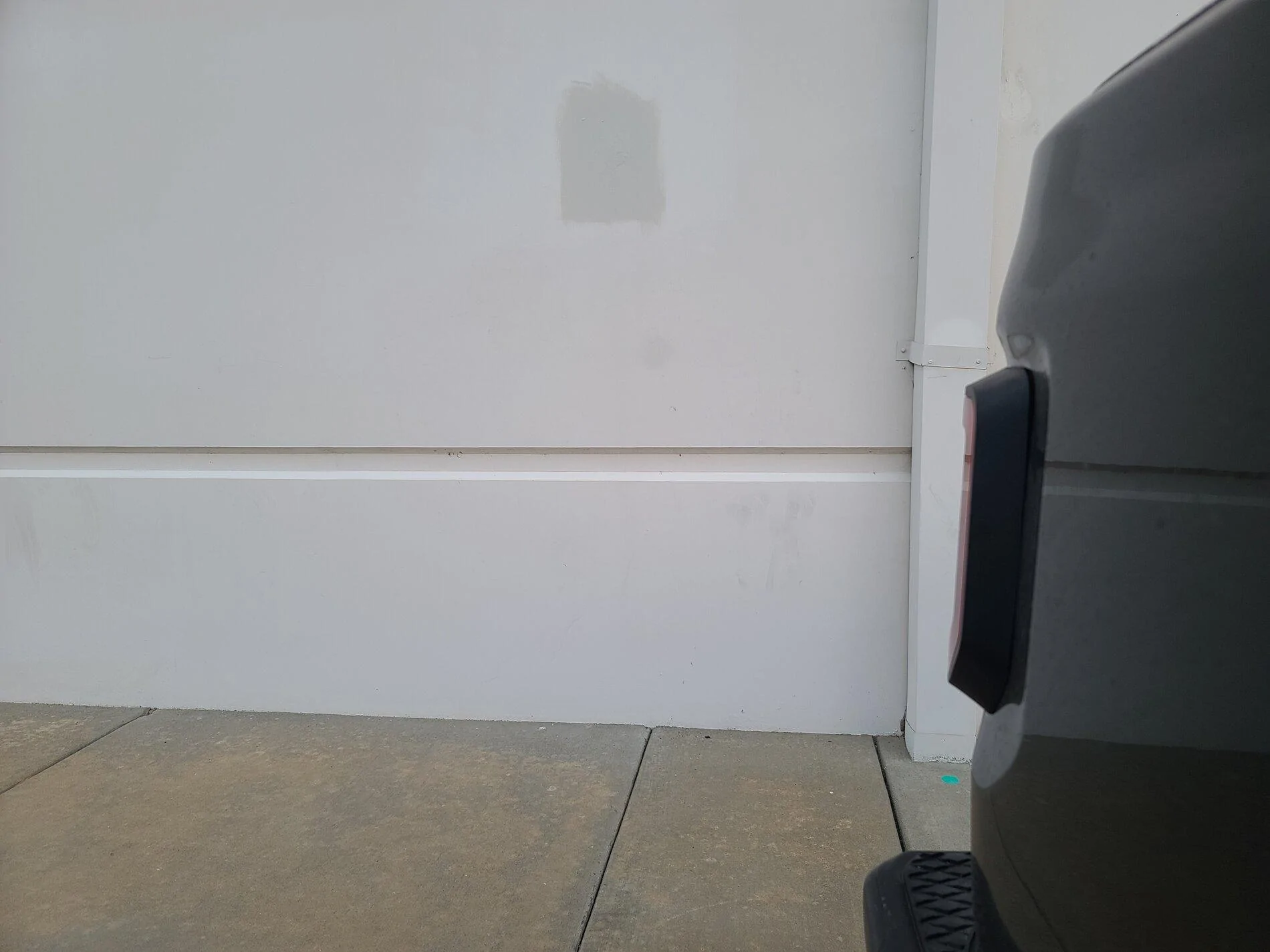

I can see from the pictures here that if you loosen each bolt, push & hold in, then re-tighten, you can make these gaps go away.
Looks like they need to be pushed upward & inward slightly to fit the body contour.
Yep just did that. Have very little gap now

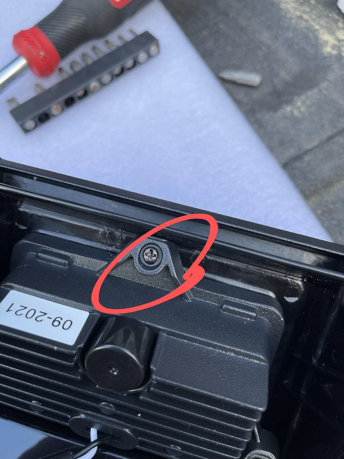

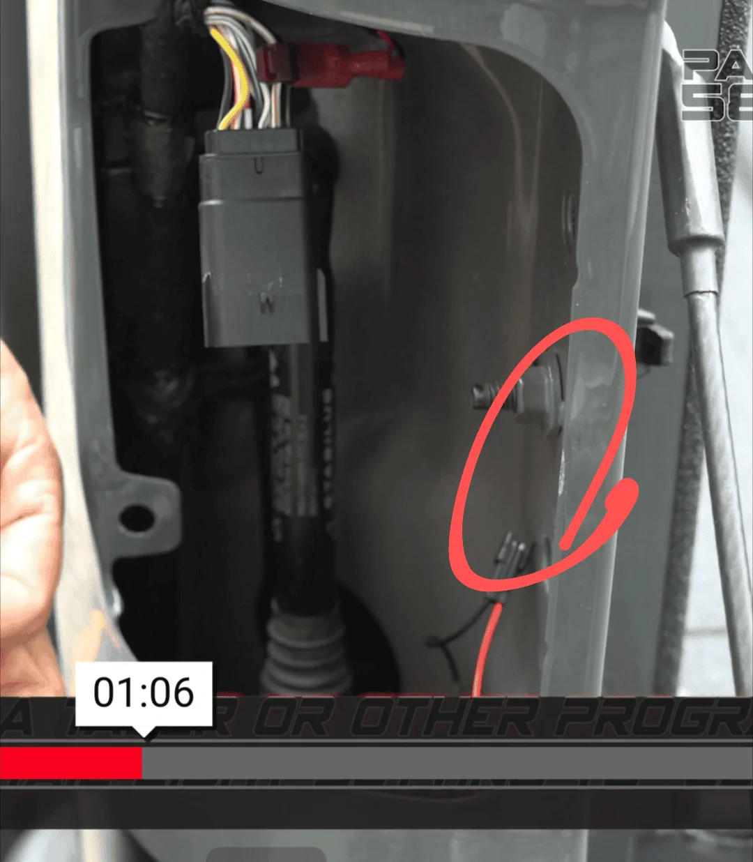

Check these posts. There is a small Phillips screw on the back of the Oracle housing that secures their backup light unit into their housing. And yes, this affects everyone's JT. I just gently bent in the sheet metal at the screw head location so it wouldn't rub.
https://www.jeepgladiatorforum.com/forum/threads/flush-mount-tail-lights.30902/post-812792
Did not affect mine. Didn’t touch it at all

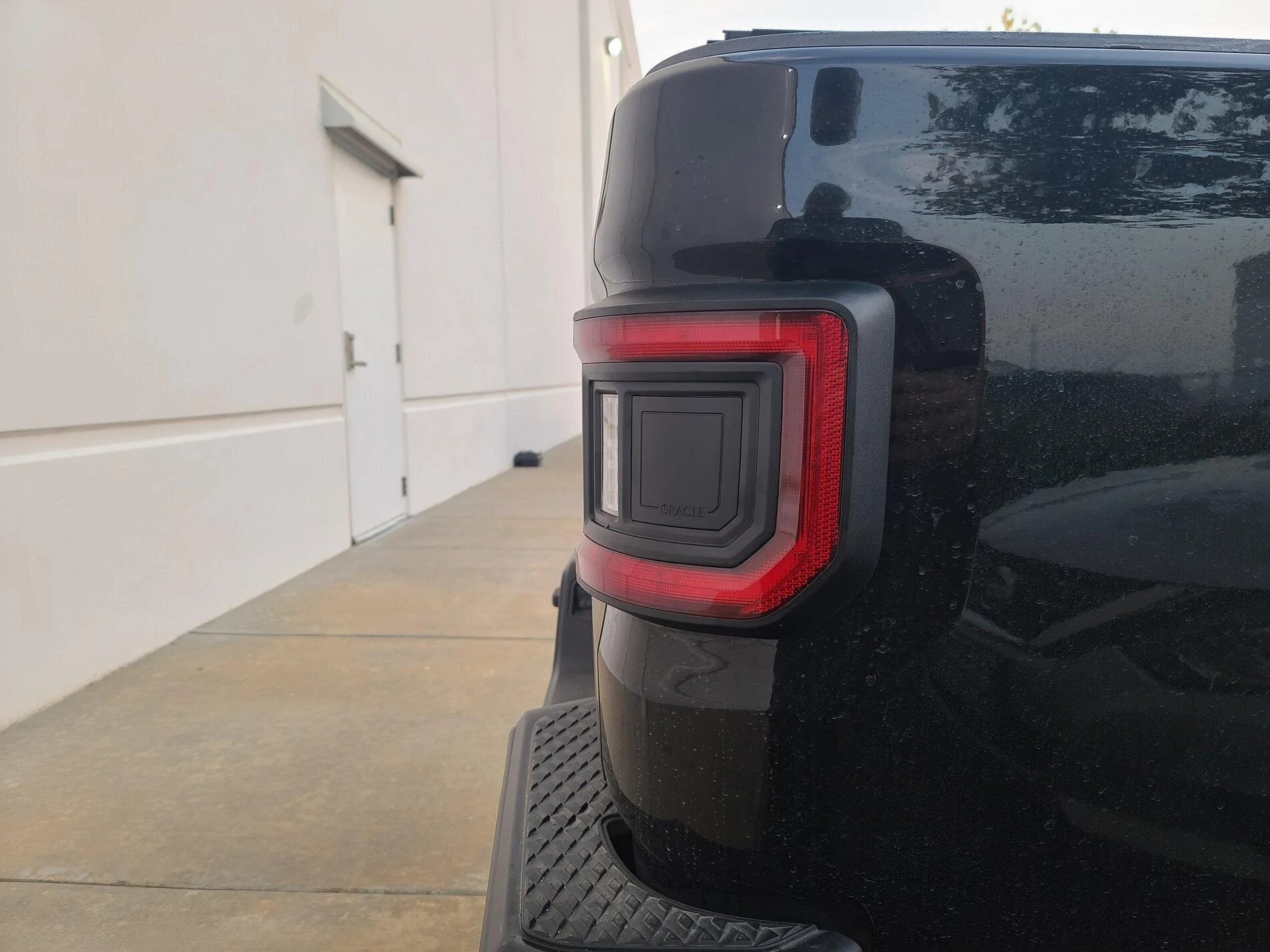

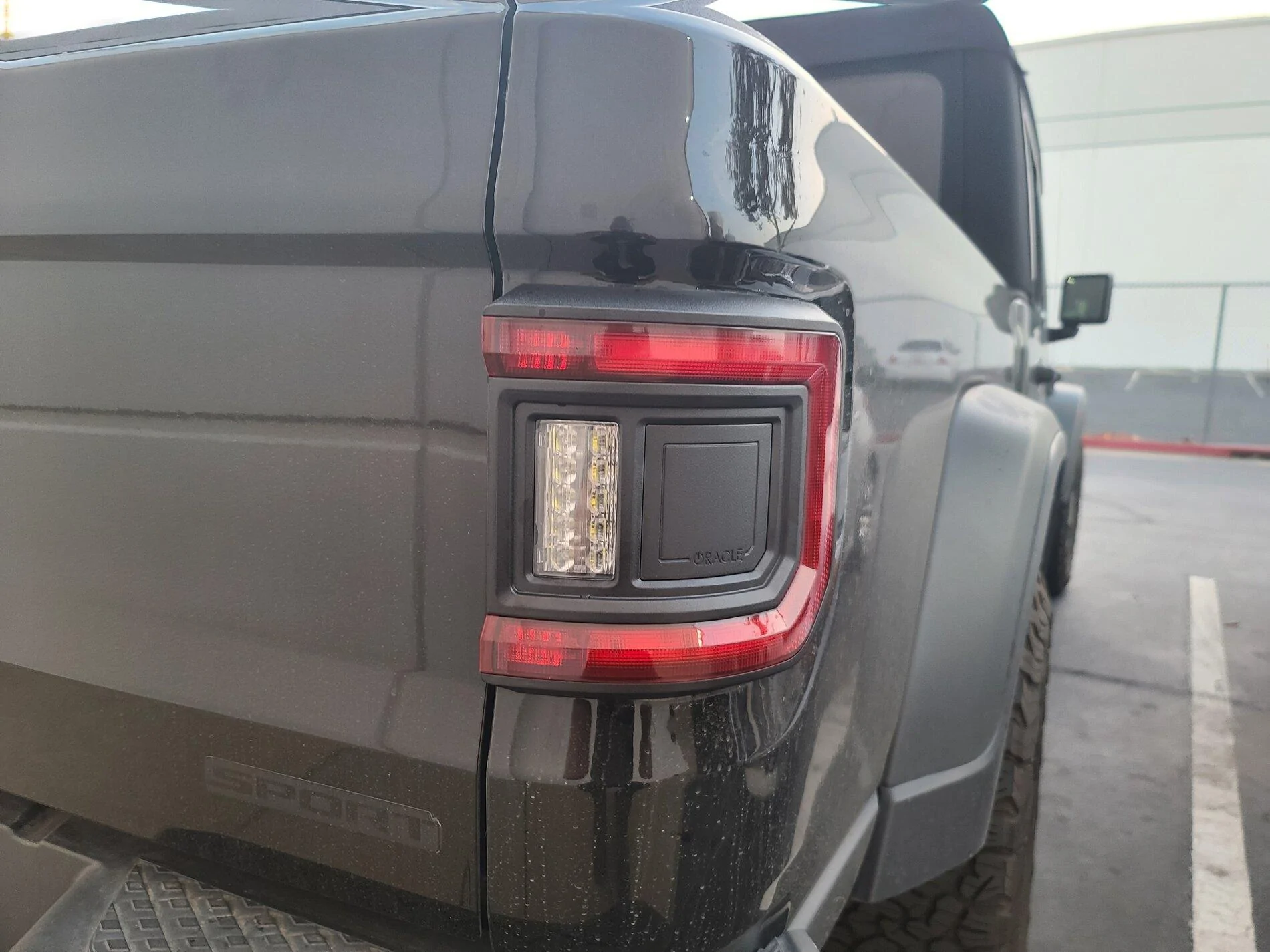

Fit and finish were as good as my factory tails. Wish there was an option for a reflector in the blank space for if you don't have BSM, but will see how reflective tape looks I guess.

Do what? I'm not picking on you because you have a very nice truck. But look at the gaps and molding on those Oracle lights. It's not even in the same league as the factory LED lights.
