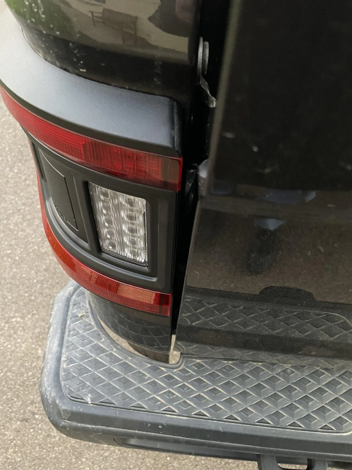

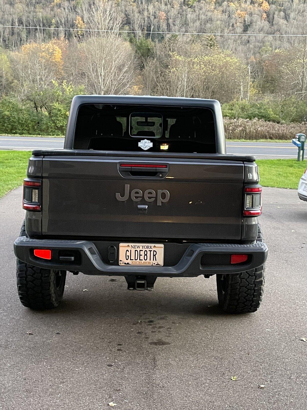

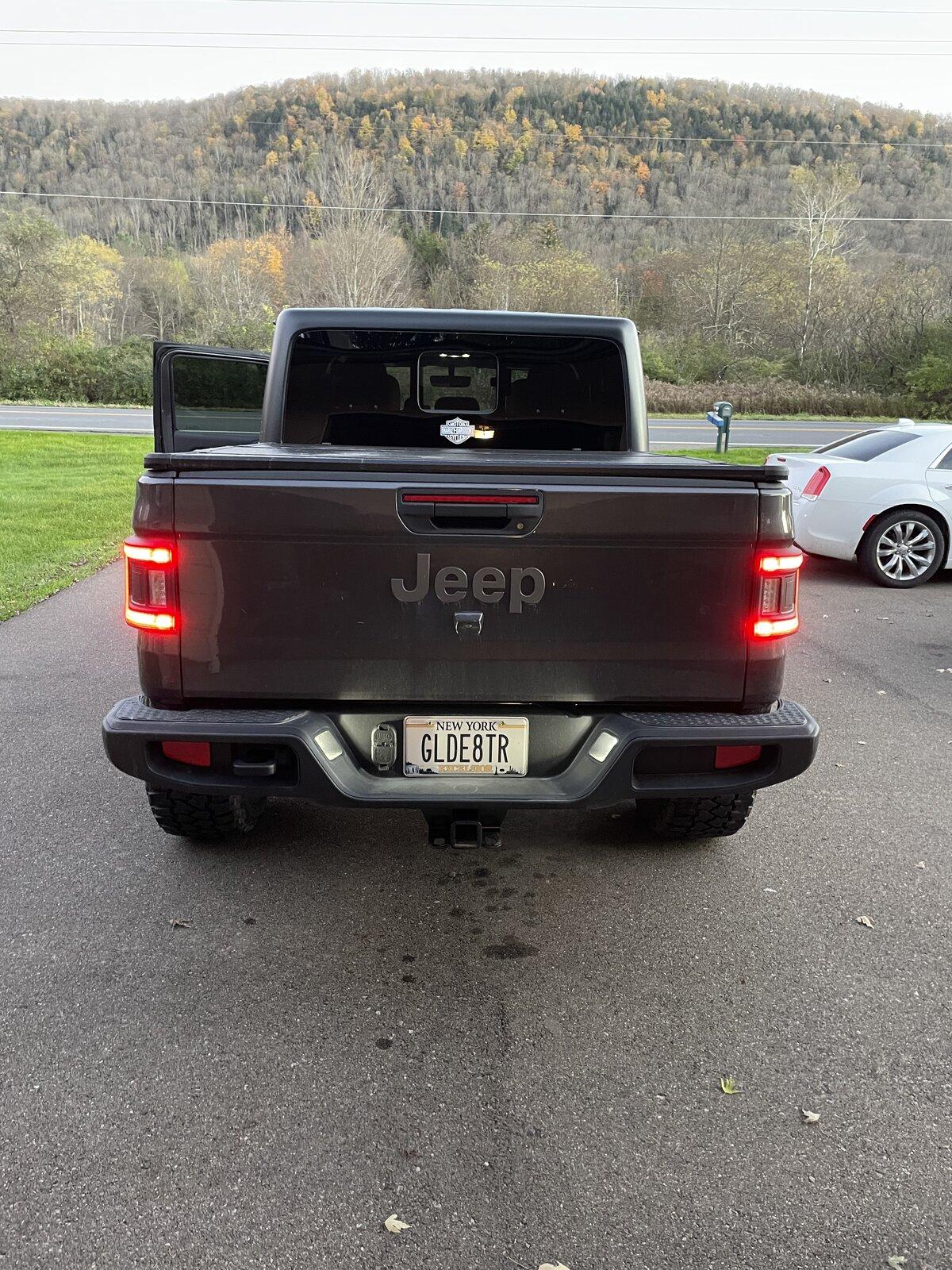

So I installed mine today. Had halogen lights but have a tazer. Lights work fine so far. No flickering. No messages about a bulb out. I thought the fitment was fine. Maybe a small gap on one side. As for a screw rubbing on them, there it’s no screw anywhere close to rubbing. Was an easy install. The only problem I had was I broke the red clip when I was plugging one of them in. I just taped it tight with electrical tape. Over all I’m very happy with them. They look great.
I can see from the pictures here that if you loosen each bolt, push & hold in, then re-tighten, you can make these gaps go away.
Looks like they need to be pushed upward & inward slightly to fit the body contour.

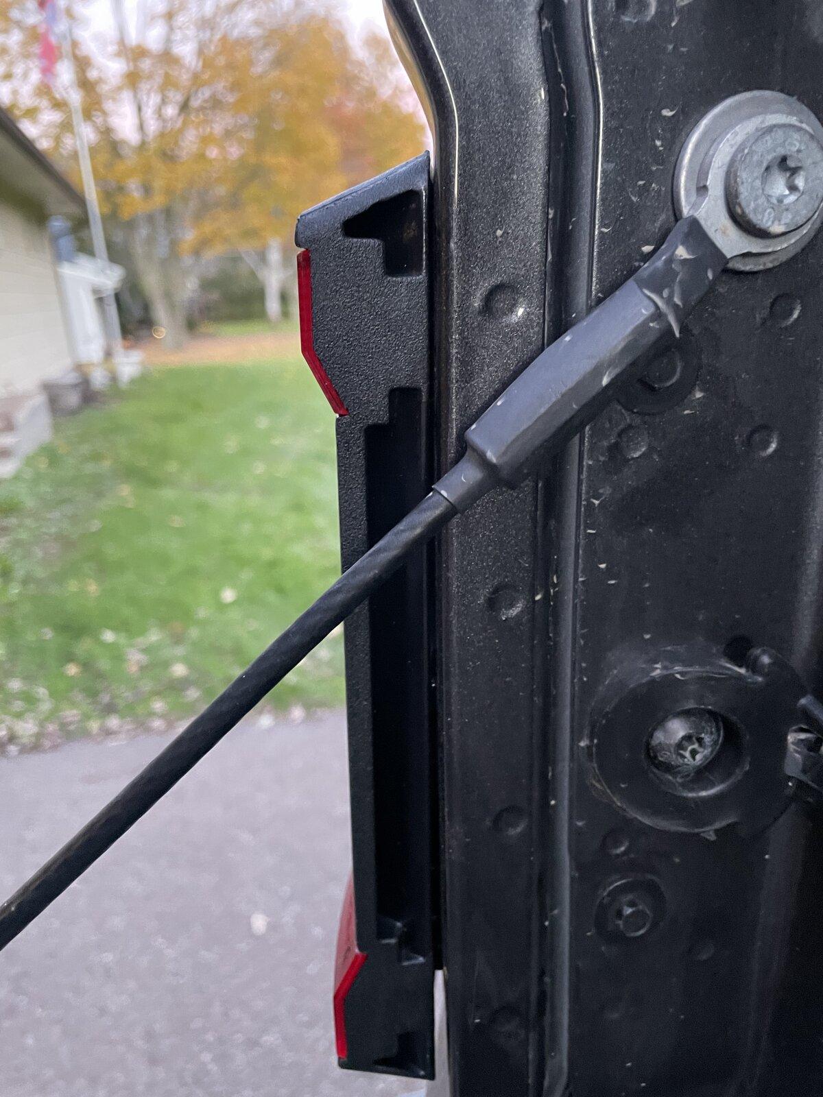

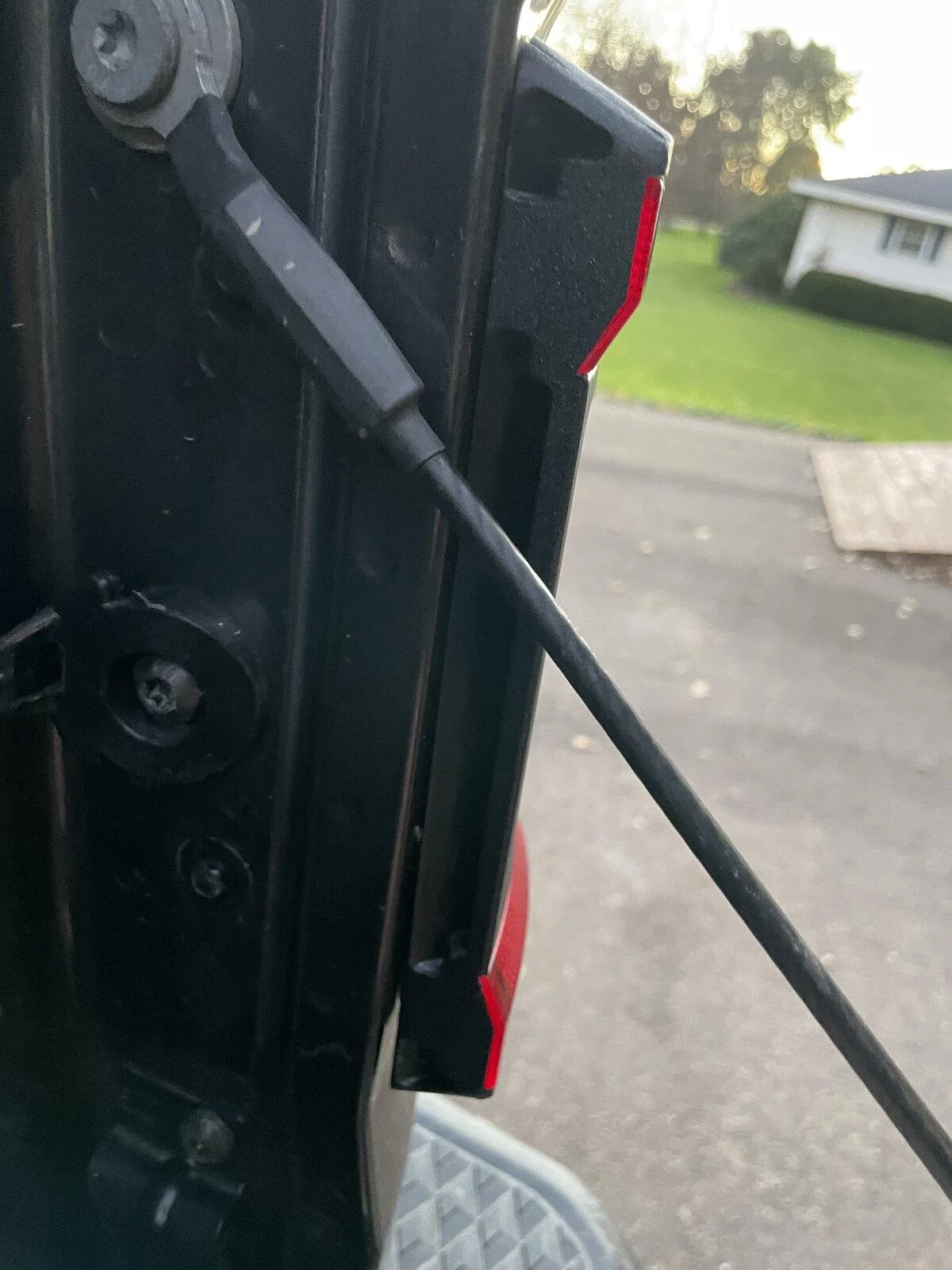

So, this screw that many say interferes with the fitment of the lights... it's the Torx screw that attaches the cable guide for the different tailgate positions, right? Has anyone tried replacing it with a shorter one?

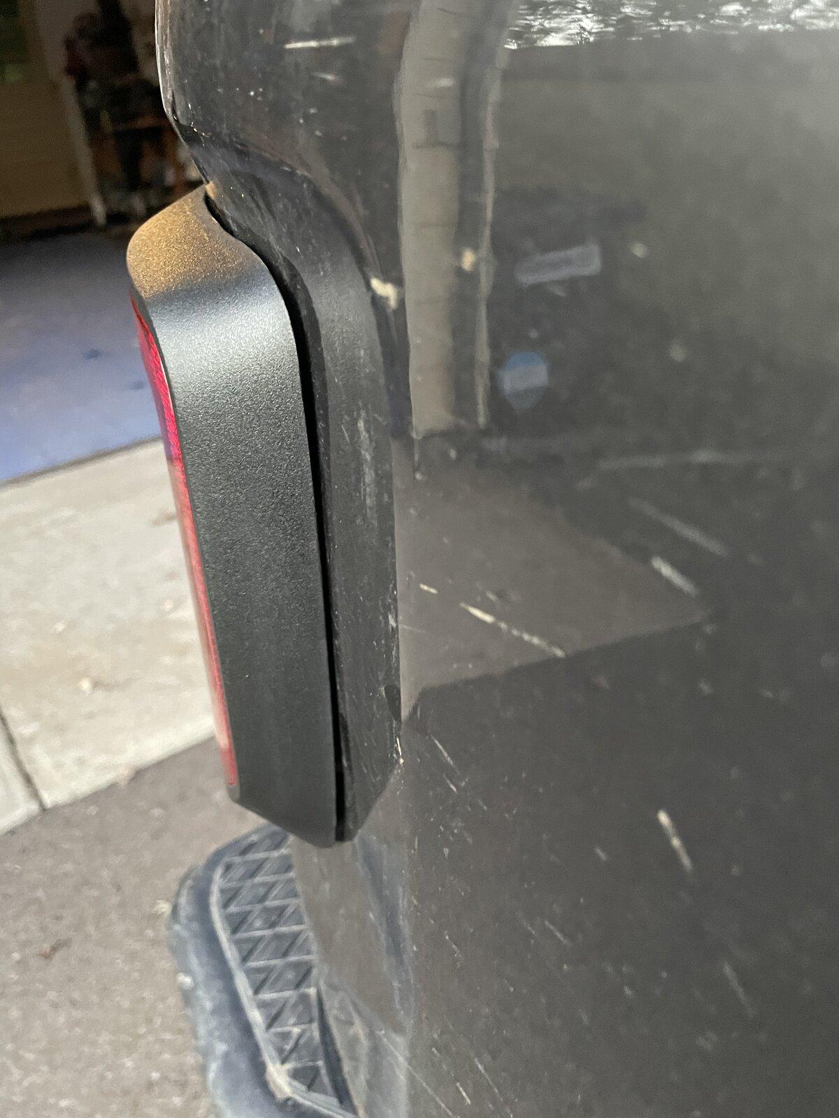

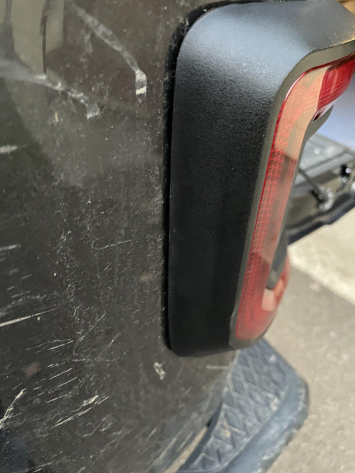

It's a screw head on the light that hits the sheet metal of the truck. It will take the paint off it you aren't careful installing it.
Check these posts. There is a small Phillips screw on the back of the Oracle housing that secures their backup light unit into their housing. And yes, this affects everyone's JT. I just gently bent in the sheet metal at the screw head location so it wouldn't rub.

Jeep Gladiator Flush Mount Tail Lights Screenshot_20211014-113956_2
Jeep Gladiator Flush Mount Tail Lights F08F1509-443F-42A8-A046-697858245B2D~2
https://www.jeepgladiatorforum.com/forum/threads/flush-mount-tail-lights.30902/post-812792
https://www.jeepgladiatorforum.com/forum/threads/flush-mount-tail-lights.30902/post-812809
Ohhh. I completely misread that every time it was referenced then. The circle helped, thanks.

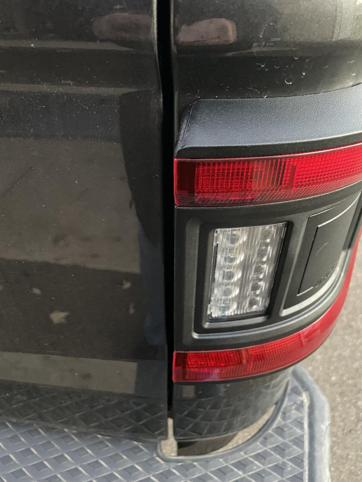

Yeah i tried that and seems to work on passenger side but wont set in on drivers side (like other users have found)
