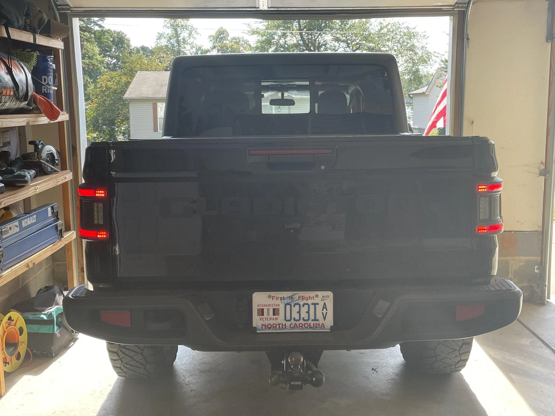

Mine showed up today,but in the same boat as most with halogen lights the reverse doesn't work properly
@Oracle Designs is there any other solution that doesn’t lead to me having to spend more money on this “plug and play” product? I’m all ears.

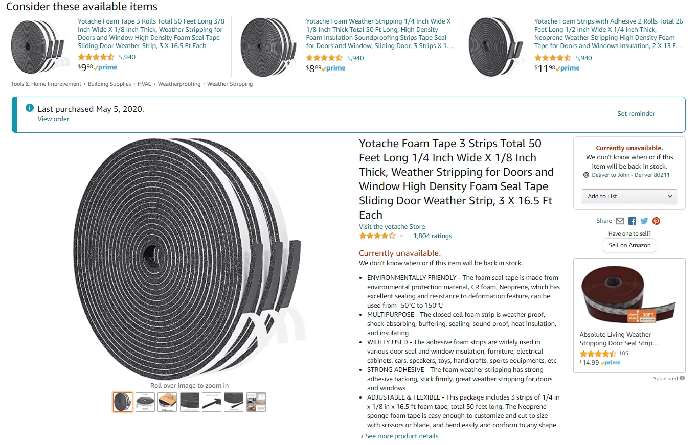

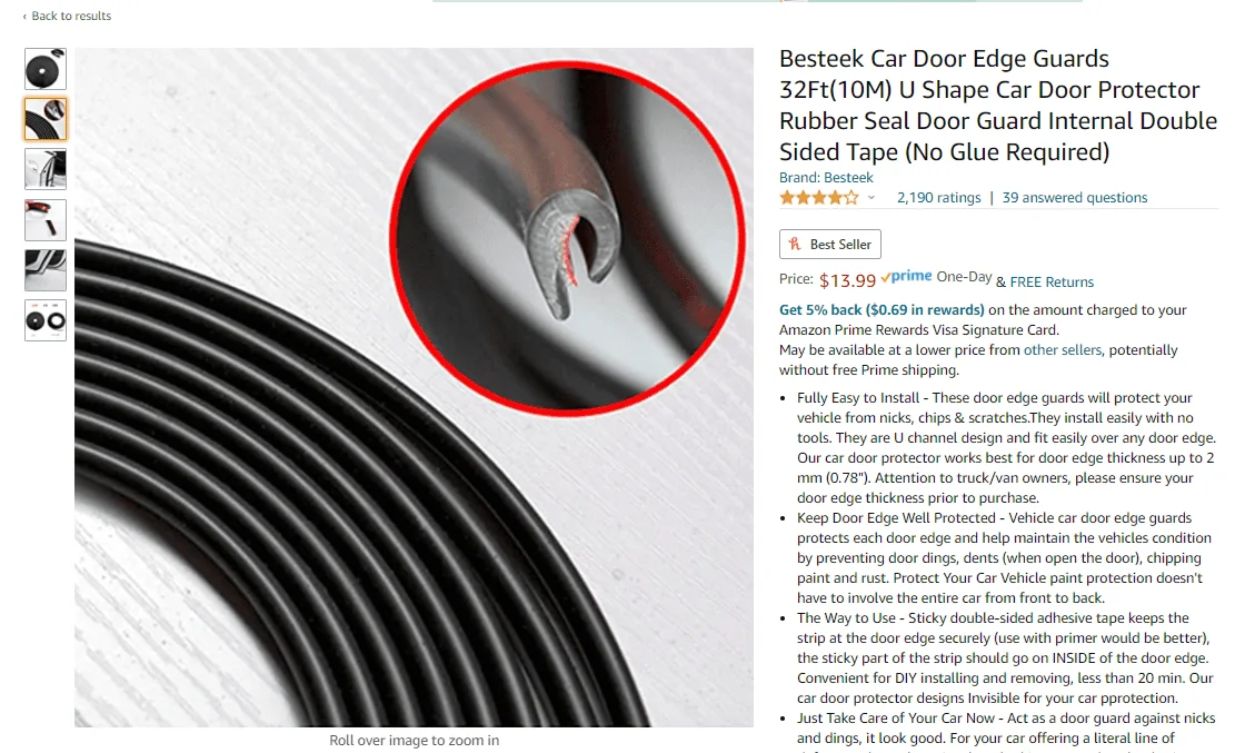

We’ve been receiving these for a few weeks now, really surprised someone hasn’t posted a link to where they got some rubber strip to attach to the housing to hide the imperfections and seal out the dirt and moisture.
If I had my Gladiator already I would have posted for others benefit, but here I sit with a bunch of accessories and no vehicle…
I've been following along here too... I don't have these lights but it seems that just a small self adhesive weather stripping like this would do the trick to fill the gap? I've used this stuff on plenty of other little projects with success. I would assume you simply stick this to the Jeep body and let the light press against it. Or some door edge guard around the edge of the tail light itself? Maybe?

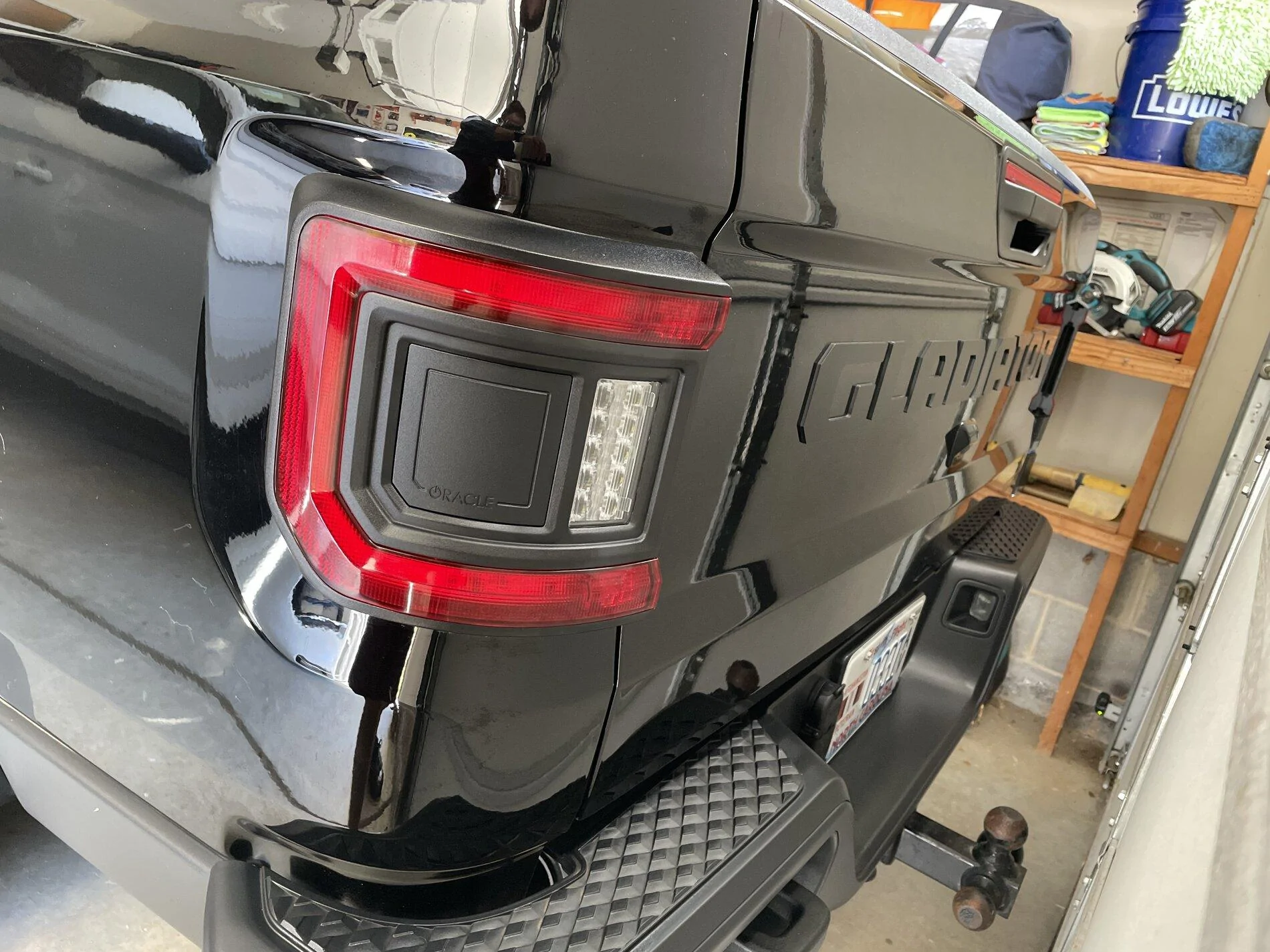

So I installed mine today. Had halogen lights but have a tazer. Lights work fine so far. No flickering. No messages about a bulb out. I thought the fitment was fine. Maybe a small gap on one side. As for a screw rubbing on them, there it’s no screw anywhere close to rubbing. Was an easy install. The only problem I had was I broke the red clip when I was plugging one of them in. I just taped it tight with electrical tape. Over all I’m very happy with them. They look great.
