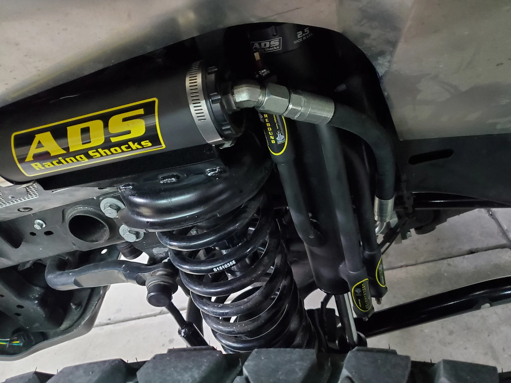

Some of the best shocks you can buy. 3 tube bypasses. Only drawback is $5k+ for a set of 4.

Not my photo, I'm still on the stock fox's that have been impressive for stock for sure. Nearing 50k miles and it's been run across the desert at 100mph, jumped a bit, hundreds of miles of washboard dirt, tower an 8400lb trailer 600 miles, loaded 1800lbs of pavers in the bed, etc. Hard use is my trucks whole life. The ADS bypasses are what is love to go to, but I'll likely end up going with a more moderate 2.5" reservoir shock like the rocksport blacks. Half the price is compelling.
Fox 2.5 and Carbon Racing are in the running for me. Still not cheap by any means but if I can get 75-100k out of em I’ll be more than impressed.
